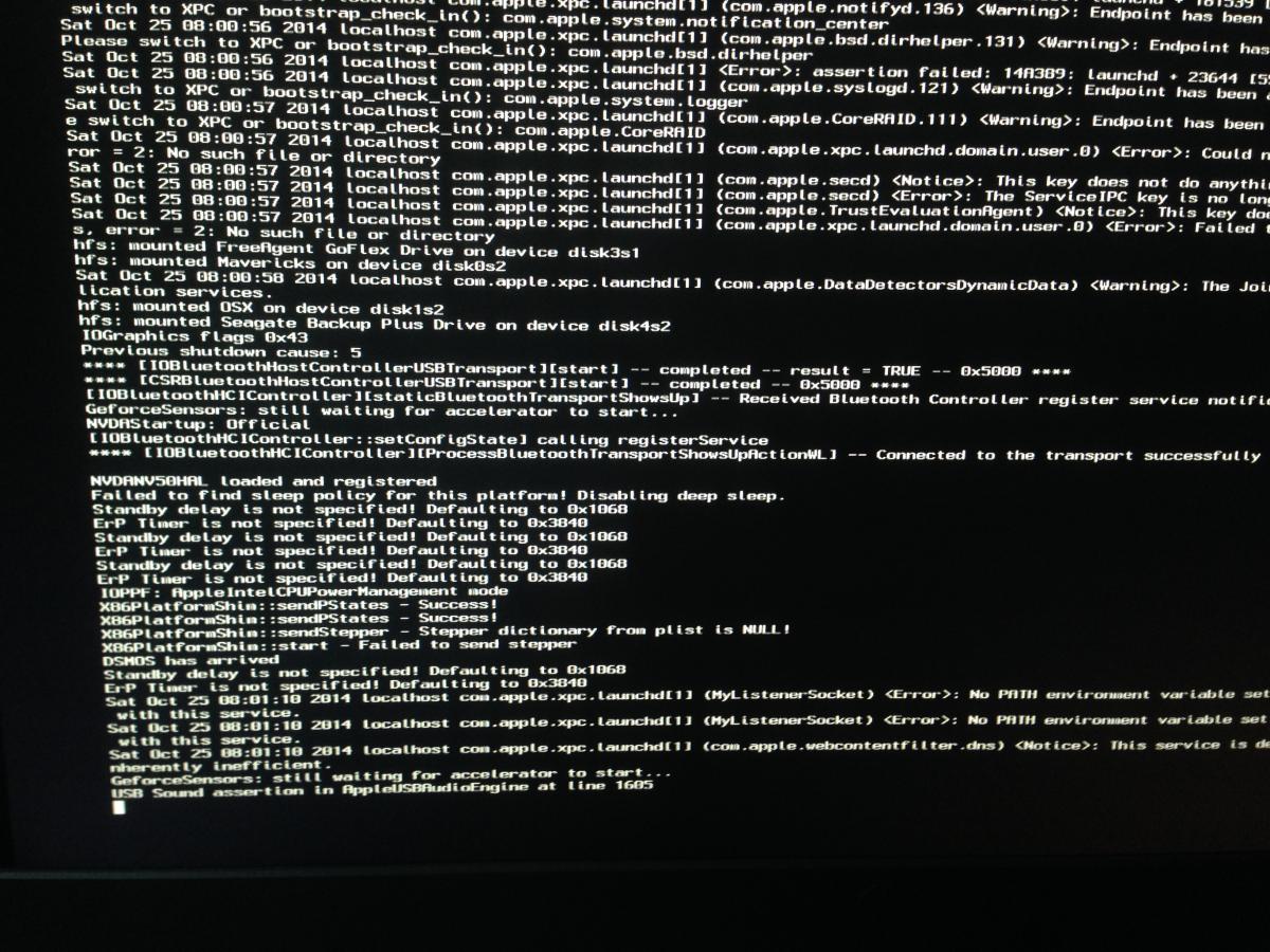

XanthraX Posted October 25, 2014 Share Posted October 25, 2014 Hi everyone, I have this mobo: GA-H61M-DS2; CPU: Intel Pentium G2030 Core 2 Duo, 2.99 GHz, 3M L2 cache, LGA 1155; GFX: Gigabyte Geforce 9400 GT, 512 M GDDR2 4 G DDR3 I made the installer with the last version of Clover_v2k_Special Edition (It works with Yosemite final if rename the installer with "Install Yosemite Beta". I have checked on the other Hackintosh based on the mobo GA-Gigabyte GA-B75M-D3H and it works. But here, it restarts the installer at the line showed in attachment. Please illuminate me what can I do? Link to comment https://www.insanelymac.com/forum/topic/301968-h61m-ds2-and-clover-reboots-without-kp/ Share on other sites More sharing options...

XanthraX Posted October 25, 2014 Author Share Posted October 25, 2014 I have only FakeSMC in EFI/Clover/kexts/10.10, tried kext-dev-mode=1, same result. I also have generated C and P States. I think it is something about the graphic card, it reboots at "GeForce Sensors: still waiting for accelerator to start..." Link to comment https://www.insanelymac.com/forum/topic/301968-h61m-ds2-and-clover-reboots-without-kp/#findComment-2076003 Share on other sites More sharing options...
Allan Posted October 25, 2014 Share Posted October 25, 2014 Remove the GeForce Sensors plugin inside FakeSMC. Link to comment https://www.insanelymac.com/forum/topic/301968-h61m-ds2-and-clover-reboots-without-kp/#findComment-2076022 Share on other sites More sharing options...

XanthraX Posted October 25, 2014 Author Share Posted October 25, 2014 Sorry for that. Removed GPU sensors from the FakeSMC.kext but it still rebooted, I tried -f GraphicEnabler=Yes the same results. I think I have to get a new GFX. config.plist.zip Link to comment https://www.insanelymac.com/forum/topic/301968-h61m-ds2-and-clover-reboots-without-kp/#findComment-2076046 Share on other sites More sharing options...

Allan Posted October 26, 2014 Share Posted October 26, 2014 Sorry for that. Removed GPU sensors from the FakeSMC.kext but it still rebooted, I tried -f GraphicEnabler=Yes the same results. I think I have to get a new GFX. Once you edit FakeSMC is necessary repair the disk permissions and rebuild the cache. Use KextWizard app for this. Link to comment https://www.insanelymac.com/forum/topic/301968-h61m-ds2-and-clover-reboots-without-kp/#findComment-2076266 Share on other sites More sharing options...
XanthraX Posted October 26, 2014 Author Share Posted October 26, 2014 Kext Wizard not installs kexts in Clover. Link to comment https://www.insanelymac.com/forum/topic/301968-h61m-ds2-and-clover-reboots-without-kp/#findComment-2076295 Share on other sites More sharing options...
Allan Posted October 26, 2014 Share Posted October 26, 2014 It's just for repair disk permissions dude. Link to comment https://www.insanelymac.com/forum/topic/301968-h61m-ds2-and-clover-reboots-without-kp/#findComment-2076296 Share on other sites More sharing options...
XanthraX Posted October 26, 2014 Author Share Posted October 26, 2014 Thank you. It worked. But I got orange HDD icons. If I try to modify SMBios to MacMini 4.1 how I have it declared before, it no longer boots into syste, no hdd activity and I get the forbidden sign. Link to comment https://www.insanelymac.com/forum/topic/301968-h61m-ds2-and-clover-reboots-without-kp/#findComment-2076364 Share on other sites More sharing options...
