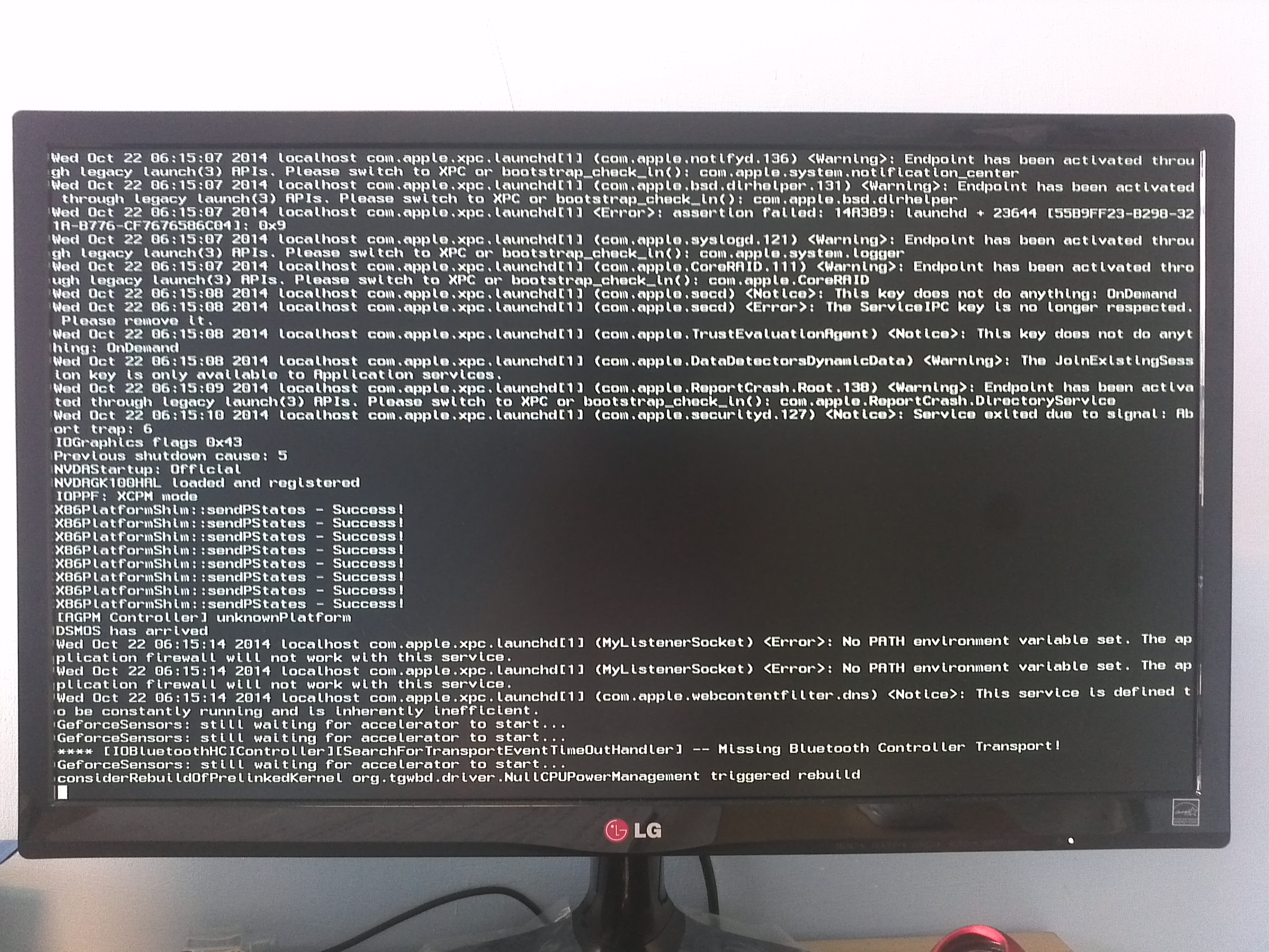

yummypixza Posted October 21, 2014 Share Posted October 21, 2014 Hi, I'm just new to touch Hackintosh, and I can't get into installer. I made a bootable usb from official app and installed clover r2957 from the pinned thread. injected kext: FakeCSM NullCPUPowerManagement BIOS set as dual-boot (UEFI / Legacy BIOS), CSM set to other OS (as disable secure boot) both UEFI and BIOS can get me into clover and can boot installer, but both are stuck at gray background and spinning beachball. tried add kext-dev-mode=1 -f -v -x GraphicsEnabler=No npci=0x2000 or any combinations from these, still stucked verbose showed it would hang after four times of "geforce sensors: still waiting for accelerator to start" another message is "missing bluetooth controller transport", just appear one time in each boot any idea? spec: ASUS H97M-PLUS Intel Xeon E3 1231 v3 ASUS GTX760-DC2OC, HDMI output 1080P 8GB DDR3 1600 RAM x2 (16GB) Intel SSD 530 240GB (Win8.1), WD Red 2TB (install target) Link to comment https://www.insanelymac.com/forum/topic/301782-asus-h97m-plus-gtx-760-keep-stuck-on-geforcesensor/ Share on other sites More sharing options...
yummypixza Posted October 22, 2014 Author Share Posted October 22, 2014 first one used kext-dev-mode=1 -v -x second one used same except -x both are boot from UEFI. Link to comment https://www.insanelymac.com/forum/topic/301782-asus-h97m-plus-gtx-760-keep-stuck-on-geforcesensor/#findComment-2073652 Share on other sites More sharing options...

Rampage Dev Posted November 20, 2014 Share Posted November 20, 2014 It is hung on the GPU. Nothing more. You need to use the Nvidia Disabler Flag to boot in. Post install you can install the Retail Drivers from Nvidia. Are you using my Install Guide? Link to comment https://www.insanelymac.com/forum/topic/301782-asus-h97m-plus-gtx-760-keep-stuck-on-geforcesensor/#findComment-2087550 Share on other sites More sharing options...
