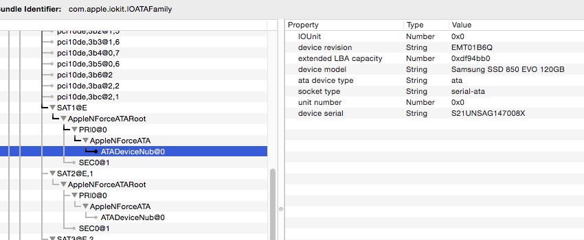

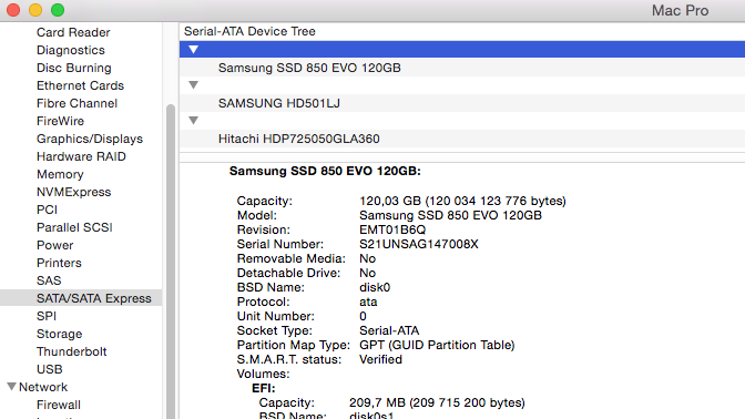

Yura Besaga Posted May 25, 2015 Share Posted May 25, 2015 1. My system does not recognize the SSD (Samsung 850 EVO 120G) thinks it in the usual HDD, respectively TRIM does not work because TRIM is enabled after patch IOAHCIFamily.kext and I have it running through AppleNForceATA.imk64bit.kext) Can I fix it? 2. I read somewhere that OSX works differently on the SSD (cashes, swapfile ....) Does anyone know how it differently and what that means? 3. Furthermore, the MOBOs using one of these nForce chipsets usually have the BIOS option to set the enable nForce SATA Controller and require SATA RAID to be Enabled (implicitly enabling AHCI mode) even when not running a RAID system how to check the AHCI working or not? - Asus Striker II Formula (nForce 780i SLI) ACPI BIOS Revision 2402 - Intel Dual-Core E6700- Samsung SSD 850 EVO 120GBYosemite 10.10.3- Clover r3202- DSDT- FakeSMC.kext- AppleNForceATA.imk64bit.kext Link to comment https://www.insanelymac.com/forum/topic/301635-nforce-os-x-yosemite-1010-app-store-download-install-guide-on-a-series-6-or-7-nforce-chipset-intel-cpu-mobo/page/3/#findComment-2138482 Share on other sites More sharing options...
verdant Posted May 25, 2015 Author Share Posted May 25, 2015 @ Yura Besaga 3. Check your 780i BIOS settings against: Series7_nForce_Chipset_BIOS_SettingsV2.pdf 2. I do not have a SDD installed on my nForce MOBO.......but see here..... 1. See here for running SSD on nForce chipset MOBO...... 1 Link to comment https://www.insanelymac.com/forum/topic/301635-nforce-os-x-yosemite-1010-app-store-download-install-guide-on-a-series-6-or-7-nforce-chipset-intel-cpu-mobo/page/3/#findComment-2138505 Share on other sites More sharing options...
Yura Besaga Posted May 25, 2015 Share Posted May 25, 2015 3. Check your 780i BIOS settings against: Series7_nForce_Chipset_BIOS_SettingsV2.pdf 3. I can not understand why need to Disabled - (Enhanced C1) C1E Enhanced Halt State - Virtualization Technology - (Enhanced) Intel SpeedStep 2. I do not have a SDD installed on my nForce MOBO.......but see here..... 1. See here for running SSD on nForce chipset MOBO...... 2. This program makes the same patch IOAHCIFamily.kext and I have it running through AppleNForceATA.imk64bit.kext Displays in the System Report empty as I think, should be "Generic AHCI Controller" and "Vendor: Generic" Link to comment https://www.insanelymac.com/forum/topic/301635-nforce-os-x-yosemite-1010-app-store-download-install-guide-on-a-series-6-or-7-nforce-chipset-intel-cpu-mobo/page/3/#findComment-2138622 Share on other sites More sharing options...
verdant Posted May 25, 2015 Author Share Posted May 25, 2015 @ Yura Besaga 3. They are set at DISABLED for initial OS X setup but if your DSDT.aml is already modified to enable OS X natural power management and you have removed NullCPUPowerManagement.kext from /System/Library/Extensions/ (and/or from /Extra/Extensions/ if you are using the Chameleon kernel patch option), then you can set: Enhanced C1 (C1E) [ENABLED]Enhanced Intel Speedstep Technology [ENABLED]HPET Support [ENABLED] 2. That is why I suggest using the SATA PCIe card for running your SSD. 1 Link to comment https://www.insanelymac.com/forum/topic/301635-nforce-os-x-yosemite-1010-app-store-download-install-guide-on-a-series-6-or-7-nforce-chipset-intel-cpu-mobo/page/3/#findComment-2138653 Share on other sites More sharing options...

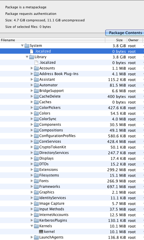

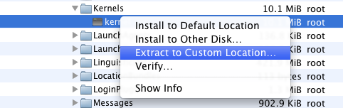

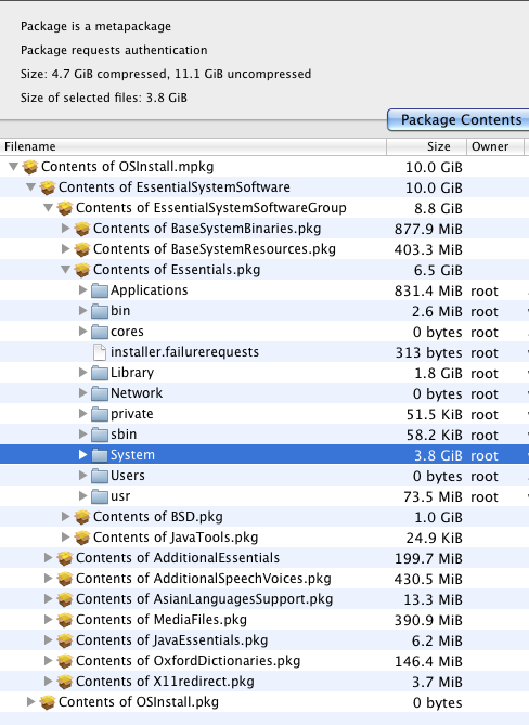

GaryThePCGuy Posted January 26, 2016 Share Posted January 26, 2016 could you clarify this? where am i looking for the "kernel"? N.B.2. The kernel file is no longer called 'mach_kernel' but simply 'kernel'; nor is it located in the BaseSystemBinaries.pkg anymore. It now has to be extracted using Pacifist from the Contents of Essential.pkg (which is within the Contents of EssentialSystemSoftwareGroup package folder, which itself is within the Contents of EssentialSystemSoftware package folder), where it resides in System/Library/Kernels. Link to comment https://www.insanelymac.com/forum/topic/301635-nforce-os-x-yosemite-1010-app-store-download-install-guide-on-a-series-6-or-7-nforce-chipset-intel-cpu-mobo/page/3/#findComment-2210390 Share on other sites More sharing options...
verdant Posted January 26, 2016 Author Share Posted January 26, 2016 You have to use Pacifist to open up InstallESD.dmg from: Install OS X Yosemite.app and right-click to Show Package Contents: The use Pacifist Open Package option to view InstallESD.dmg disk image contents: and within the System folder: and extract kernel: to Custom Location i.e. your USB drive as per my Install Guide: [8] Go to /System/Library of the OS X Base System volume, and in the Library directory, create a new folder called Kernels. Use Pacifist (current version is Pacifist 3.2.17) to extract the kernel file to the newly created Kernels directory, i.e. /System/Library/Kernels of the OS X Base System USB flash drive volume. Link to comment https://www.insanelymac.com/forum/topic/301635-nforce-os-x-yosemite-1010-app-store-download-install-guide-on-a-series-6-or-7-nforce-chipset-intel-cpu-mobo/page/3/#findComment-2210430 Share on other sites More sharing options...
GaryThePCGuy Posted January 26, 2016 Share Posted January 26, 2016 gotcha! that makes a ton more sense. Thanks! Link to comment https://www.insanelymac.com/forum/topic/301635-nforce-os-x-yosemite-1010-app-store-download-install-guide-on-a-series-6-or-7-nforce-chipset-intel-cpu-mobo/page/3/#findComment-2210698 Share on other sites More sharing options...
