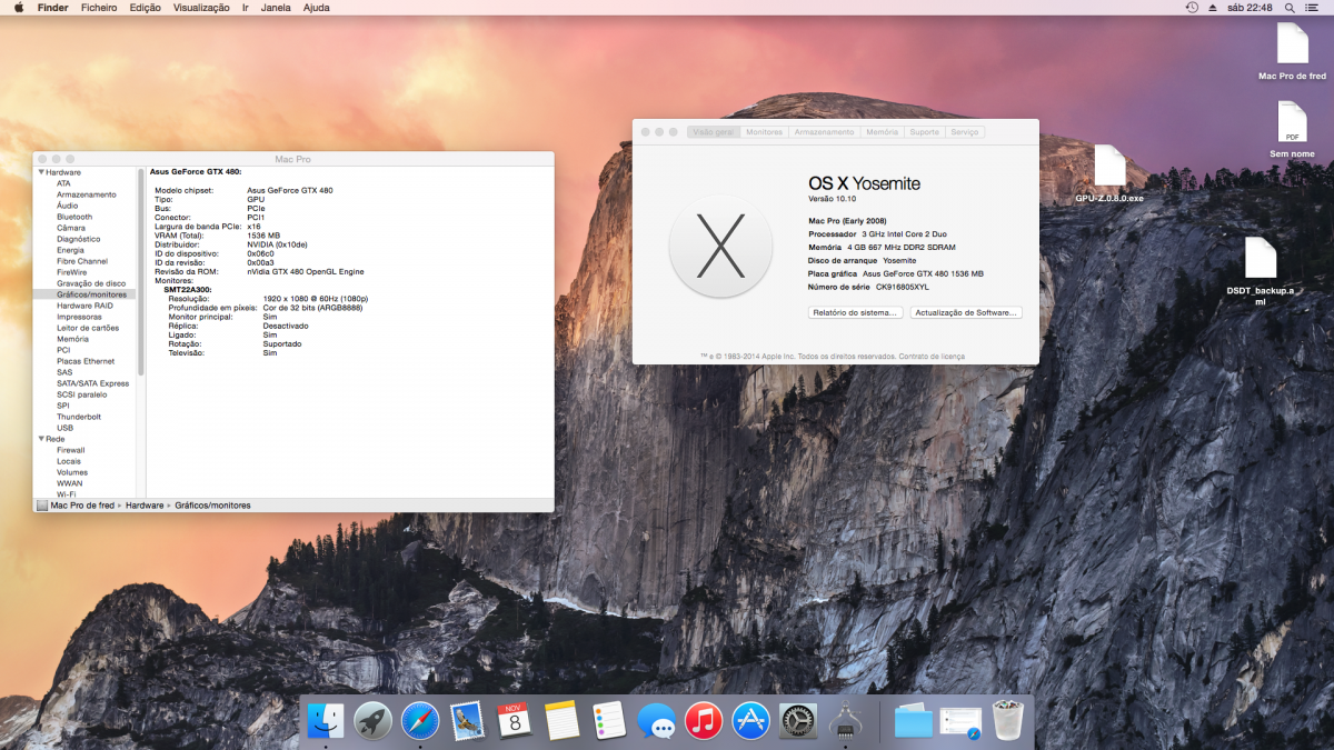

Fred Coelho Posted November 7, 2014 Share Posted November 7, 2014 Hello! Once again here I am to ask you something, already in Yosemite! I've followed your tutorial, smooth as the previous one to Mavericks! Only had an issue, the nForcelan.kext and the VoodooHDA.kext, for some reason, were not loading on the startup! Nothing that Kext Utility (and not Kext Wizard, that didn't fix it) didn't solve! Now, a new issue: i've got an Asus GTX 480 graphics card and, since I'm using your DSDT, it shows up the 9800 GT that you probably use. Is it possible for me to change this and, then, to be able to change screen resolution and try better graphics games? Or is it "hardcoded" into your DSDT, making it unchangeable? Thank you, verdant, as usual, amazing tutorials and amazing support! Link to comment https://www.insanelymac.com/forum/topic/301635-nforce-os-x-yosemite-1010-app-store-download-install-guide-on-a-series-6-or-7-nforce-chipset-intel-cpu-mobo/#findComment-2082547 Share on other sites More sharing options...
verdant Posted November 8, 2014 Author Share Posted November 8, 2014 Hi Fred, Glad the guide worked well for you...... What is the video RAM (VRAM) of your Asus GTX 480 graphics card? Install and run IORegistryExplorer (Google is your friend) and use "Save a Copy As" to save your IOReg output as a "Username"Mac Pro.ioreg file, and let me know what version of IORegistryExplorer you used. Post it for me to download. Also, If you are dual booting with Windows, then use GPU-Z to extract your graphics card ROM file and post it here.....this way I can check its NVCAP string..... Then I wil modify the DSDT.aml file for you and explain what I changed..... Link to comment https://www.insanelymac.com/forum/topic/301635-nforce-os-x-yosemite-1010-app-store-download-install-guide-on-a-series-6-or-7-nforce-chipset-intel-cpu-mobo/#findComment-2082643 Share on other sites More sharing options...
Fred Coelho Posted November 8, 2014 Share Posted November 8, 2014 Hi, verdant! Here it goes...and thank you so much for such help and teaching! You could start an 1-800-verdant support hotline... GTX480.zip Link to comment https://www.insanelymac.com/forum/topic/301635-nforce-os-x-yosemite-1010-app-store-download-install-guide-on-a-series-6-or-7-nforce-chipset-intel-cpu-mobo/#findComment-2082744 Share on other sites More sharing options...
verdant Posted November 8, 2014 Author Share Posted November 8, 2014 Hi Fred, Here is a modified P5N32-E SLI Plus DSDT.aml for you to try: P5N32E DSDT -FCoelho.zip Your IOReg file show that your graphics card was operating in VESA mode, with its NVRAM and NVCAP data not being picked up from the DSDT.aml file as my 9800 GT data and your GTX 480 data are different.... From your GPU-Z VRAM info: Data Value -------- VRAM (MB) ---------- String Value (Hexadecimal) <00000060>-----------1536 (1.5 GB)-------<0x60000000> (the hexadecimal string is written reverse order within DSDT) and ROM NVCAP info: 0400000000000300000000000000000700000000 my DSDT.aml file has been modified for you as follows: "NVCAP",Buffer (0x18){/* 0000 */ 0x04, 0x00, 0x00, 0x00, 0x00, 0x00, 0x03, 0x00,/* 0008 */ 0x00, 0x00, 0x00, 0x00, 0x00, 0x00, 0x00, 0x07,/* 0010 */ 0x00, 0x00, 0x00, 0x00}, "VRAM,totalsize",Buffer (0x04){0x00, 0x00, 0x00, 0x60}, "model",Buffer (0x10){ “Asus GeForce GTX 480"}, "rom-revision",Buffer (0x1D){ "nVidia GTX 480 OpenGL Engine"}, Let me know if it works.......and in any event, please send me a new IOReg file generated using the attached DSDT.aml file...... Link to comment https://www.insanelymac.com/forum/topic/301635-nforce-os-x-yosemite-1010-app-store-download-install-guide-on-a-series-6-or-7-nforce-chipset-intel-cpu-mobo/#findComment-2082759 Share on other sites More sharing options...

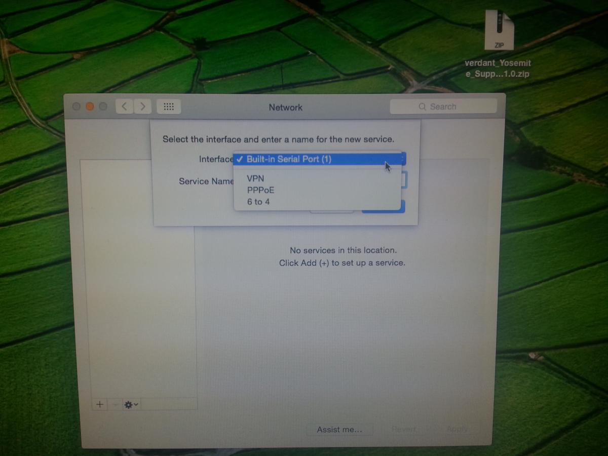

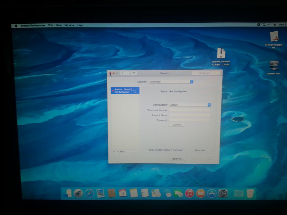

MadDawg2020 Posted December 4, 2014 Share Posted December 4, 2014 Hello I'm up and running on EVGA Nforce 780i Intel Q9400 Core2 Duo quad 2.66HGhz 4GB Corsair DominatorVideo: Geforce GT 740 FTW 2GB Still having issues with sound and Ethernet Tried using your support files so far not working. forgot to add that only network connection is "dail in/up" as you maybe able to see in the pic.but no LAN options it's grayed out.Thoughts?! Link to comment https://www.insanelymac.com/forum/topic/301635-nforce-os-x-yosemite-1010-app-store-download-install-guide-on-a-series-6-or-7-nforce-chipset-intel-cpu-mobo/#findComment-2091832 Share on other sites More sharing options...

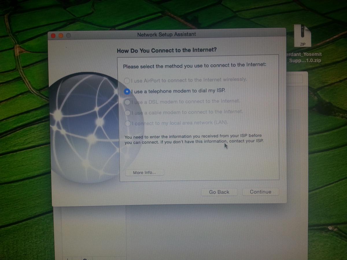

MadDawg2020 Posted December 4, 2014 Share Posted December 4, 2014 Here are some better pics Hope that helps Link to comment https://www.insanelymac.com/forum/topic/301635-nforce-os-x-yosemite-1010-app-store-download-install-guide-on-a-series-6-or-7-nforce-chipset-intel-cpu-mobo/#findComment-2091835 Share on other sites More sharing options...
verdant Posted December 5, 2014 Author Share Posted December 5, 2014 Hi MadDawg2020, That is good news....... You are having issues with sound because I believe your MOBO uses a Realtek ALC888 codec / chipset.....see Mirone's AppleHDA for Yosemite topic for ALC888...... As for LAN, I believe your MOBO uses the Marvell 88E1116 chipset for LAN, so the nForceLAN.0.64.5.kext should work for you.........assuming that thenForceLAN.0.64.5.kext, then do the following: In Terminal type: sudo chown -R root:wheel /System/Library/Extensions sudo chmod -R 755 /System/Library/Extensions sudo touch /System/Library/Extensions Then go to /System/Library/Caches/com.apple.kext.caches/Startup and delete the files within Startup…. invalidsignedkextalert.plist IOKitPersonalities_x86_64.ioplist.gz kernelcache KextPropertyValues_OSBundleHelper_x86_64.plist.gz loadedkextmt.plist Then, in Terminal, type sudo kextcache -system-prelinked-kernel sudo kextcache -system-caches Then use the OS X Yosemite Disk Utility to repair the OS X Yosemite HDD system permissions......then reboot...... If this still does not work, then run cVADs Kext Utility for Yosemite......... Link to comment https://www.insanelymac.com/forum/topic/301635-nforce-os-x-yosemite-1010-app-store-download-install-guide-on-a-series-6-or-7-nforce-chipset-intel-cpu-mobo/#findComment-2092401 Share on other sites More sharing options...
