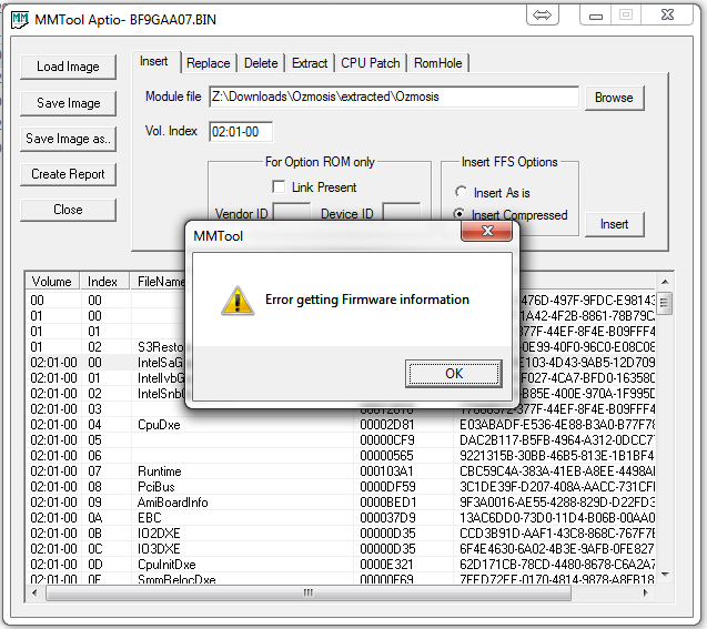

Vampnight Posted May 18, 2015 Share Posted May 18, 2015 Hi, Im trying to patch an UEFI Bios for the Jetway NF9G-QM77 board I followed the guide on the page 1 but no matter how I tried I always hit an error when I trying to insert the Ozmosis file into the Volume. I made sure to follow the steps exactly, even clicked the "Insert Compressed" before inserting but made no difference. Update: I tried to insert the files in various sequence and noticed that after initially inserting the CORE_DXE the free space remains above 1200Kb and I can insert all of the files fine, except the following 3: Ozmosis VoodooHdaKext HermitShellx64 When I try to insert any of these, the MMTool throws an error (possibly indicating the lack of space on the volume, but the report pulled just before inserting any of the files shows plenty of space). After this if I try to insert an other file the tool freezes and quits. Could you please let me know if this is a known issue, or if I'm doing something wrong? I have uploaded the vanilla bios file and the one into which I managed to insert the "most" additional files. (and also the reports before and after just in case it helps to determine what is going on here. The reports are just a "randomly picked" before and after the error message. The output is the exactly the same every time this occurs) Thanks BF9GAA07_modified.BIN.zip Reports - BF9GAA07.zip BF9GAA07.zip Link to comment https://www.insanelymac.com/forum/topic/301407-guide-insert-ozmosis-into-uefi-bios/page/5/#findComment-2136730 Share on other sites More sharing options...
Pavo Posted May 19, 2015 Author Share Posted May 19, 2015 Hi, Im trying to patch an UEFI Bios for the Jetway NF9G-QM77 board I followed the guide on the page 1 but no matter how I tried I always hit an error when I trying to insert the Ozmosis file into the Volume. I made sure to follow the steps exactly, even clicked the "Insert Compressed" before inserting but made no difference. Update: I tried to insert the files in various sequence and noticed that after initially inserting the CORE_DXE the free space remains above 1200Kb and I can insert all of the files fine, except the following 3: Ozmosis VoodooHdaKext HermitShellx64 When I try to insert any of these, the MMTool throws an error (possibly indicating the lack of space on the volume, but the report pulled just before inserting any of the files shows plenty of space). After this if I try to insert an other file the tool freezes and quits. Could you please let me know if this is a known issue, or if I'm doing something wrong? I have uploaded the vanilla bios file and the one into which I managed to insert the "most" additional files. (and also the reports before and after just in case it helps to determine what is going on here. The reports are just a "randomly picked" before and after the error message. The output is the exactly the same every time this occurs) Thanks This is a not typical UEFI type of firmware, it is extremely small and doesn't allow for any insertion. Link to comment https://www.insanelymac.com/forum/topic/301407-guide-insert-ozmosis-into-uefi-bios/page/5/#findComment-2136898 Share on other sites More sharing options...
Vampnight Posted May 19, 2015 Share Posted May 19, 2015 This is a not typical UEFI type of firmware, it is extremely small and doesn't allow for any insertion. Thanks for the quick response. Does this mean that you would advise more against the BIOS mod for this board? Link to comment https://www.insanelymac.com/forum/topic/301407-guide-insert-ozmosis-into-uefi-bios/page/5/#findComment-2136958 Share on other sites More sharing options...

Pavo Posted May 19, 2015 Author Share Posted May 19, 2015 Thanks for the quick response. Does this mean that you would advise more against the BIOS mod for this board? Yes I would advise against using this board for Ozmosis it has as to insert osmosis (zotac nano id68 plus), already I have installed yosemite 100% ok Bios Umm say again, completely do not understand this question or statement Link to comment https://www.insanelymac.com/forum/topic/301407-guide-insert-ozmosis-into-uefi-bios/page/5/#findComment-2137069 Share on other sites More sharing options...
