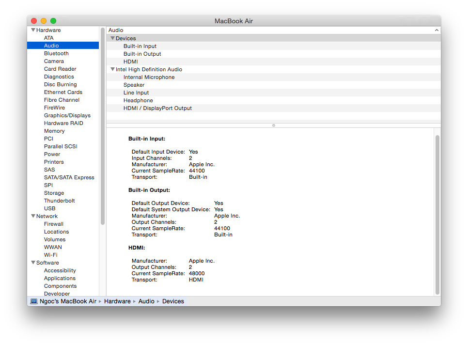

chriz74 Posted March 4, 2015 Share Posted March 4, 2015 Is there a solution for notebooks? I have alc270 working with a modified kext (I put my verbs), hdmi audio out recognized in system specs. I tried to patch ports 0x5 0x6 and 0x7 through clover as in the hd4000 guide and have the dsdt patched. However still no audio out for HDMI. What am I missing? System is the asus x301a in signature. Thanks. Link to comment https://www.insanelymac.com/forum/topic/301137-yosemite-applehda-hdmi-audio/page/8/#findComment-2117655 Share on other sites More sharing options...

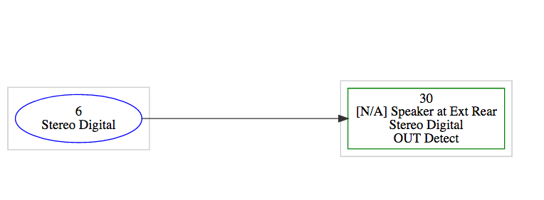

toleda Posted March 5, 2015 Author Share Posted March 5, 2015 Yosemite 10.10.2 / Asus x301a (notebook) (hm76 chipset) / Bios rev 221 / i7-3630qm / HD4000 Does this digital node has anything to do with the problem? I mean is it possible that this node is HDMI digital out and must be inserted into platforms.xml in appleHDA kext? HDMI device does not appear in IOReg. dsdt edits are correct. Reply with new IOReg. No, SPDIFout. Link to comment https://www.insanelymac.com/forum/topic/301137-yosemite-applehda-hdmi-audio/page/8/#findComment-2117888 Share on other sites More sharing options...

chriz74 Posted March 5, 2015 Share Posted March 5, 2015 HDMI device does not appear in IOReg. dsdt edits are correct. Reply with new IOReg. No, SPDIFout. bingo My system specs suggest hd4000 id 1660009 so I put that in the dsdt instead of 1660003. The only problem is that I don't get extended display. When I plug the HDMI external monitor the internal one lights up but no picture is displayed. Any clue?Then applied these patches: for lvds internal video to work AppleIntelFramebufferCapri 010000000200000030000000 to 050300000200000030000000 for hdmi and dvi DVI (probably not needed as I only have an hdmi port) AppleIntelFramebufferCapri 020500000004000007010000 to 020500000008000006000000 HDMI (audio works) AppleIntelFramebufferCapri 030400000004000007010000 to 030400000008000006000000 Link to comment https://www.insanelymac.com/forum/topic/301137-yosemite-applehda-hdmi-audio/page/8/#findComment-2117982 Share on other sites More sharing options...
