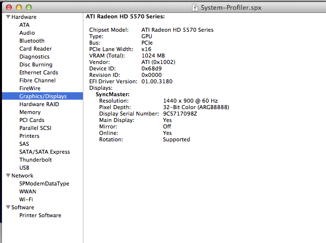

cdoublejj Posted August 23, 2014 Share Posted August 23, 2014 Where can i find model number specific working video cards? I have an OOB HD5570 yet eve nafter 10.6.8 update it it still only shows up as HD5000, where can i find model number spcific working video card versions? I need an EXACT video card version/model, prefferably equivletn tothe HD5570. Link to comment https://www.insanelymac.com/forum/topic/300460-where-can-i-find-model-number-specific-working-video-cards/ Share on other sites More sharing options...
XTuga Posted August 23, 2014 Share Posted August 23, 2014 So you don't have it in System Report? 1 Link to comment https://www.insanelymac.com/forum/topic/300460-where-can-i-find-model-number-specific-working-video-cards/#findComment-2054576 Share on other sites More sharing options...
cdoublejj Posted August 24, 2014 Author Share Posted August 24, 2014 So you don't have it in System Report? Yes, Click multi times to get fullsize with readable text. https://support.rockstargames.com/hc/en-us/articles/200147396-DirectX-8-1-error-when-launching-GTA-games-on-Mac Link to comment https://www.insanelymac.com/forum/topic/300460-where-can-i-find-model-number-specific-working-video-cards/#findComment-2054888 Share on other sites More sharing options...
Slice Posted August 25, 2014 Share Posted August 25, 2014 I have the same card HD5570 with devID=0x68d9 It is natively supported but you can't get right Model Name without injection. Also I had no DVD player and sllep/wake working without careful connector patch. My OEM is VTX. If you have the same card I may show you my config for Clover. Else you should read common instruction and made your own patch for this card. EDITED. Clover config: <key>KernelAndKextPatches</key> <dict> <key>Debug</key> <false/> <key>KernelCpu</key> <false/> <key>ATIConnectorsController</key> <string>5000</string> <key>ATIConnectorsData</key> <data>BAAAABQAAAAAAQAAAQIBAwAIAAAAAgAAAHEAACIFAgEQAAAAEAAAAAABAAAAEAAC</data> <key>AppleRTC</key> <true/> <key>ATIConnectorsPatch</key> <data>EAAAABAAAAAAAQAAABAAAgQAAAAUAAAAAAEAABECAQQACAAAAAIAAABxAAAiBQIF</data> </dict> <key>Graphics</key> <dict> <key>PatchVBios</key> <false/> <key>Inject</key> <dict> <key>Intel</key> <false/> <key>ATI</key> <true/> <key>NVidia</key> <false/> </dict> <key>FBName</key> <string>Baboon</string> <key>VideoPorts</key> <string>2</string> <key>GraphicsInjector</key> <string>Yes</string> <key>LoadVBios</key> <string>No</string> <key>DualLink</key> <integer>0</integer> </dict> Link to comment https://www.insanelymac.com/forum/topic/300460-where-can-i-find-model-number-specific-working-video-cards/#findComment-2055228 Share on other sites More sharing options...
cdoublejj Posted August 26, 2014 Author Share Posted August 26, 2014 I have the same card HD5570 with devID=0x68d9 It is natively supported but you can't get right Model Name without injection. Also I had no DVD player and sllep/wake working without careful connector patch. My OEM is VTX. If you have the same card I may show you my config for Clover. Else you should read common instruction and made your own patch for this card. EDITED. Screen Shot 2014-08-25 at 21.35.35.png Clover config: <key>KernelAndKextPatches</key> <dict> <key>Debug</key> <false/> <key>KernelCpu</key> <false/> <key>ATIConnectorsController</key> <string>5000</string> <key>ATIConnectorsData</key> <data>BAAAABQAAAAAAQAAAQIBAwAIAAAAAgAAAHEAACIFAgEQAAAAEAAAAAABAAAAEAAC</data> <key>AppleRTC</key> <true/> <key>ATIConnectorsPatch</key> <data>EAAAABAAAAAAAQAAABAAAgQAAAAUAAAAAAEAABECAQQACAAAAAIAAABxAAAiBQIF</data> </dict> <key>Graphics</key> <dict> <key>PatchVBios</key> <false/> <key>Inject</key> <dict> <key>Intel</key> <false/> <key>ATI</key> <true/> <key>NVidia</key> <false/> </dict> <key>FBName</key> <string>Baboon</string> <key>VideoPorts</key> <string>2</string> <key>GraphicsInjector</key> <string>Yes</string> <key>LoadVBios</key> <string>No</string> <key>DualLink</key> <integer>0</integer> </dict> what is clover? Do I add that to the Chameleon Wizard device properties? One time i tried to add device ID to the kext but, then error "blah blah kext not installed proeprly" started popping up al lthe time and i think the kext broke. Link to comment https://www.insanelymac.com/forum/topic/300460-where-can-i-find-model-number-specific-working-video-cards/#findComment-2055406 Share on other sites More sharing options...
