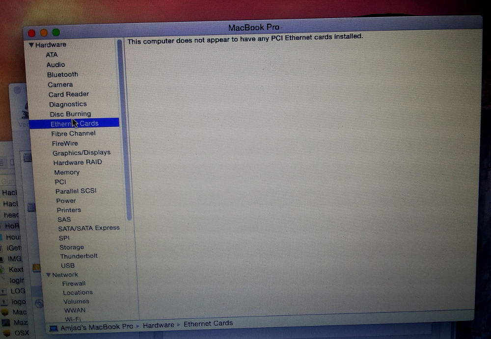

TheNavigator Posted September 1, 2014 Author Share Posted September 1, 2014 Also, check the attached images. Link to comment https://www.insanelymac.com/forum/topic/300234-dell-inspiron-15r-special-edition-7520/page/3/#findComment-2057208 Share on other sites More sharing options...

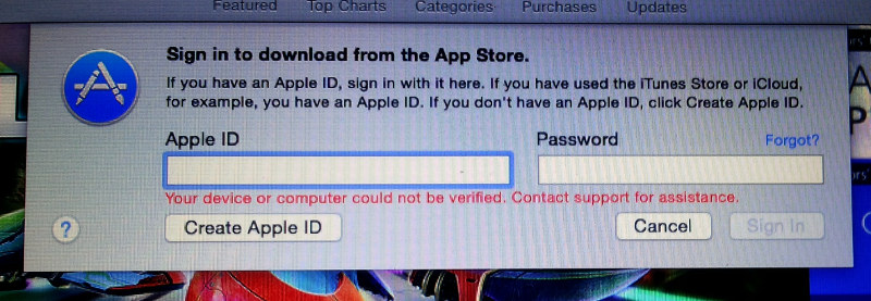

mendietinha Posted September 2, 2014 Share Posted September 2, 2014 you must find the right kext or the proper plist edit in order to have ethernet and en0 to sign in apple store. Link to comment https://www.insanelymac.com/forum/topic/300234-dell-inspiron-15r-special-edition-7520/page/3/#findComment-2057261 Share on other sites More sharing options...
TheNavigator Posted September 2, 2014 Author Share Posted September 2, 2014 But... but... it worked with Mavericks! ._. I guess it was because in the end it was a Niresh distro... Anyway, did an lspci on Linux, "07:00.0 Ethernet controller: Realtek Semiconductor Co., Ltd. RTL8111/8168/8411 PCI Express Gigabit Ethernet Controller (rev 07)" Link to comment https://www.insanelymac.com/forum/topic/300234-dell-inspiron-15r-special-edition-7520/page/3/#findComment-2057282 Share on other sites More sharing options...

TheNavigator Posted September 4, 2014 Author Share Posted September 4, 2014 Oh, okay, I'll try that. And that ethernet kext worked. I could login to the App Store successfully, however, I had to do that "remove all services and delete the networkpan file from Library/whatever" thing. I'm going to update the guide soon accordingly. Link to comment https://www.insanelymac.com/forum/topic/300234-dell-inspiron-15r-special-edition-7520/page/3/#findComment-2057766 Share on other sites More sharing options...

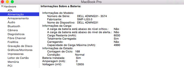

TheNavigator Posted September 7, 2014 Author Share Posted September 7, 2014 https://github.com/RehabMan/Laptop-DSDT-Patch/blob/4fae63254fddc36946159272d55b775c8c18a745/battery/battery_Dell-Vostro-15xx.txt This one worked. You can add Dell Inspiron 15 Special Edition (7520) to the working list Now let's change the sound, VoodooHDA Link to comment https://www.insanelymac.com/forum/topic/300234-dell-inspiron-15r-special-edition-7520/page/3/#findComment-2058505 Share on other sites More sharing options...
