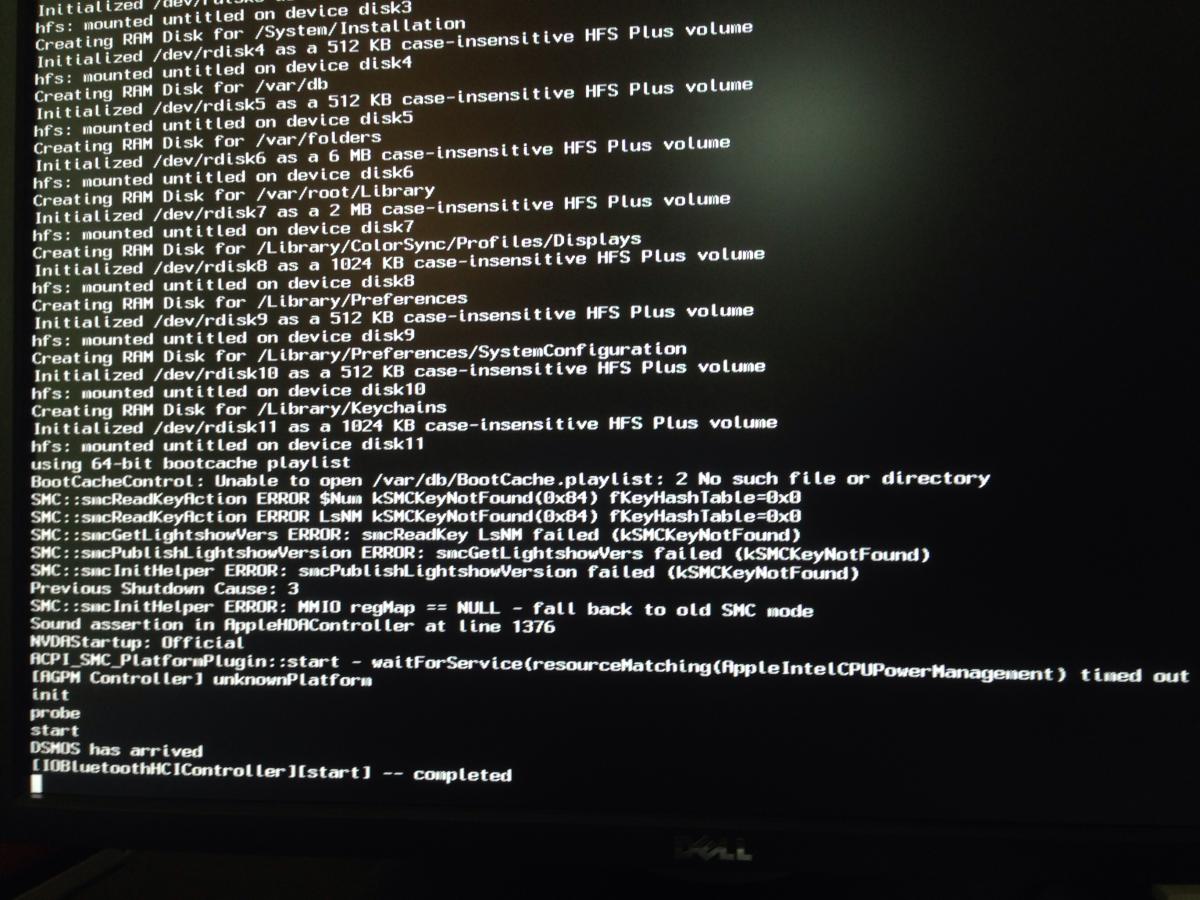

zack8078 Posted July 27, 2014 Share Posted July 27, 2014 Hello, I've tried a few different install methods for Mavericks. [url="http://www.insanelymac.com/forum/topic/279450-why-insanelymac-does-not-support-tonymacx86/"]#####[/url], Niresh distro, and most recently using myHack. I haven't been able to boot to the install screen using any of these methods. I've also tried this bios. Specs: Asus P6TD Deluxe 0608 Bios, also tried bios in link 12 GB (4gx3) Corsair CMZ12GX3M3A1600C9 EVGA NVIDIA GeForce GTX 750 Ti No other hardware connected except USB Keyboard/Mouse Here's what I get with myHack 3.3.1 USB flash with 10.9 Any help would be appreciated Link to comment https://www.insanelymac.com/forum/topic/299839-109-install-troubles-with-asus-p6td-deluxe-stuck-at-iobluetoothhcicontrollerstart-completed/ Share on other sites More sharing options...

Pimentel Posted July 27, 2014 Share Posted July 27, 2014 Hello Welcome Your Nvidia GTX 750ti maybe doesn't work, is Maxwell archtecture... isn't supported by Apple yet Link to comment https://www.insanelymac.com/forum/topic/299839-109-install-troubles-with-asus-p6td-deluxe-stuck-at-iobluetoothhcicontrollerstart-completed/#findComment-2045255 Share on other sites More sharing options...
zack8078 Posted July 27, 2014 Author Share Posted July 27, 2014 Hello Welcome Your Nvidia GTX 750ti maybe doesn't work, is Maxwell archtecture... isn't supported by Apple yet Thanks! I think you nailed it. I swapped to an older GPU and the install is running. Link to comment https://www.insanelymac.com/forum/topic/299839-109-install-troubles-with-asus-p6td-deluxe-stuck-at-iobluetoothhcicontrollerstart-completed/#findComment-2045282 Share on other sites More sharing options...

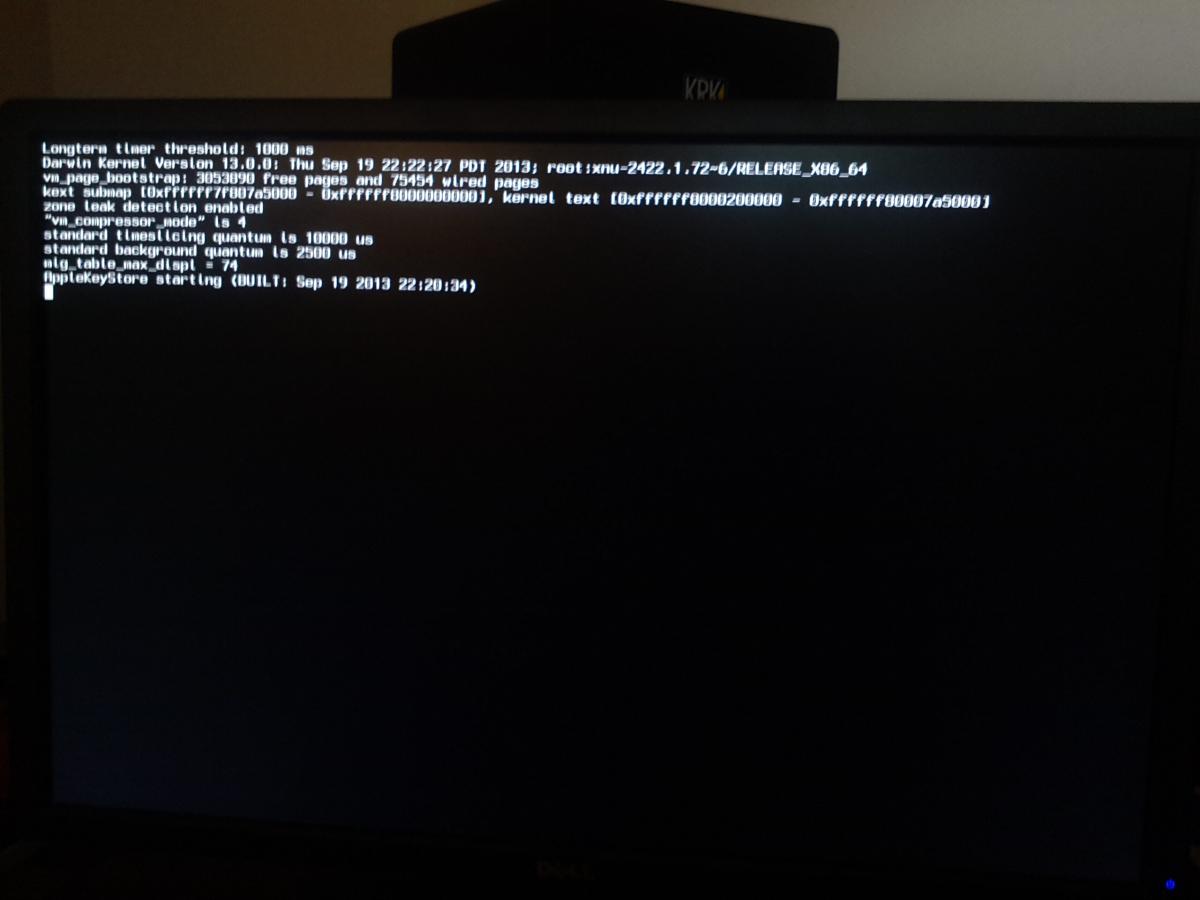

zack8078 Posted July 27, 2014 Author Share Posted July 27, 2014 I followed the complete "Vanilla Guide" and now I'm stuck here Link to comment https://www.insanelymac.com/forum/topic/299839-109-install-troubles-with-asus-p6td-deluxe-stuck-at-iobluetoothhcicontrollerstart-completed/#findComment-2045342 Share on other sites More sharing options...
Pimentel Posted July 27, 2014 Share Posted July 27, 2014 Hello Your mobo has UEFI? If yes, it's ajusted for UEFI or legacy mode? Because Chameleon work only in legacy mode... if UEFI mode is enable in bios, change this to legacy Link to comment https://www.insanelymac.com/forum/topic/299839-109-install-troubles-with-asus-p6td-deluxe-stuck-at-iobluetoothhcicontrollerstart-completed/#findComment-2045390 Share on other sites More sharing options...
