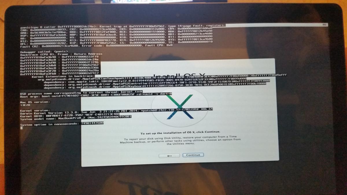

curbsidepolymath Posted July 27, 2014 Author Share Posted July 27, 2014 I am attempting to install Mavericks now and cannot get past the white apple screen upon booting the usb and grey wheel that stops loading. I tried verbose mode and got a kp. Any suggestions? Link to comment https://www.insanelymac.com/forum/topic/299511-niresh-mavericks-installed-but-computer-always-boots-windows-8/#findComment-2045182 Share on other sites More sharing options...
Allan Posted July 28, 2014 Share Posted July 28, 2014 use this flag: dart=0 1 Link to comment https://www.insanelymac.com/forum/topic/299511-niresh-mavericks-installed-but-computer-always-boots-windows-8/#findComment-2045467 Share on other sites More sharing options...

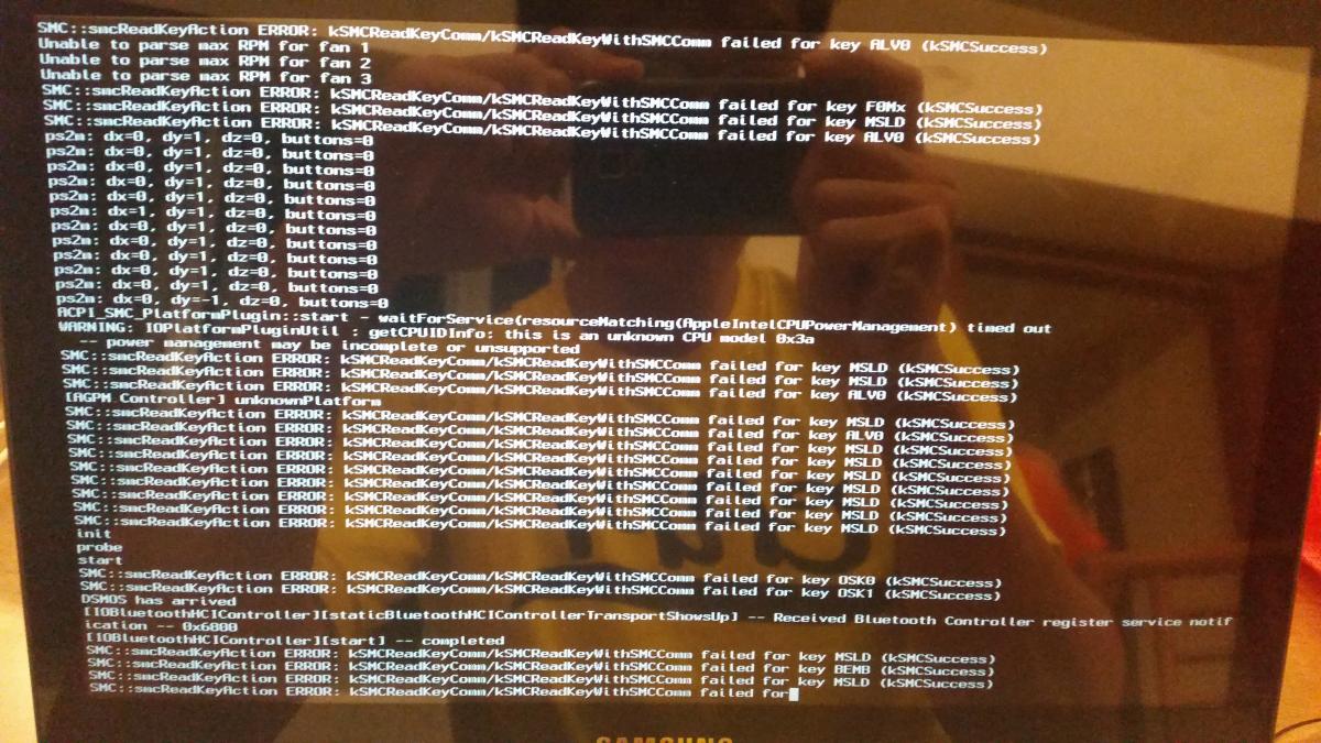

curbsidepolymath Posted July 28, 2014 Author Share Posted July 28, 2014 Thanks allan for the prompt replies! Using the dart flag gets me to the installer, but then it would be very unstable and slow and would hang at unpredictable times. I've not gotten past disk utility yet. I am currently using myHack as my boot usb, with the np740u3e package installed as extra. UPDATE: Managed to get the installer to start installing and not freezing, by using bootflags -v -f -x dart=0. It caused my touchpad to stop working, so I plugged in my USB mouse and managed to create partitions with Disk Utility and start the installation! Will update further. Link to comment https://www.insanelymac.com/forum/topic/299511-niresh-mavericks-installed-but-computer-always-boots-windows-8/#findComment-2045601 Share on other sites More sharing options...
