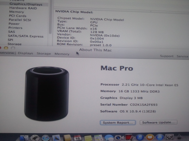

theblackhole Posted July 15, 2014 Author Share Posted July 15, 2014 First time I can see the nvidia card, although I am still using onboard VGA what's the next step? I am running out of ideas Link to comment https://www.insanelymac.com/forum/topic/299400-mavericks-not-accepting-gtx-780/#findComment-2040939 Share on other sites More sharing options...
