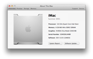

hnak Posted August 19, 2014 Share Posted August 19, 2014 GT 740 works on Yosemite, injection = off. Galaxy GF-GT740-LE2GHD is recognized as NVIDIA Chip Model 2048MB. OpenGL works, though not so great performance. Link to comment https://www.insanelymac.com/forum/topic/299362-gt-740-on-mac-os-x/#findComment-2053151 Share on other sites More sharing options...

liujianwei Posted October 8, 2015 Share Posted October 8, 2015 Inject = OFF 10.9.5 13F34 Everything works well NVIDIA Chip Model: Chipset Model: NVIDIA Chip Model Type: GPU Bus: PCIe PCIe Lane Width: x16 VRAM (Total): 2048 MB Vendor: NVIDIA (0x10de) Device ID: 0x0fc8 Revision ID: 0x00a2 ROM Revision: preset 1.0.0 Displays: DELL E2715H: Resolution: 1920 x 1080 @ 60 Hz Pixel Depth: 32-Bit Color (ARGB8888) Display Serial Number: HCVNY48MC1CL Main Display: Yes Mirror: Off Online: Yes Rotation: Supported But in 10.11.3 (15D21) GT 740 need inject. Link to comment https://www.insanelymac.com/forum/topic/299362-gt-740-on-mac-os-x/#findComment-2174918 Share on other sites More sharing options...

jminrod Posted March 27, 2016 Share Posted March 27, 2016 My Nvidia driver app isn't showing. I downloaded the new app but it never shows in my apps. The reason I am looking is my system preference folder will not show anything. It shows up but nothing. I was doing some research and it appears that nvidia drivers might cause this. If I go to about this mac it shows "EVGA GeForce GT 740 0 MB" does the zero meg mean its not really installed? I am 10.11.2 currently. Link to comment https://www.insanelymac.com/forum/topic/299362-gt-740-on-mac-os-x/#findComment-2227863 Share on other sites More sharing options...
