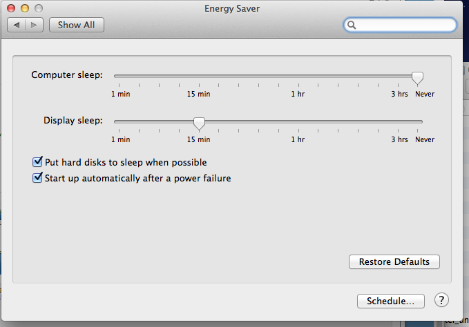

iseedeadpixels Posted June 2, 2014 Share Posted June 2, 2014 Hi to all of you i recently finished my first hackintosh and after a few tryouts got it running pretty fine, even with dual booting and a 21:9 display. So this brings up my issue: My Sleep is oddly misbehaving. If i send my computer to sleep it turns out the screen and the drives just fine, but all fans keep running. Once the audible click of the hdd sounded, i can not wake up the system. Black screen, no drives waking, just fans. Hard reset and everything is still working. So far i failed with the following methods: darkwake=0 checking the pmset -g assertions output (nothing odd i guess) installing the evoreboot kext disabling hdd sleep in the system options checking the system.log (last message always different) System Info: i7-4770 Gigabyte H87N-WiFi Gigabyte GTX 660 3072 OC (Internal graphics disabled) Corsair Vengeance LP 8GB Crucial M500 SSD + WD Caviar Blue Gmyle Bluetooth 4.0 Dongle (for the Apple Wireless) Logitech G700 Mouse (does not wake wired or wireless) OS X 10.9.3 (Niresh Distro updated via Combo Update) Sorry for that long text. And thank you for even reading this. Cheers, Leif Link to comment https://www.insanelymac.com/forum/topic/298401-help-no-wake-from-sleep-fans-keep-running/ Share on other sites More sharing options...
