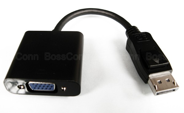

TommyCardello Posted March 5, 2015 Share Posted March 5, 2015 I have different idea. I`ve got my monitors connected: primary(HDMI) with DVI-HDMI cable, second(DVI) with DVI-DVI, and third (DP which not work) with VGA-VGA+vga-dp adapter. Maybe os x/mac cannot recognize DP because of adapter? What do you think guys? HAVE ANYONE working monitors with adapters as mine? Link to comment https://www.insanelymac.com/forum/topic/297728-r9-290x-help-for-mavericks/page/18/#findComment-2117963 Share on other sites More sharing options...
Codinger Posted March 5, 2015 Share Posted March 5, 2015 I have different idea. I`ve got my monitors connected: primary(HDMI) with DVI-HDMI cable, second(DVI) with DVI-DVI, and third (DP which not work) with VGA-VGA+vga-dp adapter. Maybe os x/mac cannot recognize DP because of adapter? What do you think guys? HAVE ANYONE working monitors with adapters as mine? VGA is not supported by OS X but may work and i think there are no via dp adapters cause VGA is analogue signal and dp digital. Thats like to convert SKART to HDMI happy hacking OSBeast Link to comment https://www.insanelymac.com/forum/topic/297728-r9-290x-help-for-mavericks/page/18/#findComment-2117966 Share on other sites More sharing options...
TommyCardello Posted March 5, 2015 Share Posted March 5, 2015 VGA is not supported by OS X but may work and i think there are no via dp adapters cause VGA is analogue signal and dp digital. Thats like to convert SKART to HDMI happy hacking OSBeast Yes, digital and analogue. You`re right. I mean this device. BUT Firstly, Windows runs great with this adapter. Secondly, without frame buffer patch my Hackintosh can start with working DP. But as he like, can start with working or can start with black screen at same config. I`m not sure that is something as a bug, or theoretically it can work with this adapter with right config? Link to comment https://www.insanelymac.com/forum/topic/297728-r9-290x-help-for-mavericks/page/18/#findComment-2117970 Share on other sites More sharing options...
BBond007 Posted March 5, 2015 Share Posted March 5, 2015 i was using this one: http://www.tigerdirect.com/applications/SearchTools/item-details.asp?EdpNo=9127780 it supports DVI and HDMI out and works really well. now I'm using this one http://www.amazon.com/gp/product/B00LIHRFPW/ sometimes after wake with this one the monitor takes an long time to sync or reverts to a weird resolution. probably something to do with this cheap 19" monitor. Link to comment https://www.insanelymac.com/forum/topic/297728-r9-290x-help-for-mavericks/page/18/#findComment-2118076 Share on other sites More sharing options...
