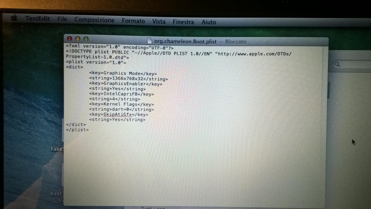

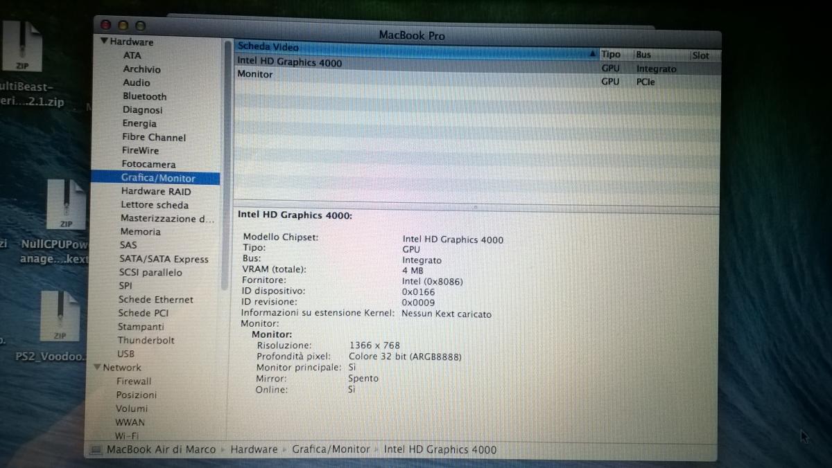

diablos872001 Posted April 13, 2014 Share Posted April 13, 2014 Hello everybody! As my signature, I've got a Dell 15r 5521 with intel hd 4000 plus ati radeon 8730M. I know that the radeon probably will never work, but my problem is to enable the HD4000. I think that is partially working but only with 4MB (?!?!!?) of VRAM, possible? (instead 1024!!!) Picture In my org.chameleon.boot.plist I set the number 4 injection for Capri, but the sistem pick the number 9 ?! Also tried to put a smbios.plist for mackbook pro 9.2 in the Extra folder, but thing doesn't change. Any help would reeeeeeeeeally appreciated!!! Link to comment https://www.insanelymac.com/forum/topic/297444-dell-15r-5521-1092-lot-of-things-to-fix-hd4000-first-one/ Share on other sites More sharing options...
artur_pt Posted April 13, 2014 Share Posted April 13, 2014 hello what i saw in picture .. none kext for graphics is loaded maybe u should try another ig-platform-id Intel HD4000 and Haswell Inject AAPL,ig-platform-id good hack Link to comment https://www.insanelymac.com/forum/topic/297444-dell-15r-5521-1092-lot-of-things-to-fix-hd4000-first-one/#findComment-2012459 Share on other sites More sharing options...
diablos872001 Posted April 14, 2014 Author Share Posted April 14, 2014 The problem is that I've tryed all the numbers from that list for capri One thing: for install mavericks 10.9.2 I've renamed kext in the usb pendrive to boot in S/L/E AppleIntelHd** and also AppleIntelSB** (if I remember well). Could be a problem that the installation doesn't copied them in the right way? DONE, YEAH!!! I've take the correct kext from the usb installation boot and put on the hard disk with kext installer! Then with capri n°4 i had got four desktop in the screen, tried n°3 and perfectly working! Now Intel HD4000 with 1024VRAM and translucent osx bar on the top of the screen! NEXT THING to work on: AUDIO! Mmmm where must I start? I don't know if is correct but my dell 15R 5521 use a Realteck 3321 as audio codec, but i don't see any compatibility DONE, ALSO AUDIO WORK I've used the VoodooHDA kext, version 284 NEXT THING to work on: BATTERY AND POWER IN GENERAL! For this one I don't really know where to start! Search button a lot I think Link to comment https://www.insanelymac.com/forum/topic/297444-dell-15r-5521-1092-lot-of-things-to-fix-hd4000-first-one/#findComment-2012503 Share on other sites More sharing options...
