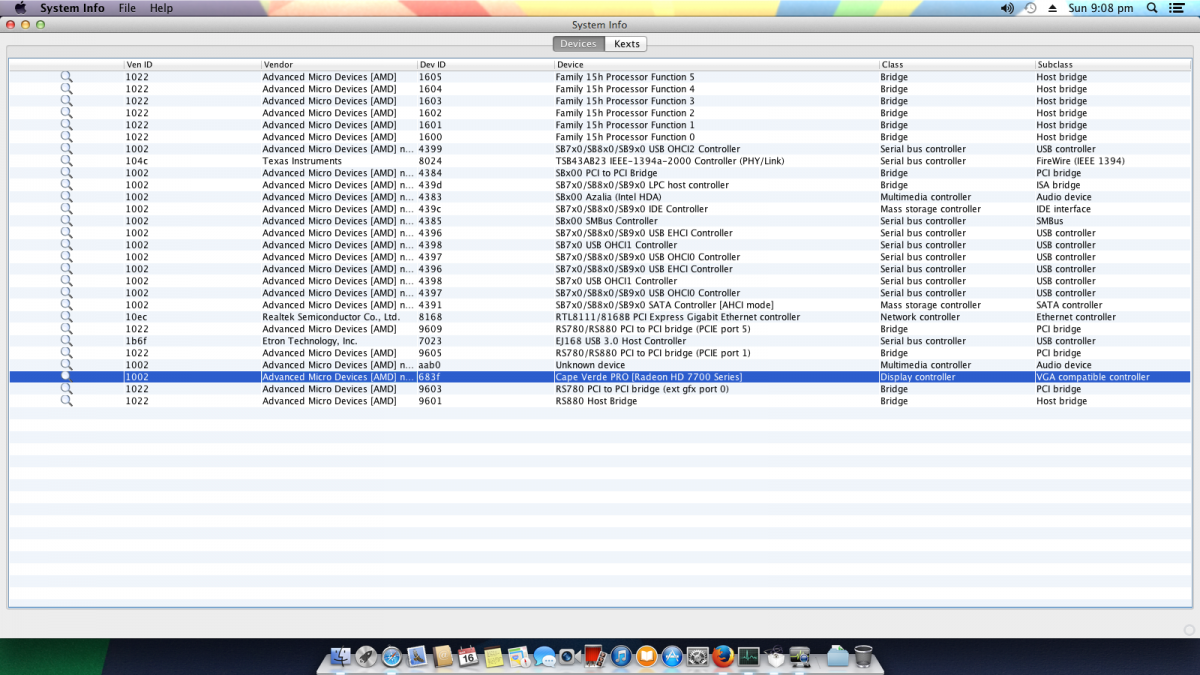

install the systeminfo tool create an image and upload it here, then we look to whether it is possible to configure.
