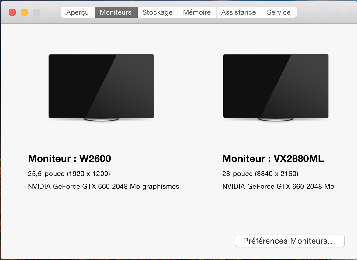

iCore Posted September 13, 2015 Share Posted September 13, 2015 Hi guys, here is an update on my NVCAP issue As I have a Mavericks partition where my GTX 660 is correctly working, I grabbed the NVCAP from this working environment, using the following command in the terminal: ioreg -l -w0 | grep NVCAP And I was able to grab the correct NVCAP from my MSI N660 2GD5/OC And the magic value is: 050000000000FFFFFFFF00000000000E00000000 With this NVCAP set in my clover.config, I was able to get my second monitior (a 4K/retina one, using the DisplayPort output of the video card) to work. For information, here is the graphics section of my clover.config <key>Graphics</key> <dict> <key>Inject</key> <dict> <key>ATI</key> <false/> <key>Intel</key> <false/> <key>NVidia</key> <false/> </dict> <key>NvidiaSingle</key> <false/> <key>NVCAP</key> <string>050000000000FFFFFFFF00000000000E00000000</string> </dict> And here the result in About This Mac / Graphics 2 Link to comment https://www.insanelymac.com/forum/topic/295569-nvcap-nvidia-660gtx/#findComment-2167488 Share on other sites More sharing options...
