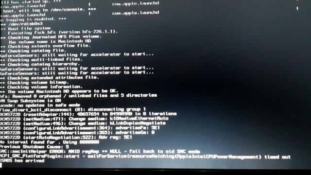

baiyuxiong Posted December 25, 2013 Share Posted December 25, 2013 I am installing 10.9 on my lenovo g430。 After installing succeed and reboot , got stuck at DSMOS has ARRIVED. Screenshot: Pls help,Thanks very much. My notebook: CPU: Mobile DualCore Intel Core 2 Duo T6400, 2000 MHz (10 x 200) Mainboard Lenovo JIWA1 Intel Cantiga PM45 MEMORY 3066 MB (DDR2 SDRAM) DIMM1: RMN1150HC48D7F-667 1 GB DDR2-667 DDR2 SDRAM (5-5-5-15 @ 333 MHz) (4-4-4-12 @ 266 MHz) (3-3-3-9 @ 200 MHz) DIMM3: Samsung M4 70T5663EH3-CF7 2 GB DDR2-800 DDR2 SDRAM (6-6-6-18 @ 400 MHz) (5-5-5-15 @ 333 MHz) (4-4-4-12 @ 266 MHz) BIOS Phoenix (11/13/08) Graphics card:NVIDIA GeForce 9300M GS (256 MB) HARDDISK: ST9500423AS ATA Device (465 GB, IDE) Link to comment https://www.insanelymac.com/forum/topic/294806-stuck-at-dsmos-has-arrivedneed-help/ Share on other sites More sharing options...
Scellow Posted December 25, 2013 Share Posted December 25, 2013 Hi, try to boot with GraphicsEnabler=Yes Link to comment https://www.insanelymac.com/forum/topic/294806-stuck-at-dsmos-has-arrivedneed-help/#findComment-1978714 Share on other sites More sharing options...
baiyuxiong Posted December 25, 2013 Author Share Posted December 25, 2013 Hi, try to boot with GraphicsEnabler=Yes Tried, buy still not work. I reboot with only -v flag,Now stuck at :Resetting IOCatalogue Link to comment https://www.insanelymac.com/forum/topic/294806-stuck-at-dsmos-has-arrivedneed-help/#findComment-1978716 Share on other sites More sharing options...
artur_pt Posted December 25, 2013 Share Posted December 25, 2013 hello probably is graphics problems remove from installer GeForce* and NVDA* boot -f -v GraphicsEnabler=No good hack Link to comment https://www.insanelymac.com/forum/topic/294806-stuck-at-dsmos-has-arrivedneed-help/#findComment-1978730 Share on other sites More sharing options...
baiyuxiong Posted December 25, 2013 Author Share Posted December 25, 2013 hello probably is graphics problems remove from installer GeForce* and NVDA* boot -f -v GraphicsEnabler=No good hack Now stuck here: DSMOS has arrived NTFS driver 3.11 Flags:R/W NTFS volume name win_d, version 3.1. Link to comment https://www.insanelymac.com/forum/topic/294806-stuck-at-dsmos-has-arrivedneed-help/#findComment-1978735 Share on other sites More sharing options...
artur_pt Posted December 25, 2013 Share Posted December 25, 2013 hello is the nvidia the primary graphics card ? u don't have also intel hd ? if so remove appleintelhd* boot again -f -v GraphicsEnabler=No good hack Link to comment https://www.insanelymac.com/forum/topic/294806-stuck-at-dsmos-has-arrivedneed-help/#findComment-1978745 Share on other sites More sharing options...
baiyuxiong Posted December 25, 2013 Author Share Posted December 25, 2013 Thanks, It shows "Reseting IOCatalogue" and stuck again. Link to comment https://www.insanelymac.com/forum/topic/294806-stuck-at-dsmos-has-arrivedneed-help/#findComment-1978785 Share on other sites More sharing options...
