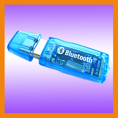

Bob Ajob Posted September 17, 2008 Share Posted September 17, 2008 I purchased 2 x USB2 bluetooth2 dongles very cheap (£2.60 each !!!) from ebay, which both worked absolutely fine on my hackintosh - Item : 100M 2.4G USB 2.0 Bluetooth Dongle V2.0 EDR Adapter PC The online shop was called 'Georges-Worldwide-Online-Store' - http://stores.ebay.co.uk/Georges-Worldwide-Online-Store http://myworld.ebay.co.uk/george_szcn/ Just search around the shop for the item which looks like the attached image ... In the system profiler they are detected as - ISSCEDRBTA: Version: 3.73 Bus Power (mA): 500 Speed: Up to 12 Mb/sec Manufacturer: ISSC Product ID: 0x1004 Vendor ID: 0x1131 Link to comment https://www.insanelymac.com/forum/topic/29324-bluetooth-on-hackintosh/page/4/#findComment-894305 Share on other sites More sharing options...

mickles Posted October 31, 2008 Share Posted October 31, 2008 Just thought I'd add this. I bought a super cheap usb bluetooth adapter from ebay (looks physically the same as Bob AJob's). It got detected immediately, and I was able to pair my mobile phone with no problem. I also got stereo headphones working with Jabra BT8010. This is a mono phone bluetooth headset that can be connected to a 2nd earpiece with a cord. Mono works with skype etc. and stereo works allright as well. Sound quality isn't totally amazing, but it's not bad. Link to comment https://www.insanelymac.com/forum/topic/29324-bluetooth-on-hackintosh/page/4/#findComment-950903 Share on other sites More sharing options...
