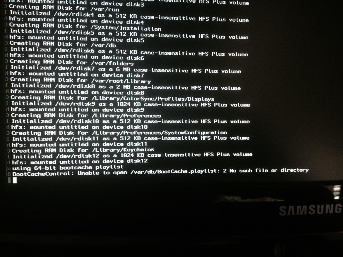

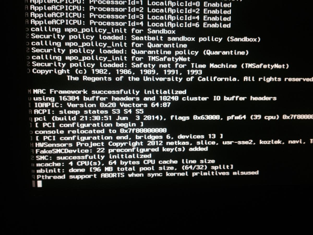

espanico Posted August 8, 2014 Author Share Posted August 8, 2014 Sto provano, ma qualsiasi comando inserisco mi riporta alla schermata grigia con la rotella che gira...EditSono riuscito a far partire con -v ecco dove si ferma Link to comment https://www.insanelymac.com/forum/topic/293111-post-installazione-gigabyte-h87m-hd3/page/2/#findComment-2049630 Share on other sites More sharing options...

carbo178 Posted August 8, 2014 Share Posted August 8, 2014 I 2 kext (FakeSMC e NullCPUPM) installali anche in Sistema/Libreria/Extensions della chiavetta Link to comment https://www.insanelymac.com/forum/topic/293111-post-installazione-gigabyte-h87m-hd3/page/2/#findComment-2049690 Share on other sites More sharing options...
espanico Posted August 8, 2014 Author Share Posted August 8, 2014 Niente mi da sempre l'errore della foto.... Link to comment https://www.insanelymac.com/forum/topic/293111-post-installazione-gigabyte-h87m-hd3/page/2/#findComment-2049755 Share on other sites More sharing options...
carbo178 Posted August 8, 2014 Share Posted August 8, 2014 Prova -v GraphicsEnabler=No -x Link to comment https://www.insanelymac.com/forum/topic/293111-post-installazione-gigabyte-h87m-hd3/page/2/#findComment-2049781 Share on other sites More sharing options...
espanico Posted August 8, 2014 Author Share Posted August 8, 2014 Prova -v GraphicsEnabler=No -x Adesso mi da questo errore: Link to comment https://www.insanelymac.com/forum/topic/293111-post-installazione-gigabyte-h87m-hd3/page/2/#findComment-2049791 Share on other sites More sharing options...
carbo178 Posted August 8, 2014 Share Posted August 8, 2014 Il kernel è della versione con la quale hai creato la chiavetta? Link to comment https://www.insanelymac.com/forum/topic/293111-post-installazione-gigabyte-h87m-hd3/page/2/#findComment-2049834 Share on other sites More sharing options...

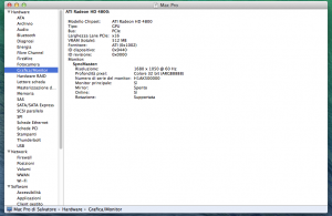

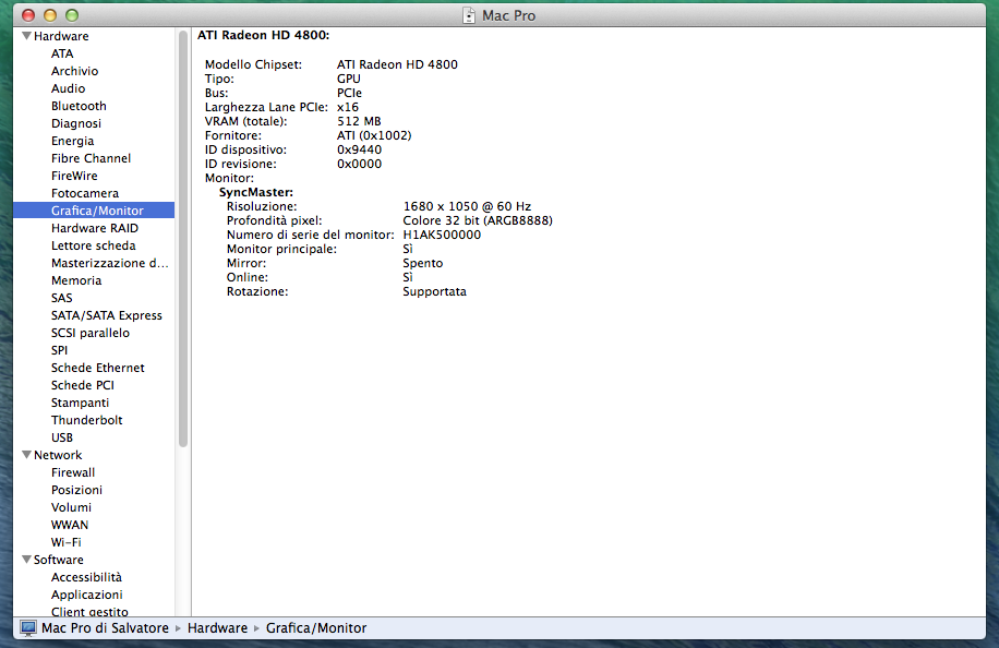

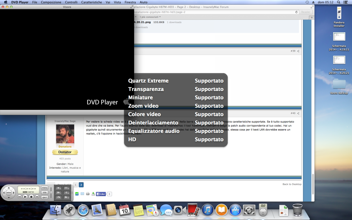

marco.pisellonio80 Posted August 10, 2014 Share Posted August 10, 2014 Per vedere la scheda video se è abilitata vai su applicazioni /lettore DVD. Nella barra del finder vai su Aiuto/mostra caratteristiche supportate. Se è tutto supportato vuol dire che va bene. Per l'audio scarica dalla sez. download di insanelymac il tool hackintosh vietnam e scegli la patch audio corrispondente al tuo codec. Hai un gigabyte quindi sicuramente un realteck ALC892, o 888 ecc. vedi quale codec hai dalle specifiche della tua mobo. stessa cosa per il kext LAN dovrebbe essere un realtek, c'è l'opzione in hackintosh vietnam. Link to comment https://www.insanelymac.com/forum/topic/293111-post-installazione-gigabyte-h87m-hd3/page/2/#findComment-2050258 Share on other sites More sharing options...

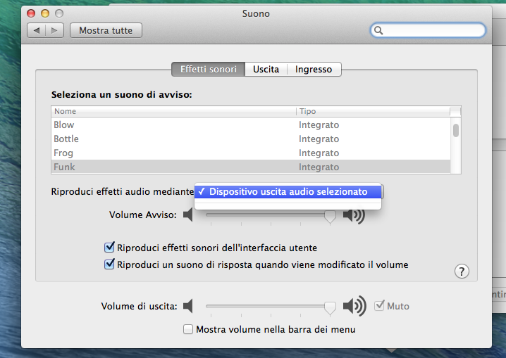

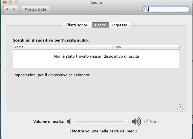

espanico Posted August 10, 2014 Author Share Posted August 10, 2014 Ciao Marco, ho fatto come hai detto e nella schermata mi esce tutto supportato, per quanto riguarda i kext, sono riuscito a far funzionare internet, adesso manca l'audio, ho provato ad installare sia alc887 che alc888, ma nulla. prima di provare alc892, come faccio a eliminare gli altri due in modo che non cadono in conflitto? Controllando nella schermata resoconto di sistema, ho notato che sotto la voce Schede PCI sta scritto Questo computer non contiene nessuna scheda PCI.[/size] E normale? non dovrebbe essere attivo visto che la mia vga utilizza la porta PCi? Link to comment https://www.insanelymac.com/forum/topic/293111-post-installazione-gigabyte-h87m-hd3/page/2/#findComment-2050265 Share on other sites More sharing options...
Fabio1971 Posted August 10, 2014 Share Posted August 10, 2014 Il chip audio è Realtek ALC887 Fabio 1 Link to comment https://www.insanelymac.com/forum/topic/293111-post-installazione-gigabyte-h87m-hd3/page/2/#findComment-2050275 Share on other sites More sharing options...
espanico Posted August 10, 2014 Author Share Posted August 10, 2014 Il chip audio è Realtek ALC887 Fabio Provato, ma non ha funzionato... Link to comment https://www.insanelymac.com/forum/topic/293111-post-installazione-gigabyte-h87m-hd3/page/2/#findComment-2050284 Share on other sites More sharing options...
carbo178 Posted August 10, 2014 Share Posted August 10, 2014 Ti serve hdaenabler con layout 1 Link to comment https://www.insanelymac.com/forum/topic/293111-post-installazione-gigabyte-h87m-hd3/page/2/#findComment-2050290 Share on other sites More sharing options...
marco.pisellonio80 Posted August 10, 2014 Share Posted August 10, 2014 1) Rimuovi AppleHDA.kext dalla cartella System/Library/Extentions (abbreviata in SLE). 2) Avvia Pandora post installazione e fra i moduli del bootloader seleziona "HDAEnabler", poi più sotto "Ripara i permessi" e "Ricostruisci la chache". Lascia completare e riavvia il sistema. 3) Scarica la kext AppleHDA versione ACL887 da qui http://www.insanelymac.com/forum/topic/284778-guida-applehda-su-mountain-e-lion/ installala con kext wizard, poi sempre con kext wizard ripara i permessi e riavvia. Dovresti avere l'audio funzionante. Link to comment https://www.insanelymac.com/forum/topic/293111-post-installazione-gigabyte-h87m-hd3/page/2/#findComment-2050292 Share on other sites More sharing options...
espanico Posted August 10, 2014 Author Share Posted August 10, 2014 1) Rimuovi AppleHDA.kext dalla cartella System/Library/Extentions (abbreviata in SLE). Fatto 2) Avvia Pandora post installazione e fra i moduli del bootloader seleziona "HDAEnabler", poi più sotto "Ripara i permessi" e "Ricostruisci la chache". Lascia completare e riavvia il sistema. Fatto ma quando ho ravviato non si accendeva, rimaneva fermo su una schermata grigia con divieto bianco 3) Scarica la kext AppleHDA versione ACL887 da qui http://www.insanelymac.com/forum/topic/284778-guida-applehda-su-mountain-e-lion/ installala con kext wizard, poi sempre con kext wizard ripara i permessi e riavvia. Dovresti avere l'audio funzionante. Ho fatto ripartire il sistema in safe mode e installato il kext come da istruzioni, il sistema riparte di nuovo normalmente, ma l'audio comunque non funziona Link to comment https://www.insanelymac.com/forum/topic/293111-post-installazione-gigabyte-h87m-hd3/page/2/#findComment-2050298 Share on other sites More sharing options...
marco.pisellonio80 Posted August 10, 2014 Share Posted August 10, 2014 Aspetta... ora che leggo meglio hai il pc collegato tramite vga. Prova con HDMI, in teoria la vga non dovrebbe fungere, perchè i Mac di oggi non ce l'hanno. Ma che significa che l'audio non va? Ti dà l'icona del finder grigia e non puoi modificare il volume? oppure l'icona è nera ma non senti niente lo stesso? va' in preferenze di sistema/audio e vedi se ti rileva i dispositivi. Se te li rileva prova a cambiare il jack nella scheda madre, a me è l'ingresso verde centrale, ma potrebbe cambiare. Link to comment https://www.insanelymac.com/forum/topic/293111-post-installazione-gigabyte-h87m-hd3/page/2/#findComment-2050305 Share on other sites More sharing options...
Fabio1971 Posted August 10, 2014 Share Posted August 10, 2014 Qui per l'audio : https://github.com/toleda/audio_ALC887 Fabio 1 Link to comment https://www.insanelymac.com/forum/topic/293111-post-installazione-gigabyte-h87m-hd3/page/2/#findComment-2050422 Share on other sites More sharing options...

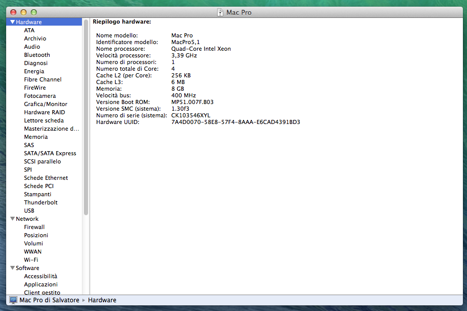

espanico Posted August 11, 2014 Author Share Posted August 11, 2014 Qui per l'audio : https://github.com/toleda/audio_ALC887 Fabio Niente nemmeno questo va. Questa mattina ho reinstallato tutto facendo tutti i passaggi, ma adesso mi ritorco che va a random in panic neon si avvia senza il comando -f.... Sembrava che andasse bene forse nella seconda installazione ho sbagliato qualcosa... I kexts FakeSMC e NullCPUPM li devo installare anche su hd? potrebbe incidere in qualche modo che il sistema risulta come un Mac Pro del 2008, e quindi l'hardware non rispecchia quello reale? oppure e solo una questione estetica? Link to comment https://www.insanelymac.com/forum/topic/293111-post-installazione-gigabyte-h87m-hd3/page/2/#findComment-2050633 Share on other sites More sharing options...
Fabio1971 Posted August 11, 2014 Share Posted August 11, 2014 I kext li devi installare anche su HD Quale bootloader stai utilizzando Prova come smbios 14.1 14.2 Fabio 1 Link to comment https://www.insanelymac.com/forum/topic/293111-post-installazione-gigabyte-h87m-hd3/page/2/#findComment-2050636 Share on other sites More sharing options...
