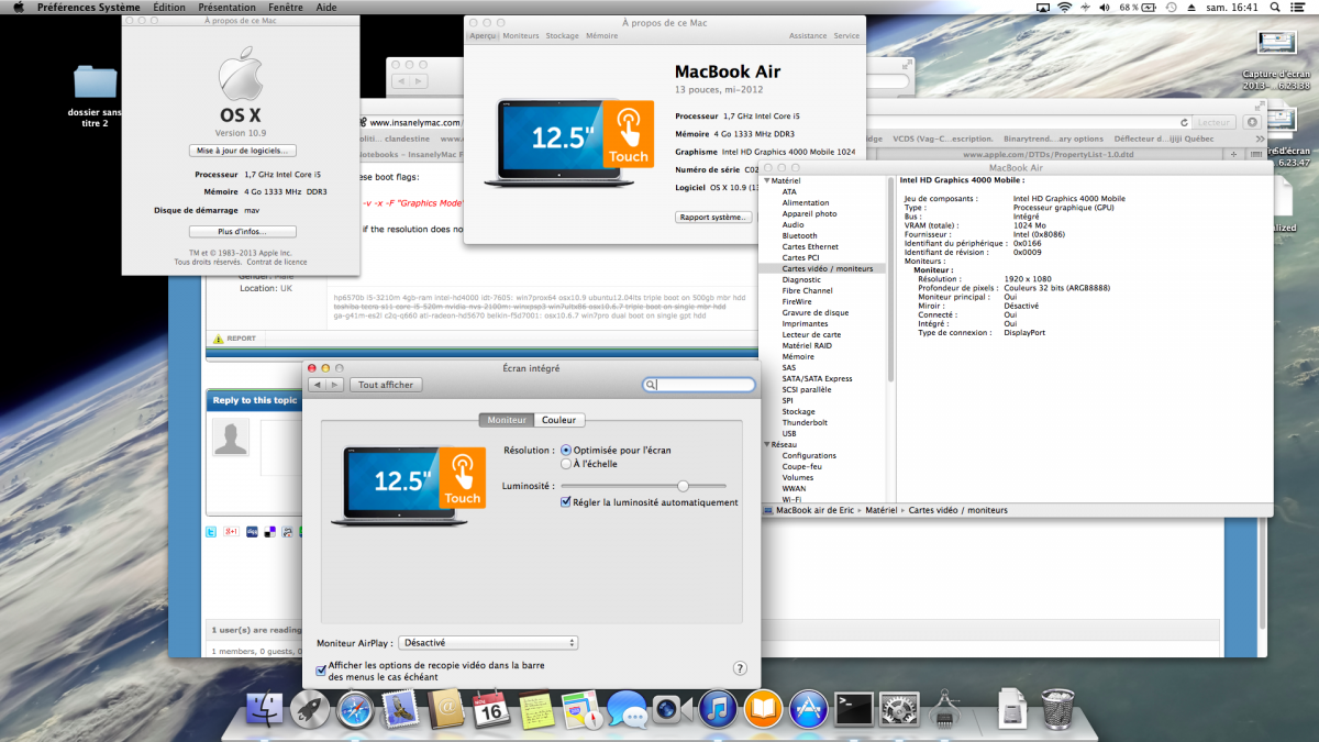

xp1700 Posted November 16, 2013 Share Posted November 16, 2013 for boot its easy this is my boot.plistFor the probleme at Start up type -v dart=0 <?xml version="1.0" encoding="UTF-8"?> <!DOCTYPE plist PUBLIC "-//Apple//DTD PLIST 1.0//EN" "http://www.apple.com/DTDs/PropertyList-1.0.dtd"> <plist version="1.0"> <dict> <key>Boot Banner</key> <string>No</string> <key>Graphics Mode</key> <string>1920x1080x32</string> <key>GraphicsEnabler</key> <string>No</string> <key>EthernetBuiltIn</key> <string>Yes</string> <key>Timeout</key> <string>1</string> <key>IGPEnabler</key> <string>Yes</string> <key>Kernel Flags</key> <string>dart=0</string> <key>Legacy Logo</key> <string>Yes</string> <key>UseKernelCache</key> <string>no</string> </dict> </plist> The touche screen work to. i buy driver of touchbase.com Dave make me a driver for xps 12 Link to comment https://www.insanelymac.com/forum/topic/292806-installation-problems-dell-xps-12/#findComment-1968767 Share on other sites More sharing options...
