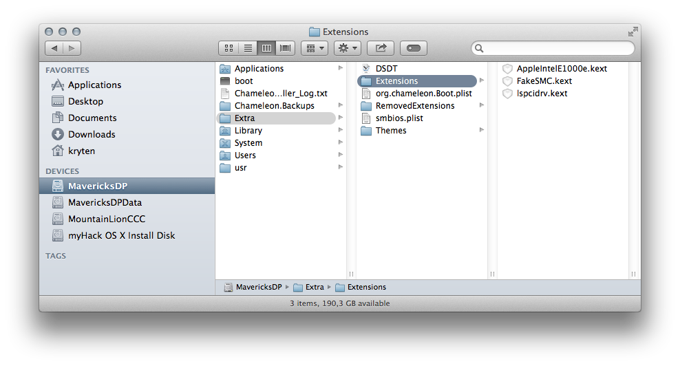

kryten Posted October 13, 2013 Share Posted October 13, 2013 Try installing with the FakeSMC kext that's provided by myHack e.g. FakeSMC.kext version 4.0. Did you rebuild kextcache with myHack (e.g. Run myFix ==> Quick) after replacing the kext files? Good practice is to start fiddling with sound, ethernet, etc after you successfully booted into your install. Link to comment https://www.insanelymac.com/forum/topic/292715-no-install-boot-smcreadkeyaction-err-z87x-ud3h-i7-4770/#findComment-1954341 Share on other sites More sharing options...

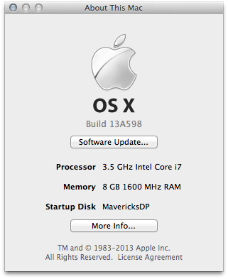

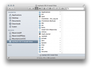

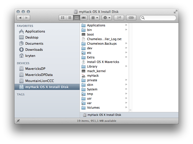

kryten Posted October 14, 2013 Share Posted October 14, 2013 AppleHDA is not the problem as you get stuck also after removing it. Lots of things you can try. Remove your GTX 760 and try installing with the IGPU. Use the latest chameleon for this. Are you sure your myHack USB install is OK? I had the same hanging on grey screen when I had a faulty myHack install creation. You should not have those SMC errors. I'm going to reboot into my myHack install partition to check this. If at first you don't succeed, try again and again. Edit : No SMC errors whatsoever when I boot into the myHack install partition. Takes about a minute or two to get to the language selection screen. Link to comment https://www.insanelymac.com/forum/topic/292715-no-install-boot-smcreadkeyaction-err-z87x-ud3h-i7-4770/#findComment-1954378 Share on other sites More sharing options...
