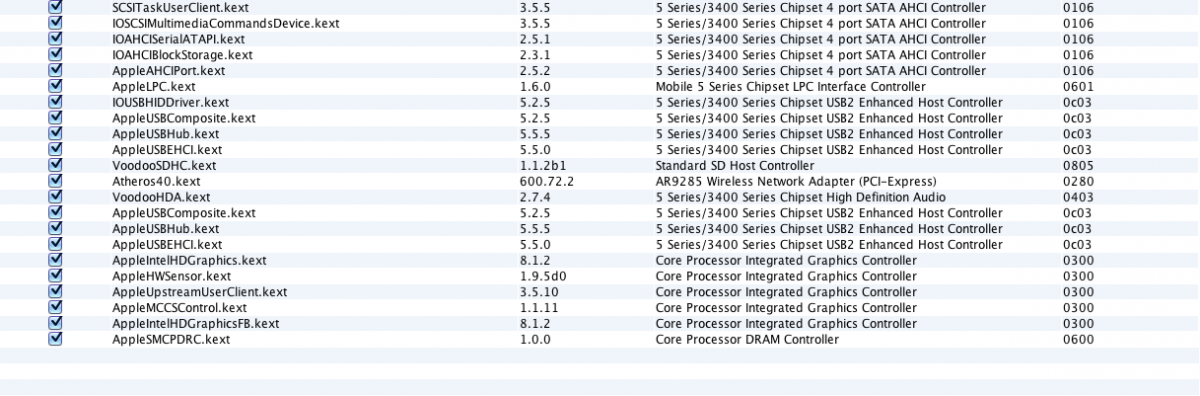

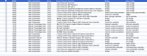

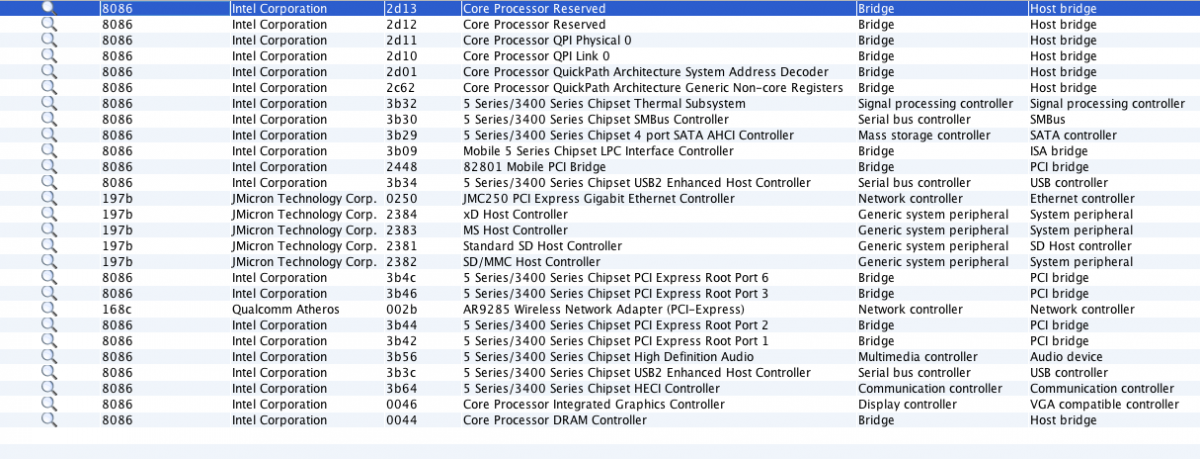

IntelMacGuy Posted August 31, 2013 Share Posted August 31, 2013 Hello, Thank you for your help. I'm running an ASUS K52F with a few issues. 1. It refuses to wake when put to sleep. 2. The fn keys are not functioning correctly. 3. Screen Brightness and battery doesn't work. 4. HDMI and VGA doesn't work. 5. Ethernet doesn't work. I attached my DSDT and system information to the thread. If I can get this all working I plan to add it to the wiki for others that have the same system. Thank you. Things I got working so far: 1. Got CE/QE working on laptop display. (Added DSDT edit to remove Natit.kext) 2. Sound working with custom VoodooHDA.kext (Not sure if it's possible to inject the codec into the DSDT without using voodoohda.) 3. Wifi is working with custom IO80211Family.kext 4. SD Card reader using VoodooSDHC. 5. Keyboard and mouse AppleACPIPS2Nub.kext and ApplePS2Controller.kext. dsdt.aml.zip Link to comment https://www.insanelymac.com/forum/topic/291562-i-am-offering-help-with-hackintoshes-installation-configuration-etc/#findComment-1942401 Share on other sites More sharing options...

IntelMacGuy Posted August 31, 2013 Share Posted August 31, 2013 Q: First of all, what version of OS X are yourunning. I need to know that before I can help you with anything else. A: 10.8.4 ML Q: Please clarify what "screen brightness and battery doesn't work" means. Do you mean you can't boot up without AC power? A: Sorry that's part of the fn keys to change the brightness of the display. Q: What happens when you try to use the HDMI/VGA port? Is anything displayed in DIsplay Settings? A: Nothing happens. I'm using: http://www.insanelymac.com/forum/topic/286092-guide-1st-generation-intel-hd-graphics-qeci/ for the graphics. We are currently look for someone that is good with hex edit to edit in HDMI and VGA out. Q: Sleep of death could be a BIOS setting or a Power Management configuration issue. Please post your power settings and make sure HPET is set to 64-bit in the BIOS. A: That option isn't available in my BIOS settings. I'll try that ethernet kext and see if that works. Thank you. Link to comment https://www.insanelymac.com/forum/topic/291562-i-am-offering-help-with-hackintoshes-installation-configuration-etc/#findComment-1942419 Share on other sites More sharing options...
