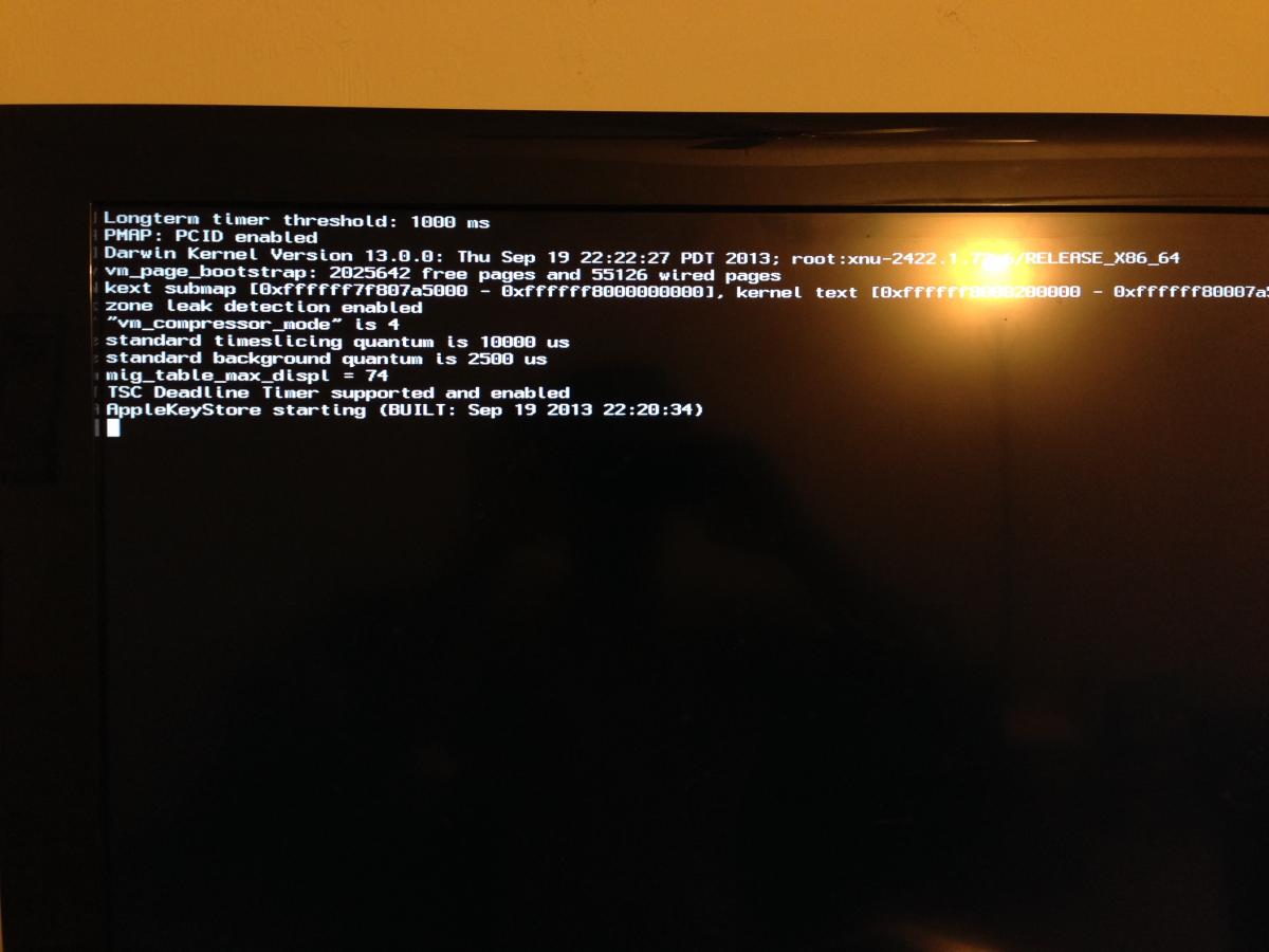

hinju Posted January 8, 2014 Share Posted January 8, 2014 Ok. Thanks for clearing that up. As of right now I have done every step instructed including patching the AICPUPM and adjusting all the settings in chameleon wizard. I have 3 questions as of right now. 1) I still can't boot. I posted a pick of where i get stuck, its very early on in the boot process. When I try to boot from my hdd and just holds there w.o actually giving me a KP. I have installed fakesmc and I do have dropssdt=yes. 2) How do I get an unpatched version of the AICPUPM to replace my current patched one. 3) How do I test to see if my computer and powermanagement are behaving properly? thanks! Link to comment Share on other sites More sharing options...
Pimentel Posted January 8, 2014 Share Posted January 8, 2014 Hello 1- It's seemed confusing, but... you need Remove PR_Scope drom DSDT and disable DropSSDT(DropSSDT=No or only don't check this) i had the same problem... 2- Each version OSX has a new version of AICPUPM... only way to get a unpatched AICPUM is getting original from untouched OSX... But why you want get a unpatched AICPUPM? 3-If you have Sleep/Wake and all states work... so you have power management Link to comment Share on other sites More sharing options...

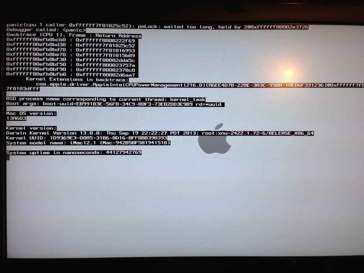

hinju Posted January 9, 2014 Share Posted January 9, 2014 Hey. So I went through DSDT. Theres no PR_Scope, but there was Scope(_PR) which i removed. I complied w.o errors and changed DropSSDT to no. Then i got the kernel panic seen in the picture related to AICPUPM. Sorry this is being such a pain to get running. I appreciate your help and patience though. So what's next boss? Link to comment Share on other sites More sharing options...
Pimentel Posted January 9, 2014 Share Posted January 9, 2014 Hello For me this work... so try enable DropSSDT(DropSSDT=Yes) Link to comment Share on other sites More sharing options...
hinju Posted January 9, 2014 Share Posted January 9, 2014 So i restored my computer using carbon copy. Turns out, with andy's installer, i'm not using nullcpu. I wasn't getting any more pstates, so i turned on GeneratePStates in chameleon wizard and now i get 6, and my computer seems to go between them easily. I still can't put the computer to sleep tho. I don't know how to test c states to know what c states i'm getting and if i'm going between them smoothly. I do appreciate all your help Pimentel so far. I guess our systems are just different enough. Any chance you can help me with my graphics card issues? Its properly recognized in system info, but i cannot get QE/CI support or change the resolution (i've even tried dsdt editing). I've tried a lot of different things. As long as graphicsenabler=yes the card is recognized. Otherwise i got nothing. Link to comment Share on other sites More sharing options...
