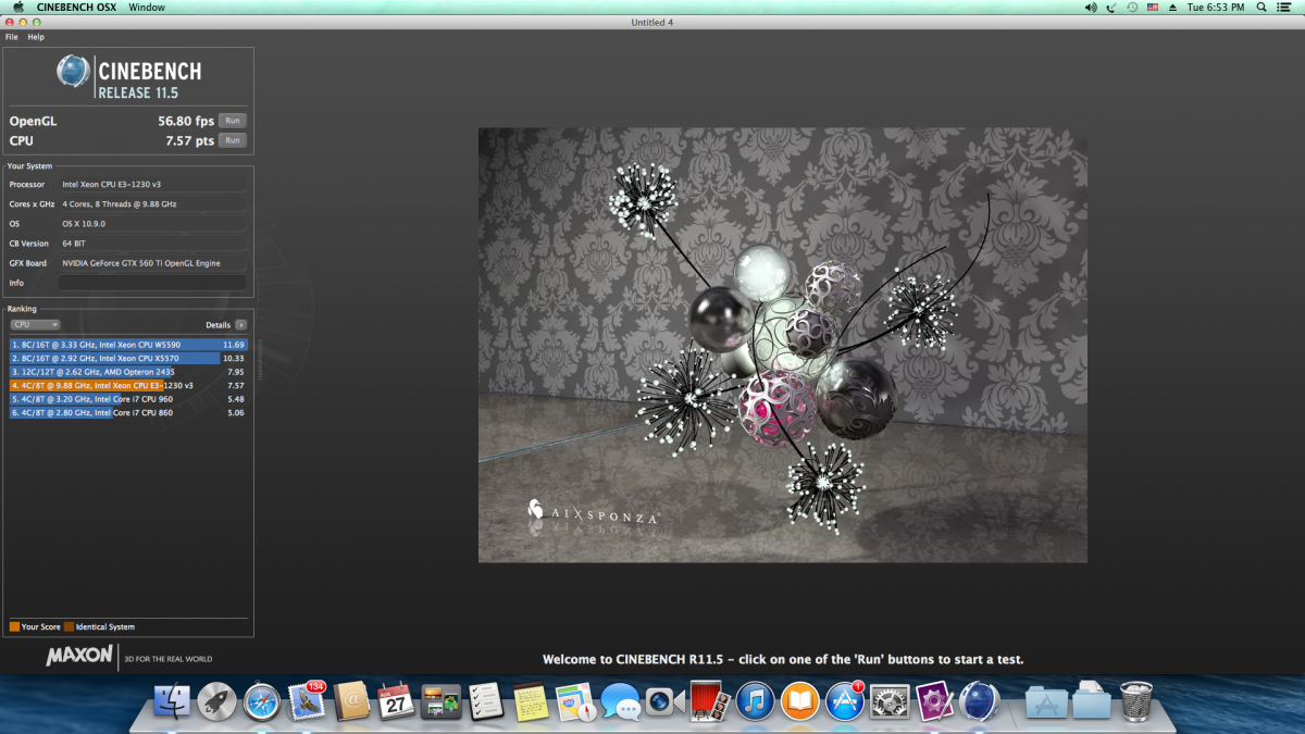

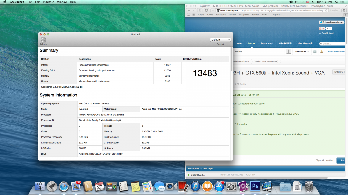

VladeK231 Posted August 27, 2013 Author Share Posted August 27, 2013 So this is my benchmark score. Not sure it's normal or low score. and my cinebench score: Link to comment https://www.insanelymac.com/forum/topic/291397-gigabyte-h87-d3h-gtx-560ti-intel-xeon-sound-vga-problem/#findComment-1941585 Share on other sites More sharing options...
