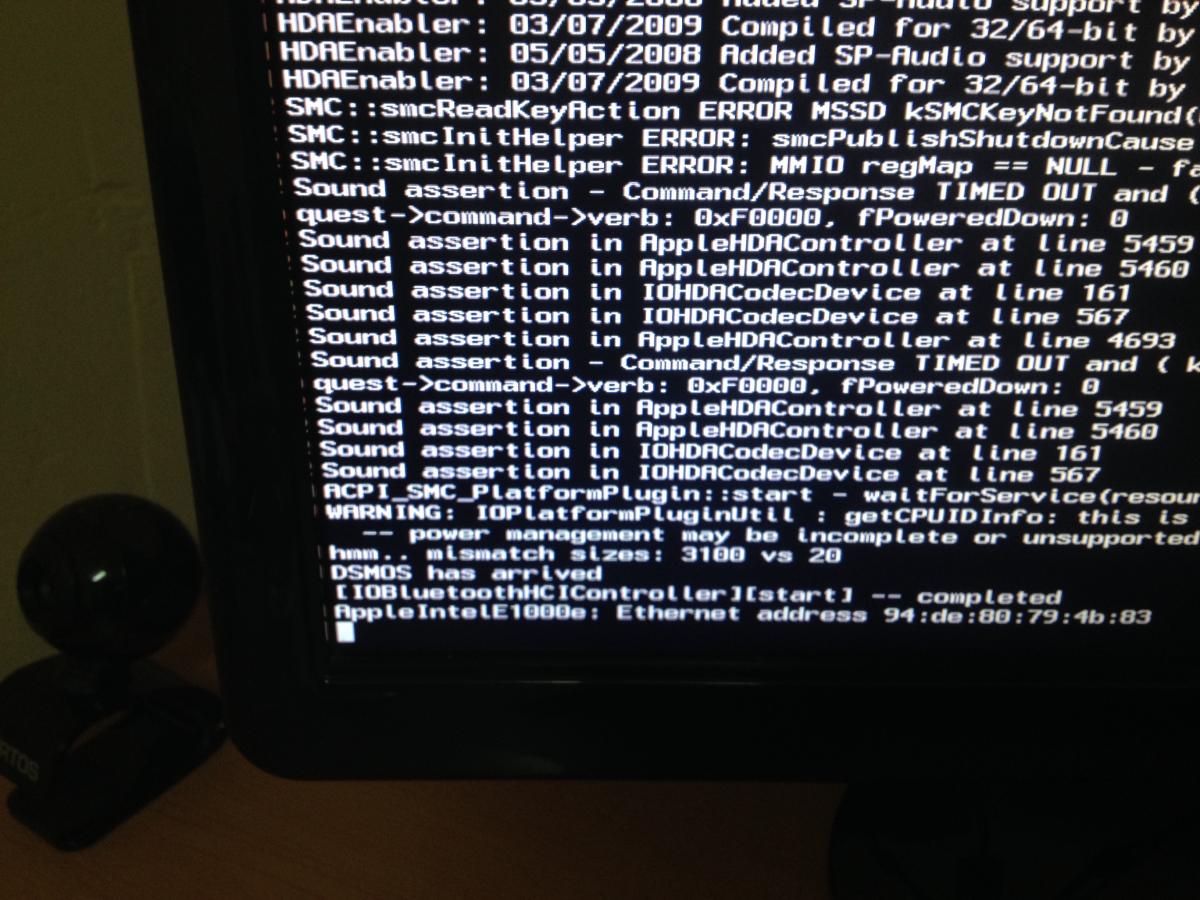

_ALI_ Posted August 10, 2013 Share Posted August 10, 2013 what this problem:S i have dsdt to inject ihave mobo h87 d3h i5 4570 ML 10.8.5 and 10.9 D5 Quote Link to comment https://www.insanelymac.com/forum/topic/291137-i-need-help-intel-hd-4600/ Share on other sites More sharing options...
freeuser16 Posted August 10, 2013 Share Posted August 10, 2013 If boot stops at Bluetooth, then definitely video card is not working. I heard HD4600 works with Clover bootloader + Mac Pro 5.1 SMBIOS without any DSDT modifications. But personally I do not have this card and I can't test it. Quote Link to comment https://www.insanelymac.com/forum/topic/291137-i-need-help-intel-hd-4600/#findComment-1938042 Share on other sites More sharing options...
TimeWalker75a Posted August 10, 2013 Share Posted August 10, 2013 Is your monitor VGA (D-SUB) by any chance? In case it is -> VGA is not natively supported by Azul framebuffer. I've tried to patch in the VGA connector into different platform-ids based on the previous knowledge (HD3000/HD4000), but I still have not succeeded in doing so. 1 Quote Link to comment https://www.insanelymac.com/forum/topic/291137-i-need-help-intel-hd-4600/#findComment-1938060 Share on other sites More sharing options...
theconnactic Posted August 10, 2013 Share Posted August 10, 2013 Even HD4000 is hell when it comes to VGA ports. Quote Link to comment https://www.insanelymac.com/forum/topic/291137-i-need-help-intel-hd-4600/#findComment-1938062 Share on other sites More sharing options...
_ALI_ Posted August 11, 2013 Author Share Posted August 11, 2013 so hd 4600 not work vga port? Quote Link to comment https://www.insanelymac.com/forum/topic/291137-i-need-help-intel-hd-4600/#findComment-1938148 Share on other sites More sharing options...
Cobra03 Posted August 11, 2013 Share Posted August 11, 2013 The only way to get VGA to work that i've found so far is to use Kernel flag -x and no DSDT. it will boot in safe mode but of course no acceleration. There is no VGA on real mac with HD4600. Quote Link to comment https://www.insanelymac.com/forum/topic/291137-i-need-help-intel-hd-4600/#findComment-1938154 Share on other sites More sharing options...
_ALI_ Posted August 11, 2013 Author Share Posted August 11, 2013 So how does it work for me? Quote Link to comment https://www.insanelymac.com/forum/topic/291137-i-need-help-intel-hd-4600/#findComment-1938156 Share on other sites More sharing options...
theconnactic Posted August 11, 2013 Share Posted August 11, 2013 It won't: either get a DVI monitor or buy a cheap Discrete Graphics card Such as the G 210. P.S. Sorry about the bad Spelling and wrong uppercases: I posted that with the dictation from my iPhone, lol! Quote Link to comment https://www.insanelymac.com/forum/topic/291137-i-need-help-intel-hd-4600/#findComment-1938171 Share on other sites More sharing options...
