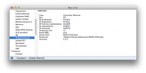

carbo178 Posted June 26, 2013 Share Posted June 26, 2013 Hi Giovanni, try this, http://www.insanelymac.com/forum/files/file/79-bcm5722d/ See description and see if Dev-id corresponds to your Good Hack Link to comment https://www.insanelymac.com/forum/topic/290155-broadcom-ethernet-bcm57781-kext-needed-for-109-dp2/#findComment-1927920 Share on other sites More sharing options...
giacomoleopardo Posted June 26, 2013 Author Share Posted June 26, 2013 Hi Giovanni, try this, http://www.insanelymac.com/forum/files/file/79-bcm5722d/ See description and see if Dev-id corresponds to your Good Hack Thanks Marco, but unfortunately I've already tried that with no success. I posted my results yesterday here. As Mieze told me, it will be necessary a patch from the original 10.9 DP2 kext. I'm definitely not the right guy for that, but I'll keep on trying. Link to comment https://www.insanelymac.com/forum/topic/290155-broadcom-ethernet-bcm57781-kext-needed-for-109-dp2/#findComment-1927950 Share on other sites More sharing options...

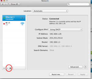

giacomoleopardo Posted June 26, 2013 Author Share Posted June 26, 2013 Well, it seems ethernet is connected, but I have to set manually DHCP address. Green light appears, then, but the internet browser doesn't work. Nevertheless, it allowed me to log into iMessage and FaceTime. Now, with WiFi I can get everything! BTW: In Mavericks DP 1/2 Power Management and HDMI audio (via DisplayPort in Apple Cinema Display) work without ssdt, dsdt or patched kexts. Added patched AppleHDA.kext for Internal Audio. Link to comment https://www.insanelymac.com/forum/topic/290155-broadcom-ethernet-bcm57781-kext-needed-for-109-dp2/#findComment-1927992 Share on other sites More sharing options...
Alex009988 Posted June 26, 2013 Share Posted June 26, 2013 Well, it seems ethernet is connected, but I have to set manually DHCP address. Green light appears, then, but the internet browser doesn't work. Nevertheless, it allowed me to log into iMessage and FaceTime. Now, with WiFi I can get everything! BTW: In Mavericks DP 1/2 Power Management and HDMI audio (via DisplayPort in Apple Cinema Display) work without ssdt, dsdt or patched kexts. Added patched AppleHDA.kext for Internal Audio. It is hard enough. But I will try to help you.. First of all make bin patch b416->b116 in all places and show me kernel.log after. Link to comment https://www.insanelymac.com/forum/topic/290155-broadcom-ethernet-bcm57781-kext-needed-for-109-dp2/#findComment-1928008 Share on other sites More sharing options...

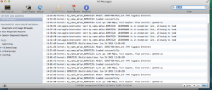

giacomoleopardo Posted June 26, 2013 Author Share Posted June 26, 2013 It is hard enough. But I will try to help you.. First of all make bin patch b416->b116 in all places and show me kernel.log after. Well thanks, really, but I'm a little short of knowledge about bin patch. Kernel log is about sudo dmesg right? Besides, Device ID is already 0x16b1 Link to comment https://www.insanelymac.com/forum/topic/290155-broadcom-ethernet-bcm57781-kext-needed-for-109-dp2/#findComment-1928018 Share on other sites More sharing options...
Alex009988 Posted June 26, 2013 Share Posted June 26, 2013 Use Well thanks, really, but I'm a little short of knowledge about bin patch. Kernel log is about sudo dmesg right? Try this one.(Made bin patch) I think it won't work because we must to disassemble driver and get to know what stoppes driver. Before it was getAdapterInfo Now I don't know. Console must show it. After open console -> all messages-> and find everything which is connected to 5701. For example Don't forget to add your id to the plist. Or more exactly replace 16b4 to 16b1 AppleBCM5701Ethernet.kext.zip Link to comment https://www.insanelymac.com/forum/topic/290155-broadcom-ethernet-bcm57781-kext-needed-for-109-dp2/#findComment-1928029 Share on other sites More sharing options...
giacomoleopardo Posted June 26, 2013 Author Share Posted June 26, 2013 ok, replaced 16b4 to 16b1 from your kext and replaced into IONetworkingFamily.kext/Contents/PlugIns EDIT: after removing BCM5722D.kext fro S/L/E, console gave me the same error and ethernet no longer detected Link to comment https://www.insanelymac.com/forum/topic/290155-broadcom-ethernet-bcm57781-kext-needed-for-109-dp2/#findComment-1928034 Share on other sites More sharing options...

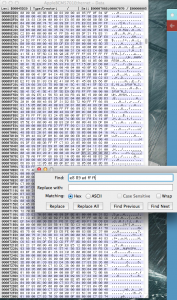

Alex009988 Posted June 26, 2013 Share Posted June 26, 2013 Don't know if it will work 0F 84 06 01 00 00->0F 85 06 01 00 00 0f8465010000 -> 0f8565010000 AppleBCM5701Ethernet.kext.zip Link to comment https://www.insanelymac.com/forum/topic/290155-broadcom-ethernet-bcm57781-kext-needed-for-109-dp2/#findComment-1928049 Share on other sites More sharing options...
giacomoleopardo Posted June 26, 2013 Author Share Posted June 26, 2013 Nope! Yesterday Mieze wrote me this, maybe it says something to you These are the instructions to patch the 10.8.3 kext. As the corresponding instructions will be at different locations in the code you need to locate them first in the disassembled code. Basic knowledge of x86 assembler is required. Change 7a8b: ba 2c 00 00 00 mov $0x2c,%edx 7a90: e8 bb 90 ff ff callq b50 <kmod_info-0x36138> 7a95: 66 89 83 92 04 00 00 mov %ax,0x492(%rbx) Into 7a8b: ba 2c 00 00 00 mov $0x2c,%edx 7a90: b8 e4 14 00 00 mov $0x14e4,%eax <--- Move the subsystem-vendor-id into AX 7a95: 66 89 83 92 04 00 00 mov %ax,0x492(%rbx) Change 7aa6: ba 2e 00 00 00 mov $0x2e,%edx 7aab: e8 a0 90 ff ff callq b50 <kmod_info-0x36138> 7ab0: 66 89 83 94 04 00 00 mov %ax,0x494(%rbx) Into 7aa6: ba 2e 00 00 00 mov $0x2e,%edx 7aab: b8 b4 16 00 00 mov $0x16b4,%eax <--- Move the subsystem-id into AX 7ab0: 66 89 83 94 04 00 00 mov %ax,0x494(%rbx) Change 7b24: ba 02 00 00 00 mov $0x2,%edx 7b29: e8 22 90 ff ff callq b50 <kmod_info-0x36138> 7b2e: 66 89 83 90 04 00 00 mov %ax,0x490(%rbx) Into 7b24: ba 02 00 00 00 mov $0x2,%edx 7b29: b8 b4 16 00 00 mov $0x16b4,%eax <--- Move the device-id into AX 7b2e: 66 89 83 90 04 00 00 mov %ax,0x490(%rbx) The routine callq is calling will be at a different location in the code so that the instruction code in hex will be different too. First you'll have to get a copy of GNU binutils, build from source, install and use objdump to disassemble the code. Then you can start searching the sequences. A simple binary match won't work. Without basic x86 assembler knowledge you'll have a hard time doing the patch because you need to understand what the routines are doing. The last mov instruction, which stores the values in variables will write to different locations too Hope this helps you to help me I attach my original Mavericks DP2 IONetworkingFamily.kext IONetworkingFamily.kext.zip Link to comment https://www.insanelymac.com/forum/topic/290155-broadcom-ethernet-bcm57781-kext-needed-for-109-dp2/#findComment-1928056 Share on other sites More sharing options...
Alex009988 Posted June 26, 2013 Share Posted June 26, 2013 Nope! Yesterday Mieze wrote me this, maybe it says something to you Hope this helps you to help me I attach my original Mavericks DP2 IONetworkingFamily.kext I can't find this data neither disassembler nor hexedit. Link to comment https://www.insanelymac.com/forum/topic/290155-broadcom-ethernet-bcm57781-kext-needed-for-109-dp2/#findComment-1928064 Share on other sites More sharing options...

Alex009988 Posted August 18, 2013 Share Posted August 18, 2013 Try to reestablish the connection. Minus after plus Also you can try to use EthernetBuitIn=Yes or patch of DSDT http://www.insanelymac.com/forum/topic/247470-bcm5722-bcm5754m-bcm5755m-bcm5787m-and-bcm5906m-nic-driver-3264-bit/?p=1918594 Perhaps driver must be adapted for your model. Give a response after these actions at the topic of BCM5722D I forgot to say if it wouldn't work after these actions. Go to about this Mac->more info-> and show us "Ethernet Cards" and "PCI Cards". Also make full DarwinDumper and show kernel log as well. Type "5722" and it will find necessary information on its own. Link to comment https://www.insanelymac.com/forum/topic/290155-broadcom-ethernet-bcm57781-kext-needed-for-109-dp2/#findComment-1939665 Share on other sites More sharing options...

Buckeyes1995 Posted August 26, 2013 Share Posted August 26, 2013 Thanks to the great work (as always) by Mieze, we now have a working Mavericks 10.9 BCM57781 driver. A binary patch is needed to the AppleBCM5701Ethernet.kext, as follows. Three changes are required to replace the NICs PCI configuration check. 613b: ba 2c 00 00 00 mov $0x2c,%edx 6140: e8 89 ad ff ff callq ece <__ZN11BCM5701Enet10superClassE-0x1f20a> 6145: 66 89 83 d2 04 00 00 mov %ax,0x4d2(%rbx) into 613b: ba 2c 00 00 00 mov $0x2c,%edx 6140: b8 e4 14 00 00 mov $0x14e4,%eax 6145: 66 89 83 d2 04 00 00 mov %ax,0x4d2(%rbx) and 6156: ba 2e 00 00 00 mov $0x2e,%edx 615b: e8 6e ad ff ff callq ece <__ZN11BCM5701Enet10superClassE-0x1f20a> 6160: 66 89 83 d4 04 00 00 mov %ax,0x4d4(%rbx) into 6156: ba 2e 00 00 00 mov $0x2e,%edx 615b: b8 b4 16 00 00 mov $0x16b4,%eax 6160: 66 89 83 d4 04 00 00 mov %ax,0x4d4(%rbx) as well as 605f: ba 02 00 00 00 mov $0x2,%edx 6064: e8 65 ae ff ff callq ece <__ZN11BCM5701Enet10superClassE-0x1f20a> 6069: 66 89 83 d0 04 00 00 mov %ax,0x4d0(%rbx) into 605f: ba 02 00 00 00 mov $0x2,%edx 6064: b8 b4 16 00 00 mov $0x16b4,%eax 6069: 66 89 83 d0 04 00 00 mov %ax,0x4d0(%rbx) In addition, be sure to add the card's ID pci14e4,16b1 into info.plist. <key>IONameMatch</key> <array> <string>pci14e4,1684</string> <string>pci14e4,16b0</string> <string>pci14e4,16b4</string> <string>pci14e4,1682</string> <string>pci14e4,1686</string> <string>pci14e4,16b1</string> </array> Please feel free to PM me for help. All thanks belong to Mieze! Link to comment https://www.insanelymac.com/forum/topic/290155-broadcom-ethernet-bcm57781-kext-needed-for-109-dp2/#findComment-1941319 Share on other sites More sharing options...
Alex009988 Posted August 26, 2013 Share Posted August 26, 2013 Buckeyes1995 Hi. Are you using 3.6.9 version of this driver? I can't find these patches on my driver Attached original Apple BCM5701Ethernet from Mavericks DP6 AppleBCM5701Ethernet.kext.zip Link to comment https://www.insanelymac.com/forum/topic/290155-broadcom-ethernet-bcm57781-kext-needed-for-109-dp2/#findComment-1941408 Share on other sites More sharing options...
