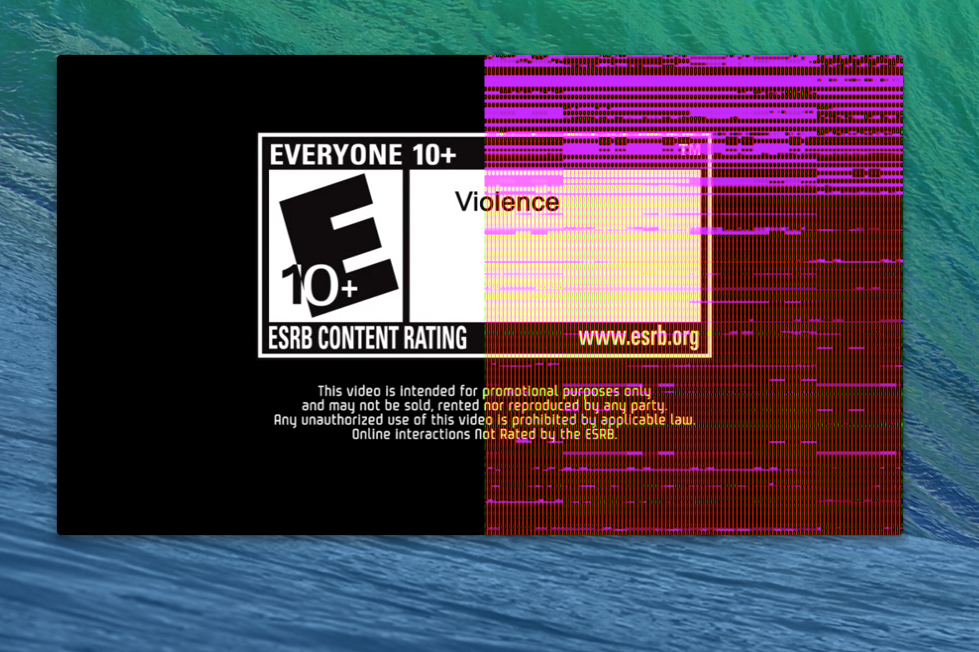

My 7970M is working well with full QE/CI. I only seem to have one general problem. Playing a video (HTML5 video) in Safari and viewing some images shows corruption in the video playback or viewing of the image. The same also happens when playing an mp4 in quicktime. But if I use firefox or chrome instead of Safari and play the same mp4 with VLC there is no corruption. I attached an example of the type of corruption in video playback using quicktime. The same kind of corruption is visible for images and videos in Safari and you can sometimes see random fuzzy text within the corrupted area. What do you think? A bug or issue with my installaton?

I think it is very likely this is a bug as it doesn't happen for me in ML.

Currently with the iMac13,2 profile the IOPlatform plugin kext is matching. I cannot get any MacBookPro SMBIOS to work. My system boots but it get's SUPER slow, takes about 15 mins just to get into graphical mode and then eventually it reboots. But iMac13,2 SMBIOS is working fine and in ML it has zero issues.
With MacPro5,1 SMBIOS im assuming AGPM is disabled but it still has the coruption issue.

So I edited IOPlatformPuginFamily and disabled AGPM for the iMac13,2 SMBIOS I am using. As you can see in the attached IOReg that AGPM is disabled but i still have the corruption with images and videos in Safari and QT.
Yes I see AGPM is disabled, but remember safari app will try to boost your Pstates with or without AGPM loaded because it is programed to do it to match your Smbios profile, to be sure just try what I did, create your own faked profile.
