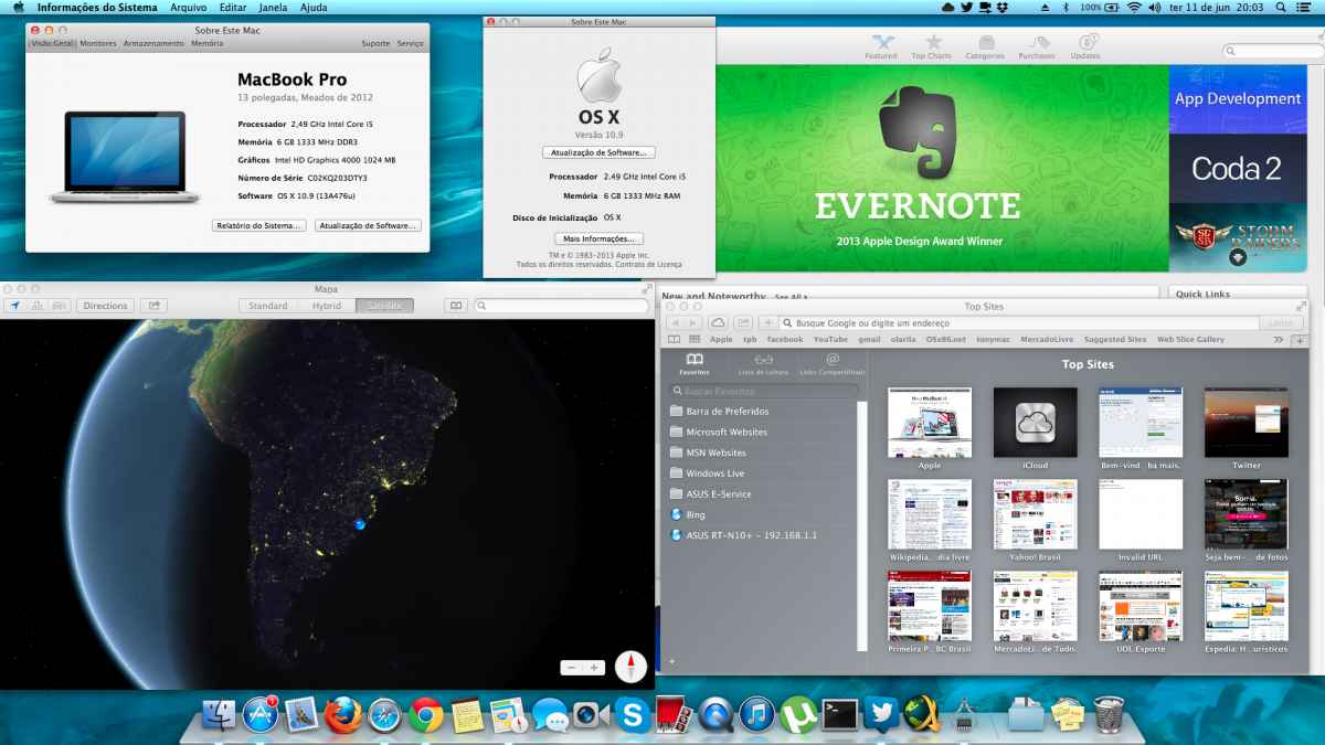

mendietinha Posted June 11, 2013 Share Posted June 11, 2013 System Specs:CPUS: Intel I5 3210M (2 Cores - 4 Threads 2.5~3.1)RAM: 6GB DDR3 1333VGA: Intel HD 4000 (Full QE CI) with 1024mb of vram!?Kexts Voodoohda, RealtekRTL81xx, PS2 for elan trackpadLatest Chameleon Bootloader, Extra Folder Mountain LionInstallation via USB to USB, after restore the usb install to the MBR Partition Table until the mbr patch cames out. 3 Link to comment https://www.insanelymac.com/forum/topic/289727-success-laptop-asus-k45a-core-i5-3210m-hd4000/ Share on other sites More sharing options...

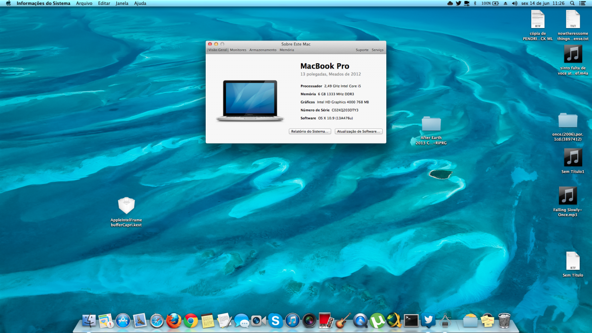

mendietinha Posted June 14, 2013 Author Share Posted June 14, 2013 It is set so in the driver, i have no idea why they did so, but all notebooks seem to be set to 1GB VRAM now. For ML i made a script that let you assign the VRAM you want, but is not tested on 10.9 yet, if you wonna try let me know. sure thing. let me test it Link to comment https://www.insanelymac.com/forum/topic/289727-success-laptop-asus-k45a-core-i5-3210m-hd4000/#findComment-1923898 Share on other sites More sharing options...
kpkp Posted June 14, 2013 Share Posted June 14, 2013 sure thing. let me test it sudo perl -pi -e 's|\x00.{1}\x10\x07\x00\x00\x10\x07|\x00\x??\x10\x07\x00\x00\x10\x07|g' ~/Desktop/AppleIntelFramebufferCapri.kext/Contents/MacOS/AppleIntelFramebufferCapri Change the ?? with the red number bellow to set the desired amount of VRAM: 10 = 256MB of RAM 18 = 384MB of RAM 20 = 512MB of RAM 30 = 768MB of RAM 40 = 1024MB of RAM 1. copy AppleIntelFramebufferCapri.kext to the desktop and make a backup of it 2. run the script in the terminal (dont forget to fill in the ??) 3. install the kext, rebuild caches (i would suggest kext wizard) 4. restart pray and let me know how it went 1 Link to comment https://www.insanelymac.com/forum/topic/289727-success-laptop-asus-k45a-core-i5-3210m-hd4000/#findComment-1923960 Share on other sites More sharing options...
mendietinha Posted June 14, 2013 Author Share Posted June 14, 2013 all good, my friend! it works! Link to comment https://www.insanelymac.com/forum/topic/289727-success-laptop-asus-k45a-core-i5-3210m-hd4000/#findComment-1924055 Share on other sites More sharing options...
