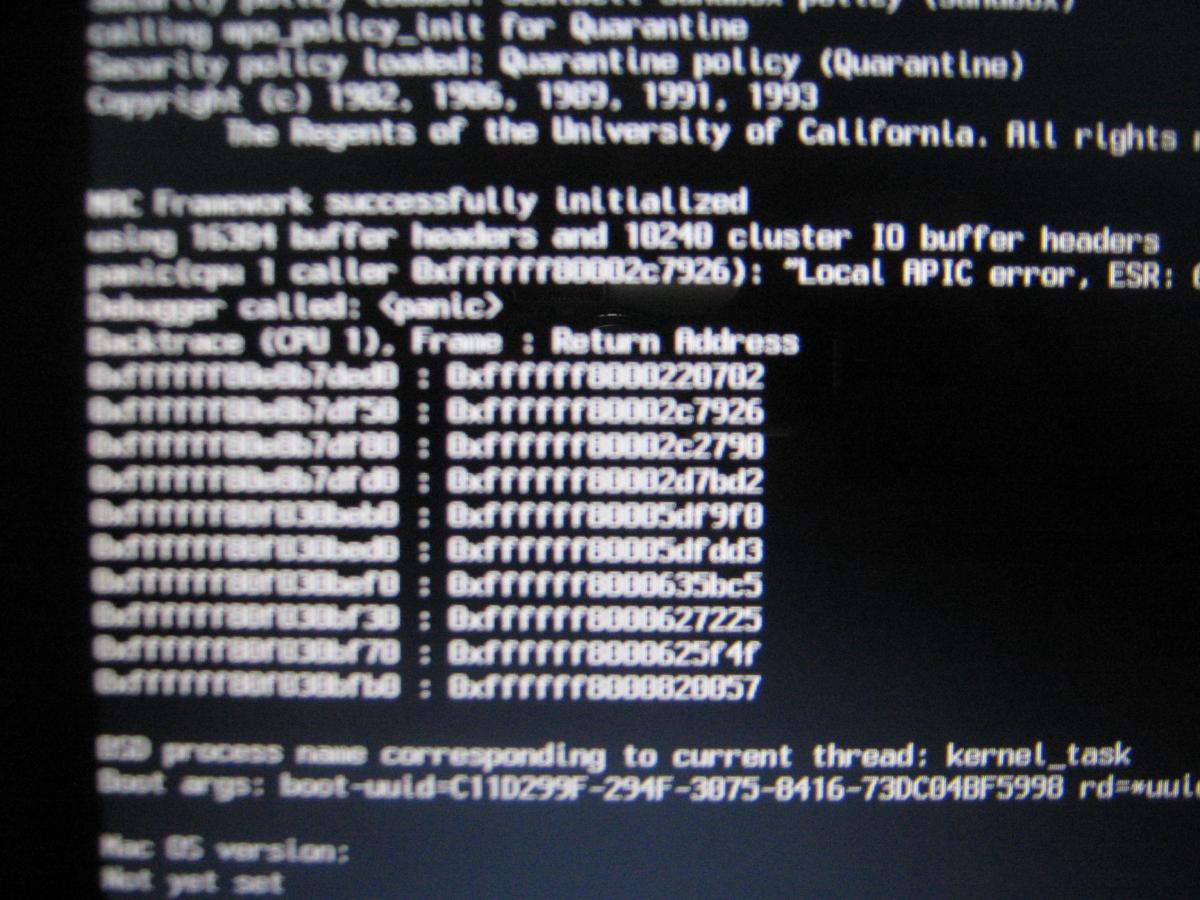

GiovaTrabuzz Posted May 7, 2013 Share Posted May 7, 2013 Ok, I have an Intel Core I5. I can' boot without cpus=1, so when i go to activity monitor it shows only one cpu working. I have already tried with VoodooTSCSync.kext but with no luck, in fact when it boots I get kernel panic. How can I solve this? Thanks Link to comment https://www.insanelymac.com/forum/topic/288396-how-to-fix-cpus1/ Share on other sites More sharing options...

carbo178 Posted May 7, 2013 Share Posted May 7, 2013 VoodooTSCSync is installed in /E/E or S/L/E? Post a pic of panic Link to comment https://www.insanelymac.com/forum/topic/288396-how-to-fix-cpus1/#findComment-1913431 Share on other sites More sharing options...
GiovaTrabuzz Posted May 7, 2013 Author Share Posted May 7, 2013 In S/L/E Link to comment https://www.insanelymac.com/forum/topic/288396-how-to-fix-cpus1/#findComment-1913434 Share on other sites More sharing options...

artur_pt Posted May 8, 2013 Share Posted May 8, 2013 hello have u try to use lapic_kernel ? http://www.osx86.net/downloads.php?do=file&id=3798 give it a try good hack Link to comment https://www.insanelymac.com/forum/topic/288396-how-to-fix-cpus1/#findComment-1913629 Share on other sites More sharing options...
GiovaTrabuzz Posted May 8, 2013 Author Share Posted May 8, 2013 Thank you so so so much )))) I tried to do that before but made a mistake.... Now I can boot with both the cpus Thank youuu :))) Link to comment https://www.insanelymac.com/forum/topic/288396-how-to-fix-cpus1/#findComment-1913633 Share on other sites More sharing options...
