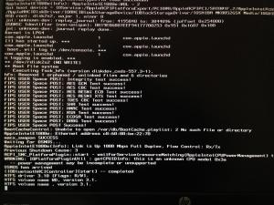

Damstas Posted May 3, 2013 Share Posted May 3, 2013 So I am stuck on Apple logo and spinning wheel, when I boot my machine. I just installed Mountain Lion from the USB stick. Installer and everything were fine, but now it's just stuck there. Seems to boot fine in safe mode.. hmm In attachment is the screen which I get when i boot with -v Hardware specs are: CPU Intel i5-3570k Motherboard Asus P877-V Pro No graphics card, only HD4000 Toshiba 80 GB hdd (Mountain Lion install) 128 GB Intel 330 series SSD 500 GB WD Caviar Blue Sata 3 8 GB of Corsair RAM Corsair AX 650 PSU Asus DVD-drive DRW-24B3LT Link to comment https://www.insanelymac.com/forum/topic/288308-stuck-on-apple-logo-and-spinning-wheel/ Share on other sites More sharing options...

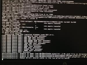

Damstas Posted May 3, 2013 Author Share Posted May 3, 2013 boot with -s and type this code for mv Graphics kexts to root of you hard disk, then boot with : -f -v GraphicsEnabler=No npci=0x2000 fsck -fy mount -uw / mkdir /kext_backup cd /System/Library/Extensions mv AMDRadeon* ATI* GeForce* NVDA*/kext_backup rm ../Caches/com.apple.kext.caches/Startup/kernelcache reboot Hi. I'm pretty newbie in this so: I booted with -s and then I started typing these things on green color. I pressed enter after every line. Then I booted with -f -v GraphicsEnabler=No npci=0x2000 and got picture what is in the attachment. Do you have any kext in your extra folder? How can I check that? Link to comment https://www.insanelymac.com/forum/topic/288308-stuck-on-apple-logo-and-spinning-wheel/#findComment-1912368 Share on other sites More sharing options...
iFIRE Posted May 3, 2013 Share Posted May 3, 2013 you have put of Extra folder in the root of your hard disk ? have FakeSMC.kext in the Extra/Extensions or S/L/E ? try boot with only: -v -x and post photo where this stop 1 Link to comment https://www.insanelymac.com/forum/topic/288308-stuck-on-apple-logo-and-spinning-wheel/#findComment-1912373 Share on other sites More sharing options...

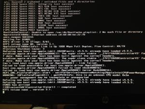

Damstas Posted May 3, 2013 Author Share Posted May 3, 2013 I reinstalled and did the everything again, and this is what it shows. So I'm going to try your method now. Is there any guide available to that? Link to comment https://www.insanelymac.com/forum/topic/288308-stuck-on-apple-logo-and-spinning-wheel/#findComment-1912412 Share on other sites More sharing options...
iFIRE Posted May 3, 2013 Share Posted May 3, 2013 DELETE the graphics kexts, you have read my above post? Link to comment https://www.insanelymac.com/forum/topic/288308-stuck-on-apple-logo-and-spinning-wheel/#findComment-1912414 Share on other sites More sharing options...

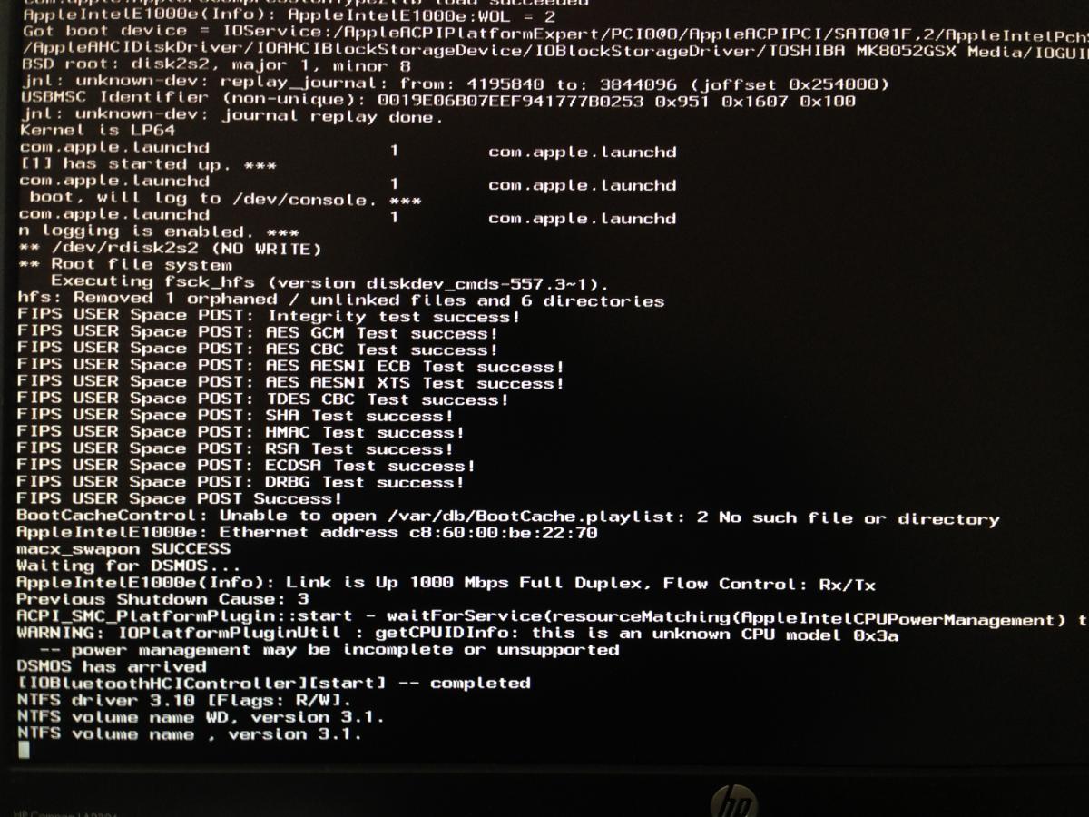

iFIRE Posted May 3, 2013 Share Posted May 3, 2013 man, if you have the system installed in your hard disk and you can not boot the system, you need delete the graphics kexts for this work and you arrive on the desktop, delete this kexts from S/L/E you can use Mac Drive from windows or use the code that I post, reinstall not resolve your problem with any installer, the problem is not the installer.then reboot with this flag= -f -v -x GraphicsEnabler=No npci=0x2000 ATI - ATI2400Controller.kext - ATI2600Controller.kext - ATI3800Controller.kext - ATI4600Controller.kext - ATI4800Controller.kext - ATI5000Controller.kext - ATI6000Controller.kext - ATIFramebuffer.kext - ATIRadeonX2000.kext - ATIRadeonX2000GA.plugin - ATIRadeonX2000GLDriver.bundle - ATIRadeonX2000VADriver.bundle - ATISupport.kext Nvidia - GeForce.kext - GeForceGA.plugin - GeForceGLDriver.bundle - GeForceVADriver.bundle - NVDAGF100Hal.kext - NVDAGK100Hal.kext - NVDANV50Hal.kext - NVDAResman.kext - NVSMU.kext AMD - AMDRadeonAccelerator.kext - AMDRadeonVADriver.bundle - AMDRadeonX3000GLDriver.bundle Link to comment https://www.insanelymac.com/forum/topic/288308-stuck-on-apple-logo-and-spinning-wheel/#findComment-1912421 Share on other sites More sharing options...
Damstas Posted May 3, 2013 Author Share Posted May 3, 2013 man, if you have the system installed in your hard disk and you can not boot the system, you need delete the graphics kexts for this work and you arrive on the desktop, delete this kexts from S/L/E you can use Mac Drive from windows or use the code that I post, reinstall not resolve your problem with any installer, the problem is not the installer.then reboot with this flag= -f -v -x GraphicsEnabler=No npci=0x2000 ATI - ATI2400Controller.kext - ATI2600Controller.kext - ATI3800Controller.kext - ATI4600Controller.kext - ATI4800Controller.kext - ATI5000Controller.kext - ATI6000Controller.kext - ATIFramebuffer.kext - ATIRadeonX2000.kext - ATIRadeonX2000GA.plugin - ATIRadeonX2000GLDriver.bundle - ATIRadeonX2000VADriver.bundle - ATISupport.kext Nvidia - GeForce.kext - GeForceGA.plugin - GeForceGLDriver.bundle - GeForceVADriver.bundle - NVDAGF100Hal.kext - NVDAGK100Hal.kext - NVDANV50Hal.kext - NVDAResman.kext - NVSMU.kext AMD - AMDRadeonAccelerator.kext - AMDRadeonVADriver.bundle - AMDRadeonX3000GLDriver.bundle Yeah, but how do I delete graphic kexts from S/L/E? I have never ever heard about those since this date! Link to comment https://www.insanelymac.com/forum/topic/288308-stuck-on-apple-logo-and-spinning-wheel/#findComment-1912423 Share on other sites More sharing options...
iFIRE Posted May 3, 2013 Share Posted May 3, 2013 yes, my English is very bad, but you read my previous post? or not read any? you need delete the graphics kexts for this work and you arrive on the desktop, delete this kexts from S/L/E , you can use Mac Drive from windows for delete it, or use the code that I post line by line and ENTER, or this is very difficult for you? Link to comment https://www.insanelymac.com/forum/topic/288308-stuck-on-apple-logo-and-spinning-wheel/#findComment-1912427 Share on other sites More sharing options...
Damstas Posted May 3, 2013 Author Share Posted May 3, 2013 I figured out what you meant. I deleted those kexts via MacDrive. And booted up the system with flags, and it booted up to set up your mac! So I guess it is now ok. You rock! Thank you so much! EDIT: Still spins the wheel and the apple logo is there when i select USB when i boot and then mountain lion. Link to comment https://www.insanelymac.com/forum/topic/288308-stuck-on-apple-logo-and-spinning-wheel/#findComment-1912433 Share on other sites More sharing options...
