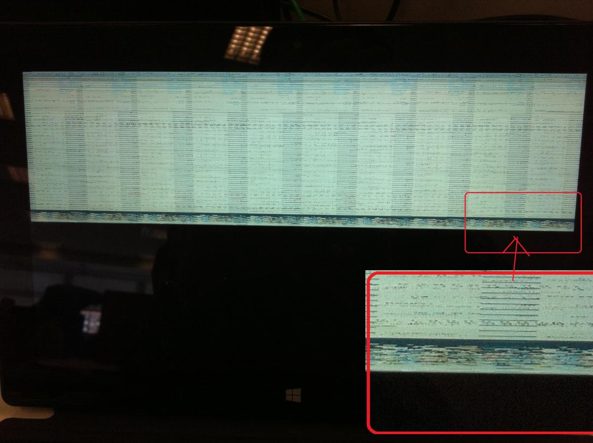

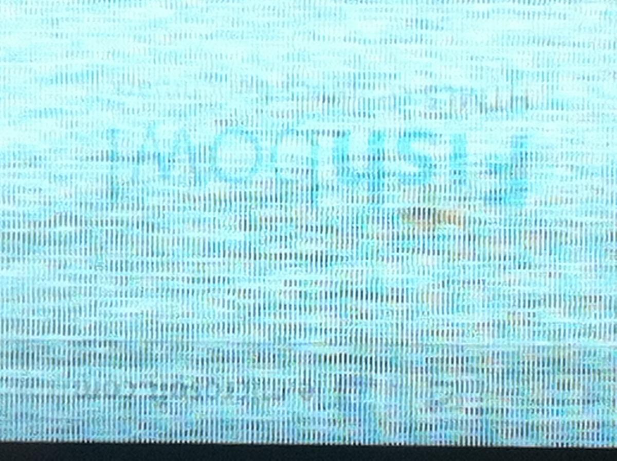

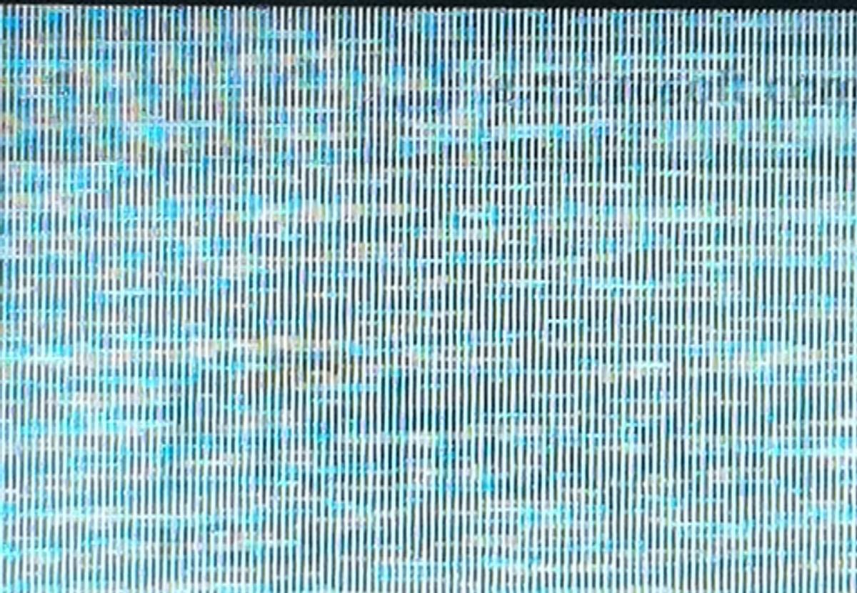

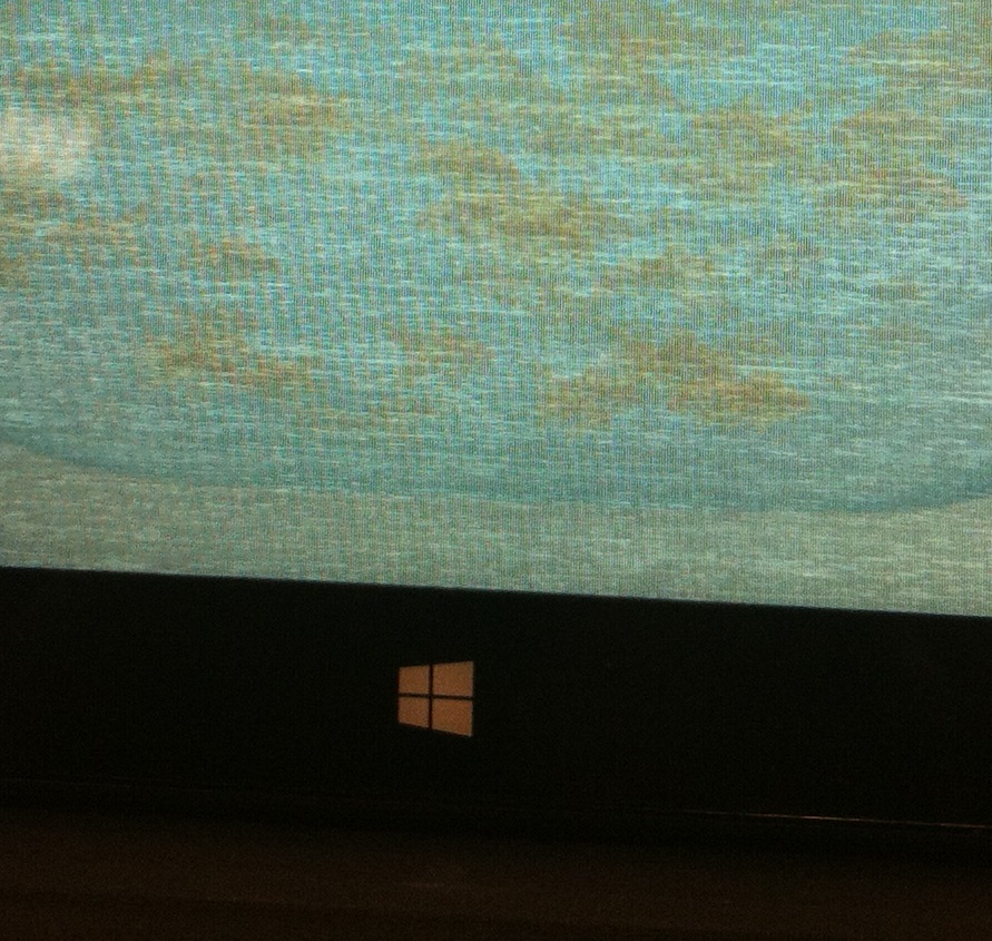

wbpluto Posted April 2, 2013 Share Posted April 2, 2013 Hi Guys, I am trying to run OS X on Surface Pro natively through Clover UEFI, not in VM. Now, the biggest problem is HD4000 with heavy grayed snow effect (and QE/CI/AirPlay/Brightness is supported)...It's so strange, and how to resolve this problem? Who can help me to resolve it? I have recorded a video for this:http://v.youku.com/v_show/id_XNTM2ODM1NDEy.html acpi_dsdt-SurfacePro-fromAIDA64.zip 1 Link to comment https://www.insanelymac.com/forum/topic/287592-why-hd4000-on-surface-pro-with-heavy-snow-effect/ Share on other sites More sharing options...

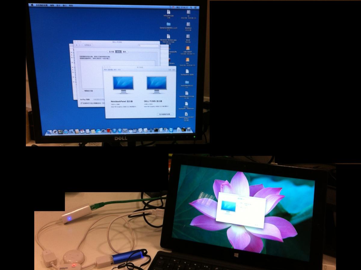

wbpluto Posted April 7, 2013 Author Share Posted April 7, 2013 test if this work for you, put in Extra Patched DSDT.zip Awsome! It really WORKS! I cannot thank you more~~~ The only problem: external display is primary with dock, and internal display is seconary, how to resolve it? 1 Link to comment https://www.insanelymac.com/forum/topic/287592-why-hd4000-on-surface-pro-with-heavy-snow-effect/#findComment-1904551 Share on other sites More sharing options...
iFIRE Posted April 7, 2013 Share Posted April 7, 2013 look in System Preferences/Display and change this Link to comment https://www.insanelymac.com/forum/topic/287592-why-hd4000-on-surface-pro-with-heavy-snow-effect/#findComment-1904585 Share on other sites More sharing options...
wbpluto Posted April 8, 2013 Author Share Posted April 8, 2013 look in System Preferences/Display and change this thanks, but why FrameBuffer0(Internal display) is secondary, and FrameBuffer1 (External) is primary display? May I fix it in DSDT? BTW, I found that your DSDT.aml just work while external MiniDisplayPort is connected before launch, if there's only internal display, the screen will be only just top half with many horizontal lines. just like this picture: Link to comment https://www.insanelymac.com/forum/topic/287592-why-hd4000-on-surface-pro-with-heavy-snow-effect/#findComment-1904716 Share on other sites More sharing options...

iFIRE Posted April 8, 2013 Share Posted April 8, 2013 FBRotate.app.zip Edit. Post your Extra folder and a full report with Darwin Dumper app Link to comment https://www.insanelymac.com/forum/topic/287592-why-hd4000-on-surface-pro-with-heavy-snow-effect/#findComment-1904811 Share on other sites More sharing options...

wbpluto Posted April 13, 2013 Author Share Posted April 13, 2013 wbpluto, can you please send your clover config.plist and dsdt.aml and kext in EFI/kexts/10.8 . Thanks Any config.plist is OK I think, DSDt.aml is iFRIE one, EFI/kexts no any files. Link to comment https://www.insanelymac.com/forum/topic/287592-why-hd4000-on-surface-pro-with-heavy-snow-effect/#findComment-1906607 Share on other sites More sharing options...
iFIRE Posted April 13, 2013 Share Posted April 13, 2013 now I inject EDID in your DSDT, I look in your kextload and the system not load the AIFramenbuferCapry.kext, I suggest to you delete all ATI* NVDA* GeForce*kexts PatchedSurface.zip Link to comment https://www.insanelymac.com/forum/topic/287592-why-hd4000-on-surface-pro-with-heavy-snow-effect/#findComment-1906613 Share on other sites More sharing options...

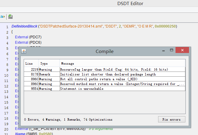

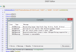

wbpluto Posted April 14, 2013 Author Share Posted April 14, 2013 now I inject EDID in your DSDT, I look in your kextload and the system not load the AIFramenbuferCapry.kext, I suggest to you delete all ATI* NVDA* GeForce*kexts PatchedSurface.zip Sorry, I noticed youhave made some mistakes in your DSDT.aml, so it was not work, for example, you added a new _DSM method out of the scope of IGPU. And After I open the aml file in DSDT Editor, it reported there are some warnings of the file. After all, thanks for your kind again so much! Link to comment https://www.insanelymac.com/forum/topic/287592-why-hd4000-on-surface-pro-with-heavy-snow-effect/#findComment-1906869 Share on other sites More sharing options...
wbpluto Posted April 16, 2013 Author Share Posted April 16, 2013 HI, iFIRE, I found that although Internal display didn't work correctly without External display connected before launch, but if I switch the rotation to 90/180/270 degrees, it will be extremely OK! If I switch it back to 0 degree, it go back to didn't work. Maybe it is a pregnant discovery. Do you have some advice on this? Link to comment https://www.insanelymac.com/forum/topic/287592-why-hd4000-on-surface-pro-with-heavy-snow-effect/#findComment-1907729 Share on other sites More sharing options...
iFIRE Posted April 16, 2013 Share Posted April 16, 2013 the warning is not important, is only warnings not errors, if you switch rotation and this work, you can make a script and add it in launch app in SP/Accounts, and the internal display can be a problem with EDID of your display, I inject it but appears that not work with this fix. EDIT. Take a look in it, if the rotation work for you from terminal app, we can make a script and add this for launch with the system,is very easy, test with terminal comands, and see that work for you. A Unix Utility to Change the Primary Display on OSX Link to comment https://www.insanelymac.com/forum/topic/287592-why-hd4000-on-surface-pro-with-heavy-snow-effect/#findComment-1907739 Share on other sites More sharing options...
