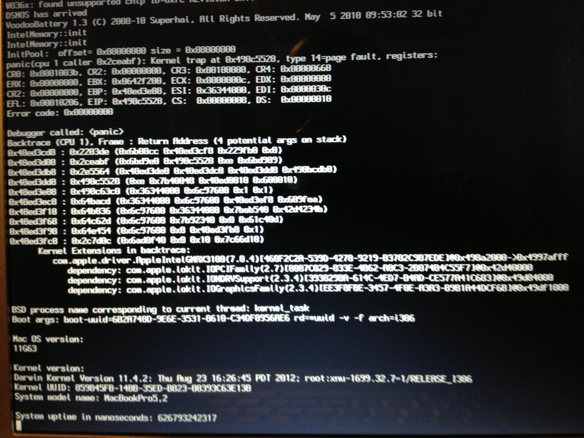

telasdad Posted March 25, 2013 Author Share Posted March 25, 2013 heres my current kernel panic, help? Link to comment https://www.insanelymac.com/forum/topic/287367-help-with-inspirion-1525-on-1075-plz/#findComment-1900655 Share on other sites More sharing options...
LatinMcG Posted March 25, 2013 Share Posted March 25, 2013 x3100 issue.likely u need to rollback ioplatform or iopci kext and likely the x3100 older ones. try booting in i386 not 64 im wqonderign how slice got his to work. likely clover autopatched. Link to comment https://www.insanelymac.com/forum/topic/287367-help-with-inspirion-1525-on-1075-plz/#findComment-1900723 Share on other sites More sharing options...
telasdad Posted March 25, 2013 Author Share Posted March 25, 2013 that was i386.... the 10.7.4 and 10.7.5 is.... strange to say at the least.. kernel panic after kernel panic..... like they were loaded with popcorn for how they keep popping up.. Link to comment https://www.insanelymac.com/forum/topic/287367-help-with-inspirion-1525-on-1075-plz/#findComment-1900890 Share on other sites More sharing options...

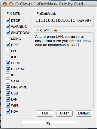

Slice Posted March 26, 2013 Share Posted March 26, 2013 Hi, I have perfectly working Dell Inspiron 1525 but I am using 10.6.8 because it is enough for me and no time to upgrade. The bootloader is Clover and Clover was tuned to be perfect namely for 1525. Some rules: 1. Model must be MacBook4,1. It is not MacBookPro5,2! Sleep/Wake, restart, shutdown depend on IOPlatform.plist that I manually tuned. 2. X3100 graphics 32bit only. I know there was a driver from 10.6.2 that works in 64bit. But those driver is quirky. Don't use it! Use IA32. 3. The framebuffer driver depends on SMC keys RPlt and EPCI. If these keys set wrongly you will have KP. My advice: use FakeSMC 3.3.1 with my settings. 4. There are two models of Inspiron 1525: with 1280x800 matrix and 1440x900 matrix (in my case). Second case AAPL,DualLink=1, not sure about first case. 5. All functionality depends on DSDT. Clover is very good tuned to make you good DSDT. See my report and you find here all my tunings. DarwinDumper_2.6.5_Clover_IA32_1147_1149_SL_root.zip Additionally I can say that I used some patched or third-party kexts: 16 4 0x2e840000 0x7000 0x6000 org.netkas.FakeSMC (3.3.1) <13 7 5 4 3> 17 0 0x2e7c4000 0x3000 0x2000 org.slice.PC8739x (1) <16 7 5 4 3> 19 0 0x2e9d4000 0x3000 0x2000 org.slice.HWInfo (1) <16 7 4 3> 20 0 0x2ea27000 0x5000 0x4000 org.slice.IntelCPUMonitor (1.1) <16 7 5 4 3> 30 0 0x2eb24000 0x3000 0x2000 com.yourcompany.driver.AppleACPIPS2Nub (1.0.0d1) <13 7 5 4 3 1> 48 0 0x34975000 0x4000 0x3000 org.voodoo.VoodooSDHC (1.1.2b1) <21 14 5 4 3 1> 56 0 0x34983000 0x4000 0x3000 org.voodoo.driver.PS2Keyboard (1.1.2) <33 5 4 3> 66 0 0x34cc5000 0x3000 0x2000 org.slice.sensor.X3100 (1.0) <16 14 4 3> 80 0 0x2e629000 0x8000 0x7000 org.voodoo.driver.PS2Trackpad (1.1.2) <33 5 4 3> 85 0 0x34f6e000 0x1e000 0x1d000 org.voodoo.driver.VoodooHDA (2.8.2) <84 14 7 5 4 3> 1 Link to comment https://www.insanelymac.com/forum/topic/287367-help-with-inspirion-1525-on-1075-plz/#findComment-1900977 Share on other sites More sharing options...
