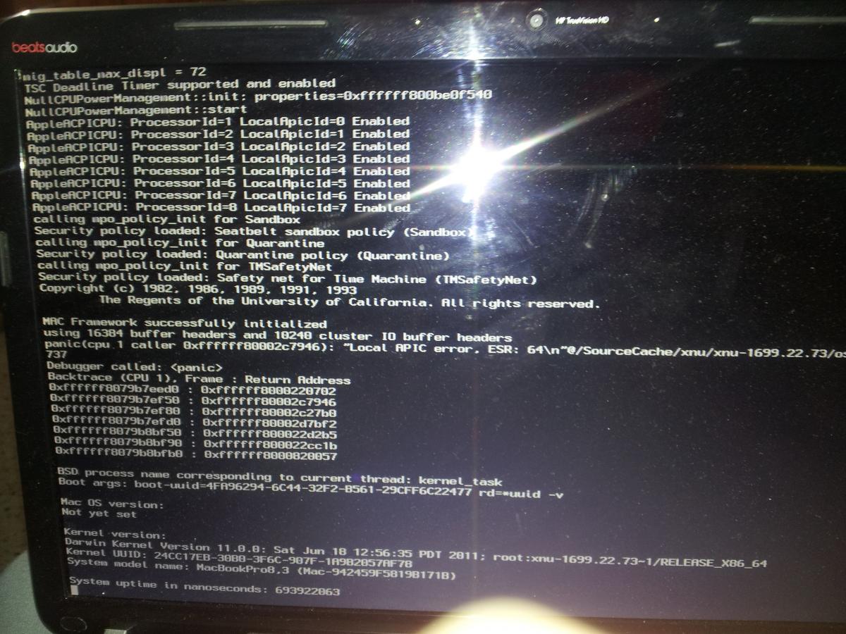

Hamoda Posted March 20, 2013 Share Posted March 20, 2013 Hello there I've HP DV6-6C50Se notebook with these specs: Microprocessor: 2.2 GHz Intel Core i7-2670QM, Sandybridge Microprocessor Cache: 6 MB L3 cache Memory: 4 GB DDR3 (not 1333) Memory Max: Supports up to 8 GB DDR3 Video Graphics: AMD Radeon HD 7690M XT (2 GB DDR5 dedicated) Display: 39,6 cm (15,6") HD LED BrightView (1366 x 768) () Hard Drive: 750 GB SATA Multimedia Drive: SuperMulti DVD±R/RW with Double Layer Support Network Card: Integrated 10/100/1000 Gigabit Ethernet LAN Wireless Connectivity: Bluetooth with WiDi, Intel 802.11 b/g/n Sound: Beats Audio Keyboard: Full size with integrated numeric keypad Pointing Device: TouchPad with on/off button and support for multitouch gestures PC Card Slots: Multi-Format Digital Media Card Reader I've Mac OS X Lion 10.7.dmg image, to install it I've followed this guide: http://www.insanelym...-for-beginners/ But I can't install it at all, every time it shows a message in 4 languages to shutdown the computer by holding down the power button. Hint: I choose Mac Pro (8,3) from Chameleon wizard which is compatible with my notebook specs except the RAM which is not 1333 on mine. So any one could help me, or at least tell me what is the problem? Link to comment https://www.insanelymac.com/forum/topic/287225-mac-os-x-lion-107-on-hp-dv6-6c50se-installation-problem/ Share on other sites More sharing options...
eep357 Posted March 20, 2013 Share Posted March 20, 2013 That is called a "kernel panic". In order to diagnose the cause, you will need to use verbose boot which will enable boot logging and additional error logging after boot as well. Use -v flag at the bootloader prompt to enable verbose boot and if/when it kernel panics again, take a picture with camera and post it for any help. until then....I dunno what's wrong any more than you do. Link to comment https://www.insanelymac.com/forum/topic/287225-mac-os-x-lion-107-on-hp-dv6-6c50se-installation-problem/#findComment-1898932 Share on other sites More sharing options...
Hamoda Posted March 20, 2013 Author Share Posted March 20, 2013 That is called a "kernel panic". In order to diagnose the cause, you will need to use verbose boot which will enable boot logging and additional error logging after boot as well. Use -v flag at the bootloader prompt to enable verbose boot and if/when it kernel panics again, take a picture with camera and post it for any help. until then....I dunno what's wrong any more than you do. Thanks for the quick response, note that this error message contains no details, it's just the Power logo with 4 messages but I'll attach a picture of it as soon as I finish my work. Now lets move to the verbose boot, you know I'm a newbie here and I appreciate any more details or tutorials for this. Link to comment https://www.insanelymac.com/forum/topic/287225-mac-os-x-lion-107-on-hp-dv6-6c50se-installation-problem/#findComment-1898936 Share on other sites More sharing options...
eep357 Posted March 20, 2013 Share Posted March 20, 2013 I don't need to see "please restart your computer" in multiple languages verbose boot first, then take picture if it happens again (you won't get the same "restart" screen but instead a crash log will be stuck on the screen this time). to verbose boot, start computer and the first screen that loads after the BIOS where it says something about booting Mac OSX and maybe a short timer before it will continue on....type -v and hit enter. If that sounds complicated, it's OK, but please do a little reading up on the basics before you continue. BTW, not sure that your AMD GPU can be made to work, but if so, it will require OSX 10.8.3. Any older version is guaranteed not to support AMD 7xxxx series graphics Link to comment https://www.insanelymac.com/forum/topic/287225-mac-os-x-lion-107-on-hp-dv6-6c50se-installation-problem/#findComment-1899002 Share on other sites More sharing options...

Hamoda Posted March 20, 2013 Author Share Posted March 20, 2013 I've managed to pass this Kernel Panic and go through the installation process by using "cpus=1", but after the "Select Language" window, I stuck at another error window with 4 options: Restart, Shutdown, Save Error Log, View Error Log. I've managed to save this Log and attached it here. Installer Log 20-Mar-2013.txt Link to comment https://www.insanelymac.com/forum/topic/287225-mac-os-x-lion-107-on-hp-dv6-6c50se-installation-problem/#findComment-1899102 Share on other sites More sharing options...
