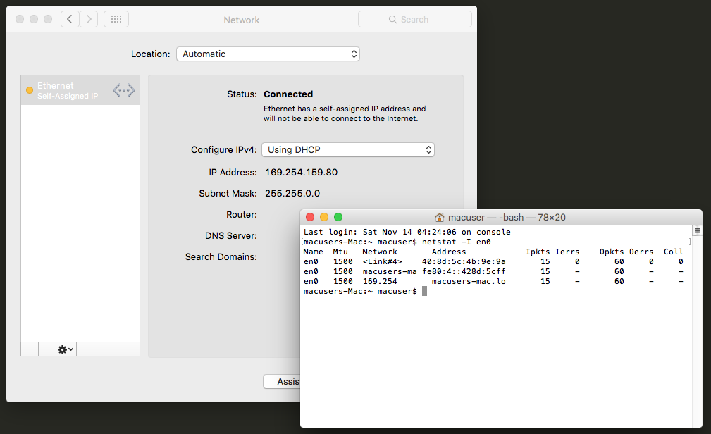

Mieze Posted November 13, 2015 Author Share Posted November 13, 2015 my complete one-time-boot systemlog The log entries are ok, no errors, the interface detects the link. Everything looks fine. In order to find out why DHCP isn't working use netstat -I en0 in Terminal to check if the numbers of received and transmitted packets are increasing in time and report back. Mieze Link to comment https://www.insanelymac.com/forum/topic/287161-new-driver-for-realtek-rtl8111/page/40/#findComment-2188119 Share on other sites More sharing options...

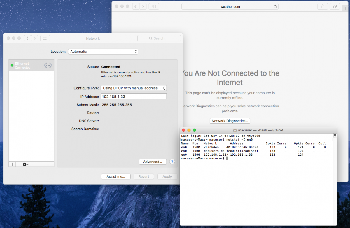

Kr3m1in Posted November 13, 2015 Share Posted November 13, 2015 Here you go, Mieze. Included is my system log as well as screenshots of the networking pane in System Preferences and the output of netstat -I en0. System Log & Screenshots.zip Link to comment https://www.insanelymac.com/forum/topic/287161-new-driver-for-realtek-rtl8111/page/40/#findComment-2188133 Share on other sites More sharing options...

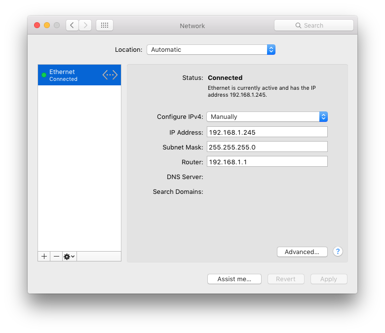

drshader Posted November 13, 2015 Share Posted November 13, 2015 Screenshots with auto DHCP and assigned IP. Not too much info... Link to comment https://www.insanelymac.com/forum/topic/287161-new-driver-for-realtek-rtl8111/page/40/#findComment-2188134 Share on other sites More sharing options...

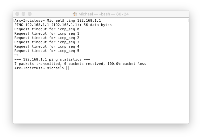

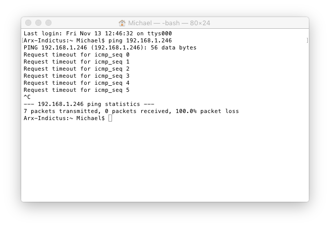

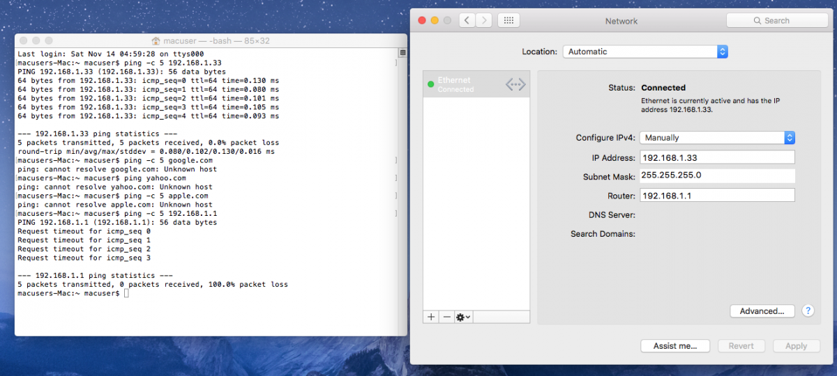

Mieze Posted November 13, 2015 Author Share Posted November 13, 2015 Strange, the numbers are increasing. Please configure IP address, subnet mask, etc. manually. Try to ping a machine in your network, for example the router. Does the ping succeed? Mieze Link to comment https://www.insanelymac.com/forum/topic/287161-new-driver-for-realtek-rtl8111/page/40/#findComment-2188138 Share on other sites More sharing options...
Kr3m1in Posted November 13, 2015 Share Posted November 13, 2015 Strange, the numbers are increasing. Please configure IP address, subnet mask, etc. manually. Try to ping a machine in your network, for example the router. Does the ping succeed? Mieze I'll try it again, but last time I did I couldn't ping anything on the LAN. Edit: Nada. Link to comment https://www.insanelymac.com/forum/topic/287161-new-driver-for-realtek-rtl8111/page/40/#findComment-2188139 Share on other sites More sharing options...
drshader Posted November 13, 2015 Share Posted November 13, 2015 my ping results Link to comment https://www.insanelymac.com/forum/topic/287161-new-driver-for-realtek-rtl8111/page/40/#findComment-2188144 Share on other sites More sharing options...
Mieze Posted November 13, 2015 Author Share Posted November 13, 2015 Hmm, As I'm quite sure that packets are going out (the statistics are based on hardware packet counters), the problem might be located in the receiver's configuration. I will check the source code again. Maybe I'll find something... Mieze 1 Link to comment https://www.insanelymac.com/forum/topic/287161-new-driver-for-realtek-rtl8111/page/40/#findComment-2188145 Share on other sites More sharing options...
