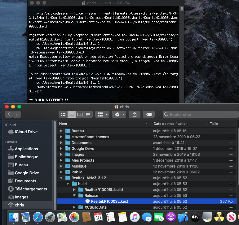

chris1111 Posted December 10, 2019 Share Posted December 10, 2019 7 hours ago, jinbingmao said: Multiple attempts, unable to compile Download source code of Slice here ☞ Source Code ZIP Move the folder RealtekLANv3-3.1.2 in HOME directory type this command in terminal Or Copy and paste the command xcodebuild -project /$HOME/RealtekLANv3-3.1.2/RealtekR1000SL.xcodeproj -alltargets -configuration Release This is the result 1 Link to comment https://www.insanelymac.com/forum/topic/286937-realtekr1000-v3/page/6/#findComment-2700091 Share on other sites More sharing options...

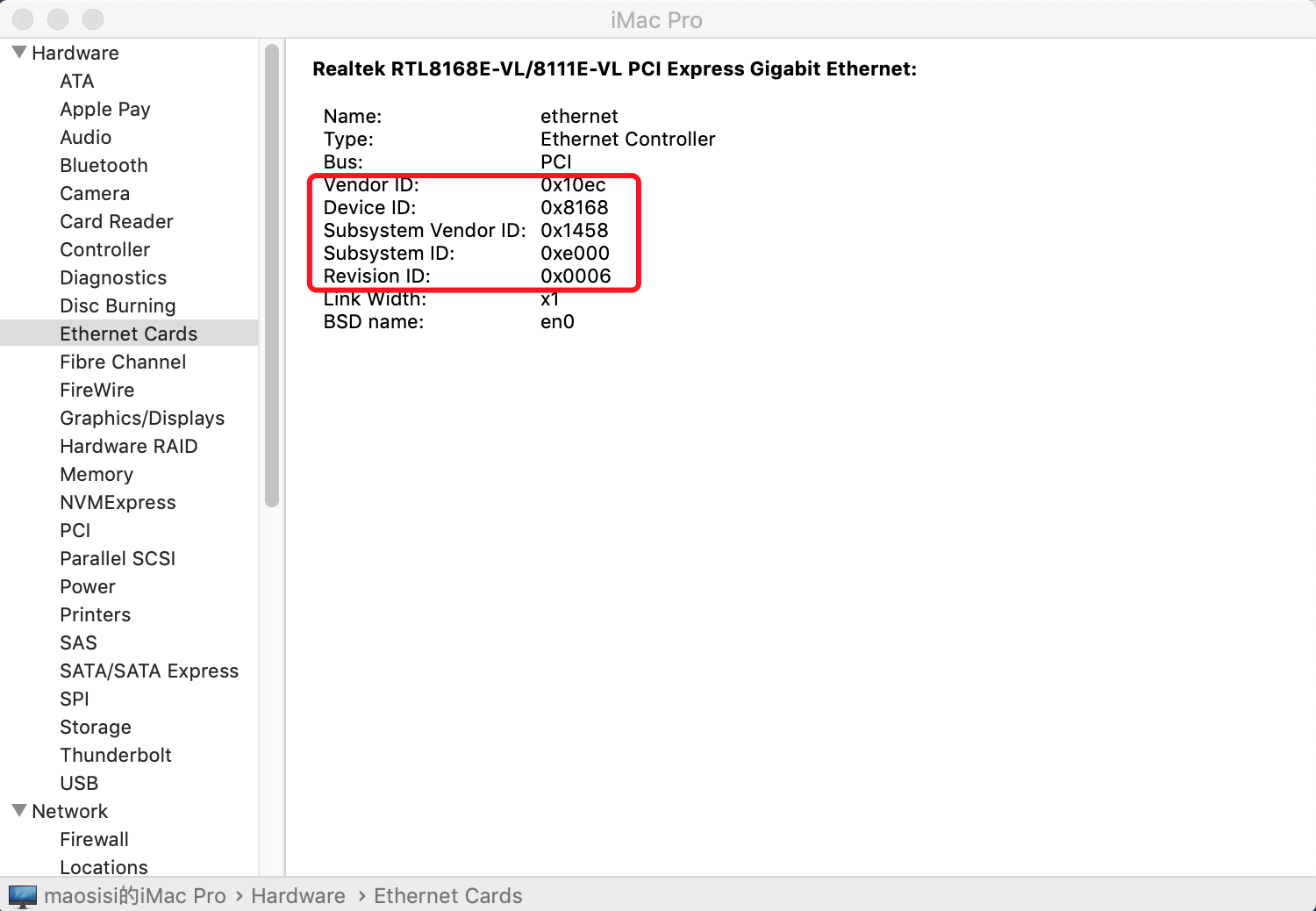

jinbingmao Posted December 10, 2019 Share Posted December 10, 2019 (edited) My real goal is to delete the code that does not belong to the network card. Get a very small driver file. Could you help me? RTL8168E-VL/8111E-VL: (Chipset 16) Edited December 11, 2019 by jinbingmao add Link to comment https://www.insanelymac.com/forum/topic/286937-realtekr1000-v3/page/6/#findComment-2700121 Share on other sites More sharing options...

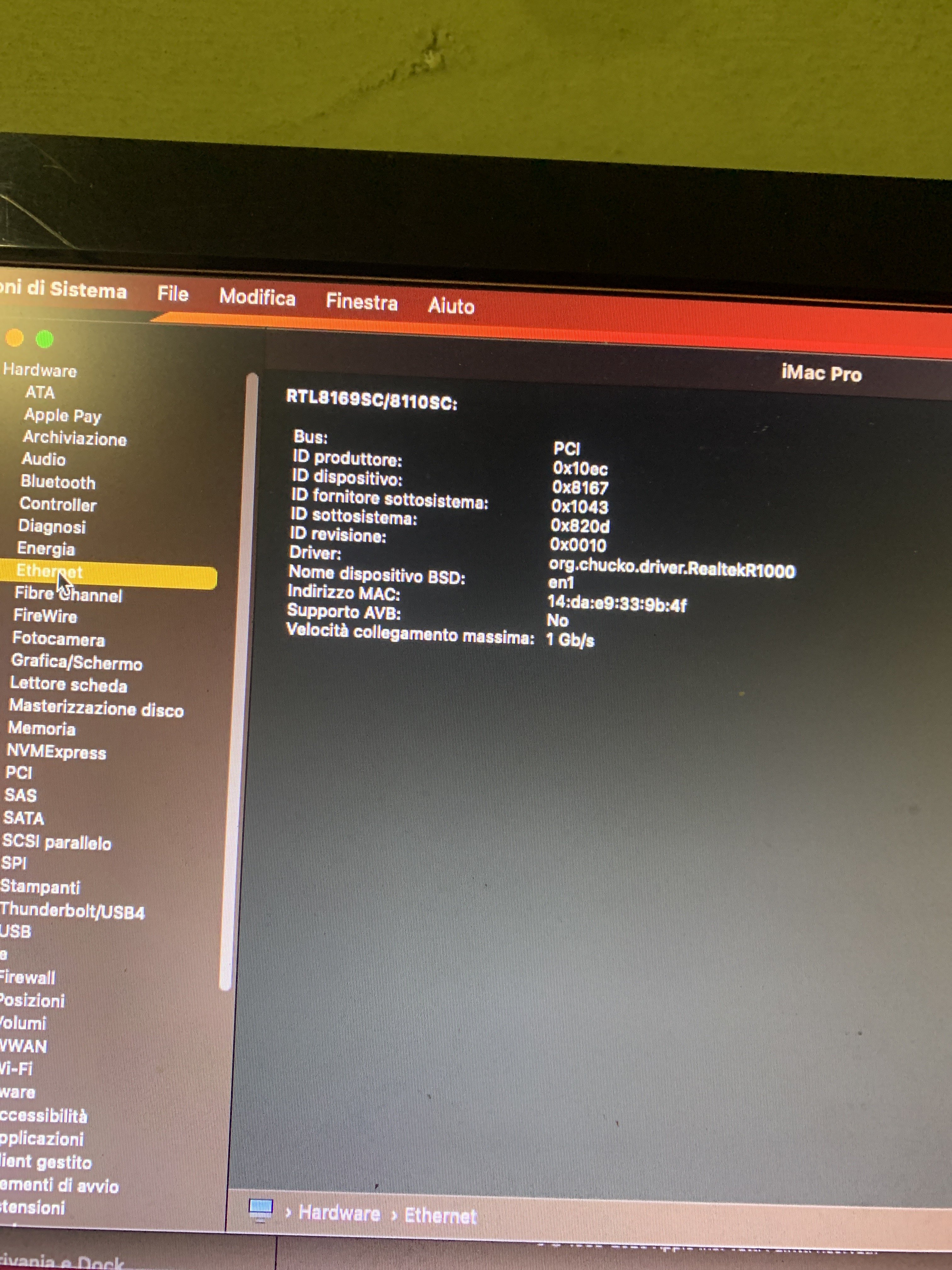

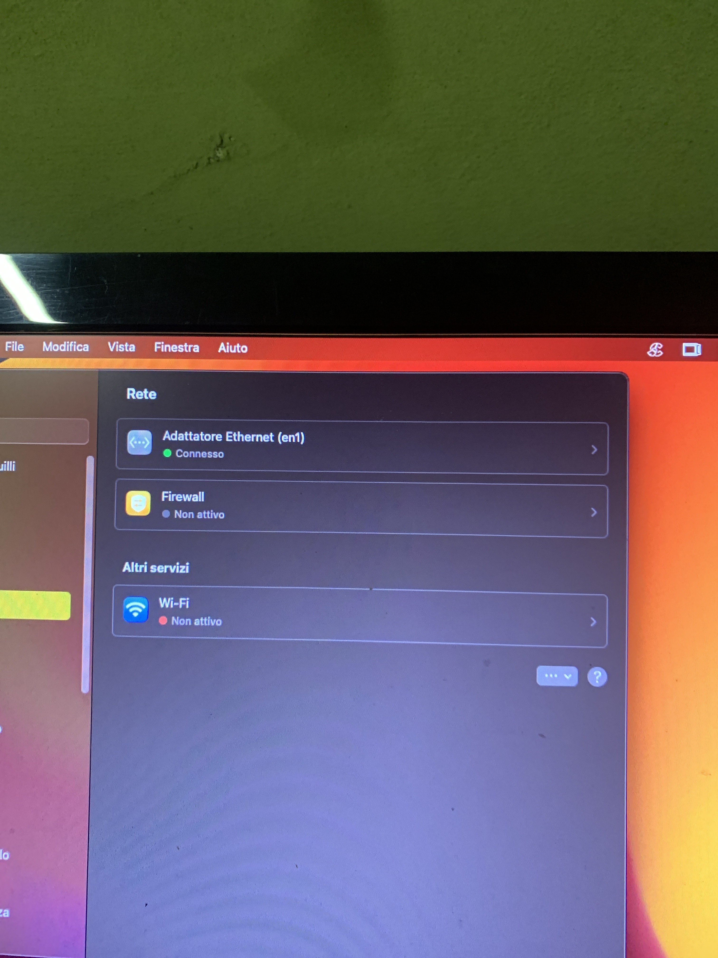

carlo_67 Posted February 17, 2025 Share Posted February 17, 2025 On 12/11/2019 at 12:56 PM, Slice said: What about github release? https://github.com/SergeySlice/RealtekLANv3/releases/download/v3.1.2/RealtekR1000SL.kext.zip Excellent @Slice also works on Ventura and Sonoma for my RTL8110sc by entering its device id 8167 10ec, after monterey the AppleRTL8169Ethernet.kext no longer worked for Ventura and Sonoma we would try it on the 8169, but I think it works, add device id in the kext 8167 10ec and 8169 10ec, it may be useful thanks Link to comment https://www.insanelymac.com/forum/topic/286937-realtekr1000-v3/page/6/#findComment-2830468 Share on other sites More sharing options...
