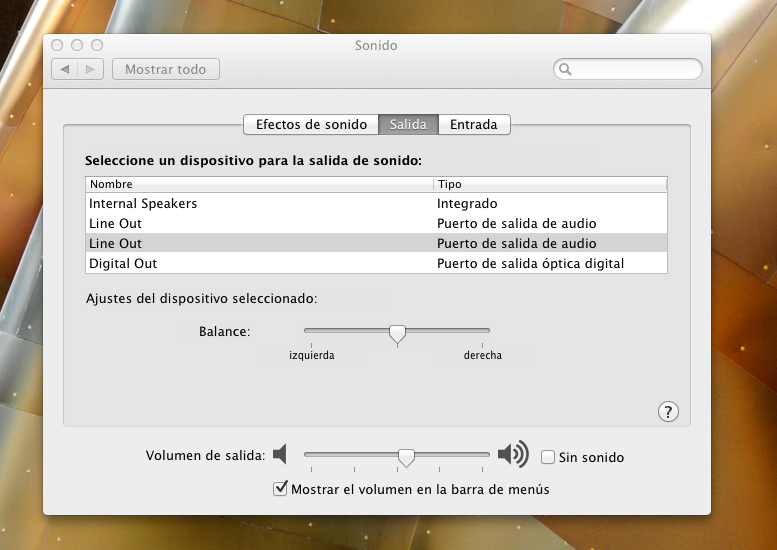

Imagchine27 Posted February 23, 2013 Share Posted February 23, 2013 Hi everbody, At the moment I installed Mac (iatkos L2) and updated it, sound drivers weren't detected (instead of installing drivers with ##### 4.7). So I fix this problem this way: 1) Delete AppleHDA, install VoodoHDA and repair permissions. 2) Restart 3) Install Realtek 898 drivers (appropiate for my motherboard) 4) Restart After restarting, sound drivers were detected but I can't hear anything. Quick Time and iTunes don't plays anything by clicking play (VLC and Youtube works). I have diferent sound outputs (look at the attached picture) in my sound configuration panel and I try everyone of them. I also try to change the mini jac position but with the same result. Does someone knows what's happening? My computer: CPU: Intel Core i7-3820 3.60Ghz Box Socket 2011 Motherboard: Gigabyte GA-X79-UD3 Nvidia GTS 450 My MAC: iAtkos L2 (10.7.5 updated) Quote Link to comment https://www.insanelymac.com/forum/topic/286594-sound-drivers-detected-but-i-cant-hear-anything/ Share on other sites More sharing options...
iFIRE Posted February 23, 2013 Share Posted February 23, 2013 you need HDEF IN your DSDT.aml or this not work Device (HDEF) { Name (_ADR, 0x001B0000) Method (_PRW, 0, NotSerialized) { Return (Package (0x02) { 0x0D, 0x05 }) } Method (_DSM, 4, NotSerialized) { Store (Package (0x04) { "layout-id", Buffer (0x04) { 0x82, 0x03, 0x00, 0x00 }, "PinConfigurations", Buffer (Zero) {} }, Local0) DTGP (Arg0, Arg1, Arg2, Arg3, RefOf (Local0)) Return (Local0) } } Quote Link to comment https://www.insanelymac.com/forum/topic/286594-sound-drivers-detected-but-i-cant-hear-anything/#findComment-1891389 Share on other sites More sharing options...
eep357 Posted February 23, 2013 Share Posted February 23, 2013 you can't do this: 3) Install Realtek 898 drivers (appropiate for my motherboard) and this: 1) install VoodoHDA and repair permissions. if Voodoo, then only Voodoo iFire method with Voodoo deleted is best Quote Link to comment https://www.insanelymac.com/forum/topic/286594-sound-drivers-detected-but-i-cant-hear-anything/#findComment-1891395 Share on other sites More sharing options...
Rampage Dev Posted February 24, 2013 Share Posted February 24, 2013 Hi everbody, At the moment I installed Mac (iatkos L2) and updated it, sound drivers weren't detected (instead of installing drivers with ##### 4.7). So I fix this problem this way: 1) Delete AppleHDA, install VoodoHDA and repair permissions. 2) Restart 3) Install Realtek 898 drivers (appropiate for my motherboard) 4) Restart After restarting, sound drivers were detected but I can't hear anything. Quick Time and iTunes don't plays anything by clicking play (VLC and Youtube works). I have diferent sound outputs (look at the attached picture) in my sound configuration panel and I try everyone of them. I also try to change the mini jac position but with the same result. Does someone knows what's happening? My computer: CPU: Intel Core i7-3820 3.60Ghz Box Socket 2011 Motherboard: Gigabyte GA-X79-UD3 Nvidia GTS 450 My MAC: iAtkos L2 (10.7.5 updated) Voodoo will not work. I support all x79 systems via my blog: http://rampagedev.wordpress.com/dsdt-downloads/gigabyte-x79/ Please do a retail install. 1 Quote Link to comment https://www.insanelymac.com/forum/topic/286594-sound-drivers-detected-but-i-cant-hear-anything/#findComment-1891582 Share on other sites More sharing options...

ignage Posted March 11, 2013 Share Posted March 11, 2013 I have added HDEF by following the instructions but not working. Outputs appears in output option but can't hear anything. The only difference is that iTunes plays song now. If I delete VoodoHDA.kext output disappear. Quote Link to comment https://www.insanelymac.com/forum/topic/286594-sound-drivers-detected-but-i-cant-hear-anything/#findComment-1895797 Share on other sites More sharing options...
