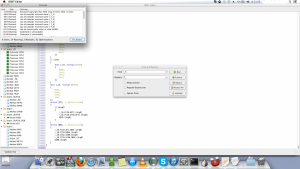

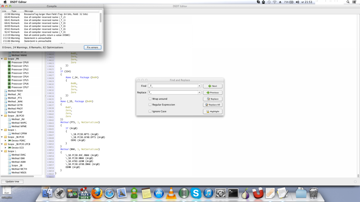

WaldMeister Posted February 8, 2013 Share Posted February 8, 2013 http://www.insanelym...or-and-patcher/ Download the utility and open your DSDT with it. Now click IASL, if you are lucky (which you are not ) the dsdt wil compile. In your case i get: see attachment. This means you need to fix the errors and warnings. Some i know how to fix, others i just type in google. (Working on it right now, so you don't need to, but you can learn something from it) When the errors and warnings are gone, you can start applying patches. The most common come with the utility, click on patch, open, and navigate to the DSDT folder, there is a folder with patches you can apply, i don't know which ones you need, still have to look in too it After you have applied the patches, you click compile, if an error comes up, fix it, by clicking on the error, the program will go to that line. If it compiles, put the DSDT.aml in /Extra folder. (An error can always occur, also a not bootable system.) Edit: The screen is already without errors You had 3 of them, click on fix errors and they will be gone. Edit 2: Did not read correctly, a DSDT file makes it possible to get your installation as vanilla as possible, it will inject information into OSX to load genuine Apple drivers, instead of replacements downloaded from the web. Think of speedstep, sleep, audio, video, ethernet, etc.. Link to comment https://www.insanelymac.com/forum/topic/286196-asus-a56cm-k56cm-tutorial-ml-1082/page/2/#findComment-1887155 Share on other sites More sharing options...
Piuma Posted February 8, 2013 Author Share Posted February 8, 2013 Ok, I do not speak English very well and do a little 'hard to understand everything. Do you think I can try to prepare the dsdt file or is it better if I leave it to you? Link to comment https://www.insanelymac.com/forum/topic/286196-asus-a56cm-k56cm-tutorial-ml-1082/page/2/#findComment-1887160 Share on other sites More sharing options...
WaldMeister Posted February 8, 2013 Share Posted February 8, 2013 You can do it, but i did it already In the attachment, i included the fixed DSDT, and the applied patches. I left out the audio patch, and some unneeded ones. Still have to look at the html file you have attached. Archief.zip Link to comment https://www.insanelymac.com/forum/topic/286196-asus-a56cm-k56cm-tutorial-ml-1082/page/2/#findComment-1887162 Share on other sites More sharing options...
