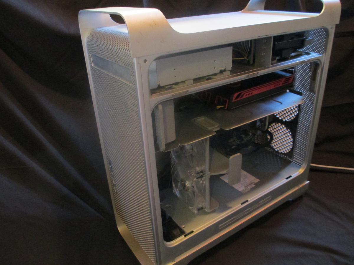

v3nom Posted January 5, 2013 Share Posted January 5, 2013 In the front you can install two 120mm or two 140mm fans. I installed two 120mm fans because you can easily get metal frames for that: Link to comment https://www.insanelymac.com/forum/topic/285456-powermac-g5-fans/#findComment-1878227 Share on other sites More sharing options...

v3nom Posted January 5, 2013 Share Posted January 5, 2013 Just take them out and measure the width of the fans, thickness doesn't matter. Front fans are 92mm fans, regular standard. Link to comment https://www.insanelymac.com/forum/topic/285456-powermac-g5-fans/#findComment-1878235 Share on other sites More sharing options...

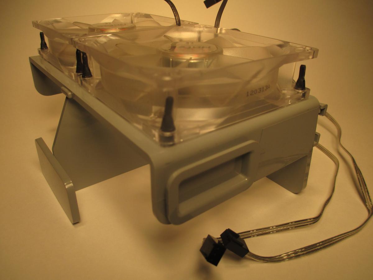

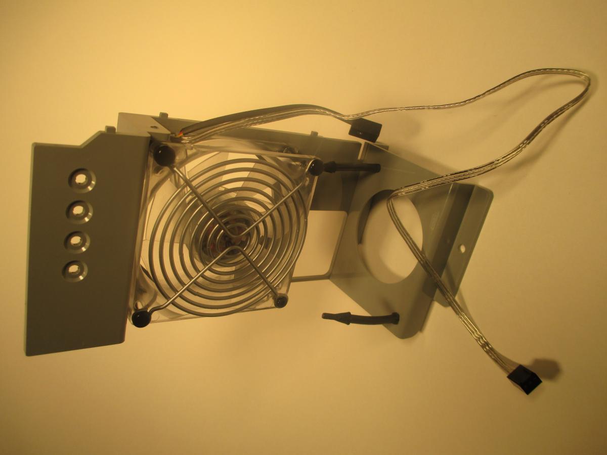

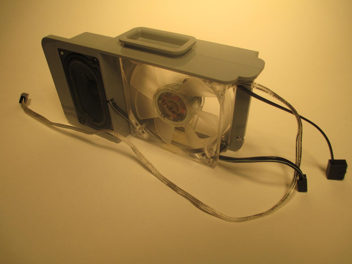

Mr.D. Posted January 6, 2013 Share Posted January 6, 2013 I have done what you are wanting to do - that is to put new fans into the original brackets/holders/odd contraptions that Apple designed to make the original G5 sound like an airplane. If you want to replace all the fans, you'll need 92mm, 80mm and 60mm fans, The 60mm are for the PSU, the 80mm are for the fan on the speaker bracket and one of the fans on the HDD cooler assembly, and the 92mm for the rest. Except the funky blower fan that is the second fan on the HDD cooler assembly, you can buy them all for cheap at newegg or whichever your preferred retailer is. I have yet to find a replacement fan for the blower, but unless you are putting some 10k RPM drives in that space, you wont need more than the one. My HDD temps w/o any fans were only 120 f. I never replaced the back fans in mine, just used the CPU cooler bracket fans, the speaker fans the the PSU fans and I have yet to crack 100 f. When I am running a long CPU intensive process (time shifting a 65 minute audio file for example), my system runs in the low 90s with those 3 system fans and 2 PSU fans. I even turned my GPU fan down to 60% because that temp never cracked 90 f. I have yet to reuse the hotswap connectors, but I have saved them so that I can add that later. Good luck with your mod! Link to comment https://www.insanelymac.com/forum/topic/285456-powermac-g5-fans/#findComment-1878393 Share on other sites More sharing options...
kevinodonnell Posted January 6, 2013 Author Share Posted January 6, 2013 Thanks very much! I'm probably going to reuse the PSU ones as they're pretty much out of site but will be replacing the back two and the front hotswap. May not bother with the speaker one, just leave it sat in there and see how my temps look Link to comment https://www.insanelymac.com/forum/topic/285456-powermac-g5-fans/#findComment-1878458 Share on other sites More sharing options...
