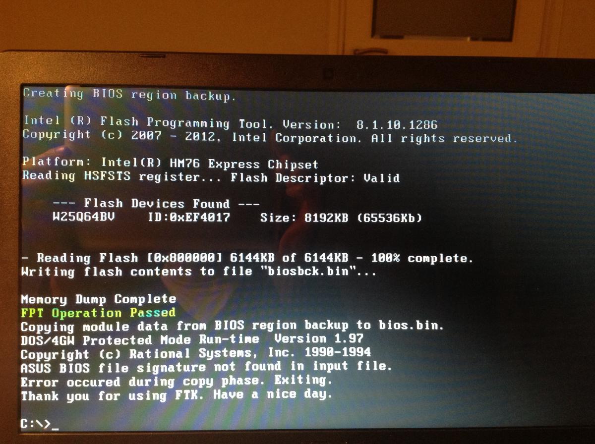

Hello Code Rush,
I'm stuck in the FTK flash process. I use the UEFI BIOS for ASUS X550CA, found here: http://dlcdnet.asus.com/pub/ASUS/nb/X550CA/X550CAAS212.zip
I use PMpatch to patch the BIOS. Used all native Bios -Flash options (WinFlash etc.) but all fialed.
Then I used FTK for Dos, and get the following error.
Any suggestions?
Thanks, Tebogo

FTK is not meant for notebooks. Are you sure that AFU /GAN method doesn't work for you?
Sorry, I didn't realize is was not meant for laptops. I'll try later this day the AFU /GAN method.
I found your article about that: http://www.win-raid.com/t286f16-Guide-Flashing-modified-AMI-Aptio-UEFI-using-AFU.html#msg3571
Or should I follow: http://www.insanelymac.com/forum/topic/285444-pmpatch-uefi-patching-utility/page-39?do=findComment&comment=1951029
Thank you!
