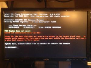

If you see this attachment, you can see the problem I have flashing the BIOS. This is a problem with the version 7 BIOS from Jetway, as the older versions all work fine. This is not a problem to do with the Patch Util, just a coincidence that this v7 BIOS crashes the newest Patch Util but also will not flash onto my motherboard.
I will correct that crash in a new release ASAP. I have no OS X now to compile a new version, and I plan to integrate BIOS unlock code into PMPatch 0.6, so it's just a coincidence.
let's see, if you want you can dump and upload your descriptor region for a review with
