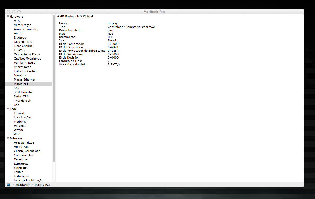

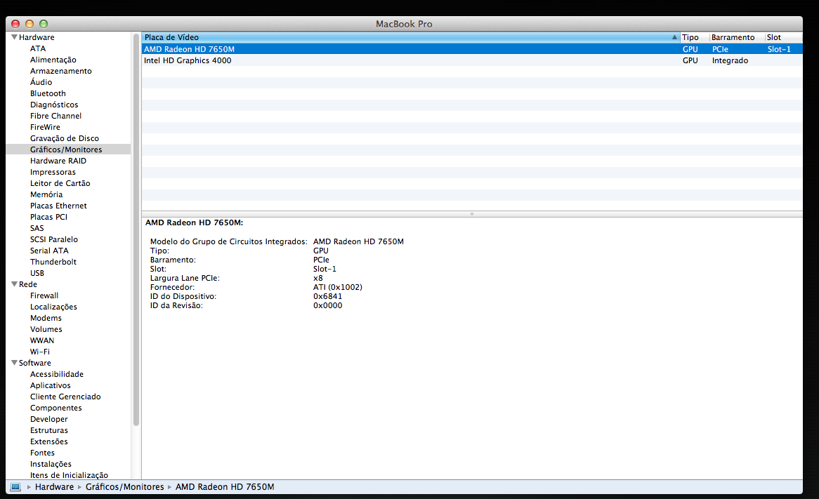

mendietinha Posted December 31, 2012 Share Posted December 31, 2012 doing some progress here! i think cosmetic for now, but ill keep going... all the right kexts load normally. amdacelerator, amd6000controller, amdsuport agpm etc... lets see... edit: inject vram, rom, framebuffer, disable hd4000, make it work together? the agpm recognizes and apears in the -v boot saying about the board, because i change the 6741 of 6630m to 6841 from 7650m. and it loads properly only using smbios mbp 8.2. otherwise says unknown. any help here willl be fantastic. i change dsdt, agpm, boot, aty... Link to comment https://www.insanelymac.com/forum/topic/285353-hd6850m-mountain-lion/#findComment-1876956 Share on other sites More sharing options...

mendietinha Posted January 2, 2013 Share Posted January 2, 2013 mate, did the system recognized vram or something? can u post some screenshots...? cheers Link to comment https://www.insanelymac.com/forum/topic/285353-hd6850m-mountain-lion/#findComment-1877563 Share on other sites More sharing options...
