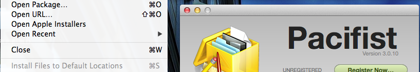

iFIRE Posted February 8, 2013 Share Posted February 8, 2013 me he equivocado, instala esto, instala el pkg pkg for 0x10029552 & 0x10029553 & 0x10029480 boot file. Chameleon_2.1svn_r1820_10.8_Shrike_NB_780_pkg+boot.zip 2.21MB 181 downloads Link to comment Share on other sites More sharing options...

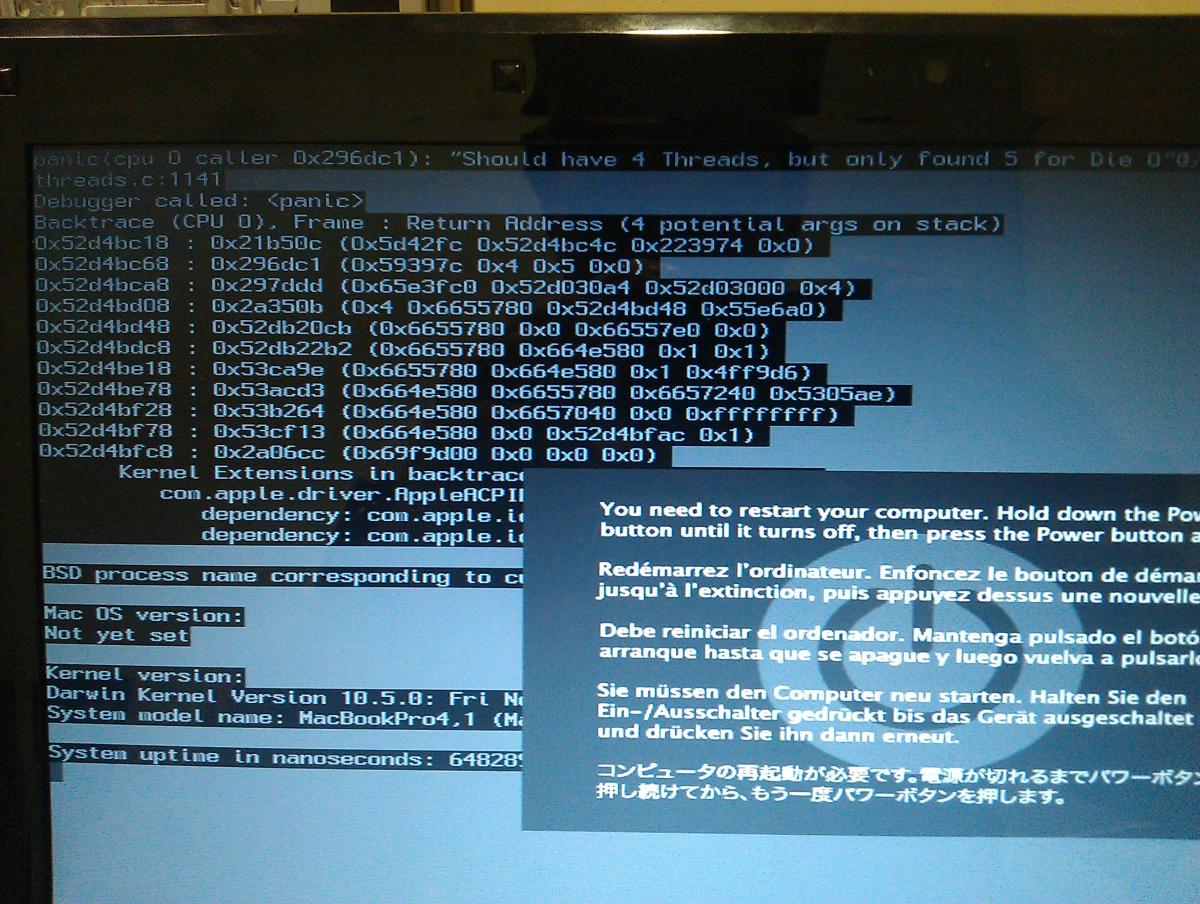

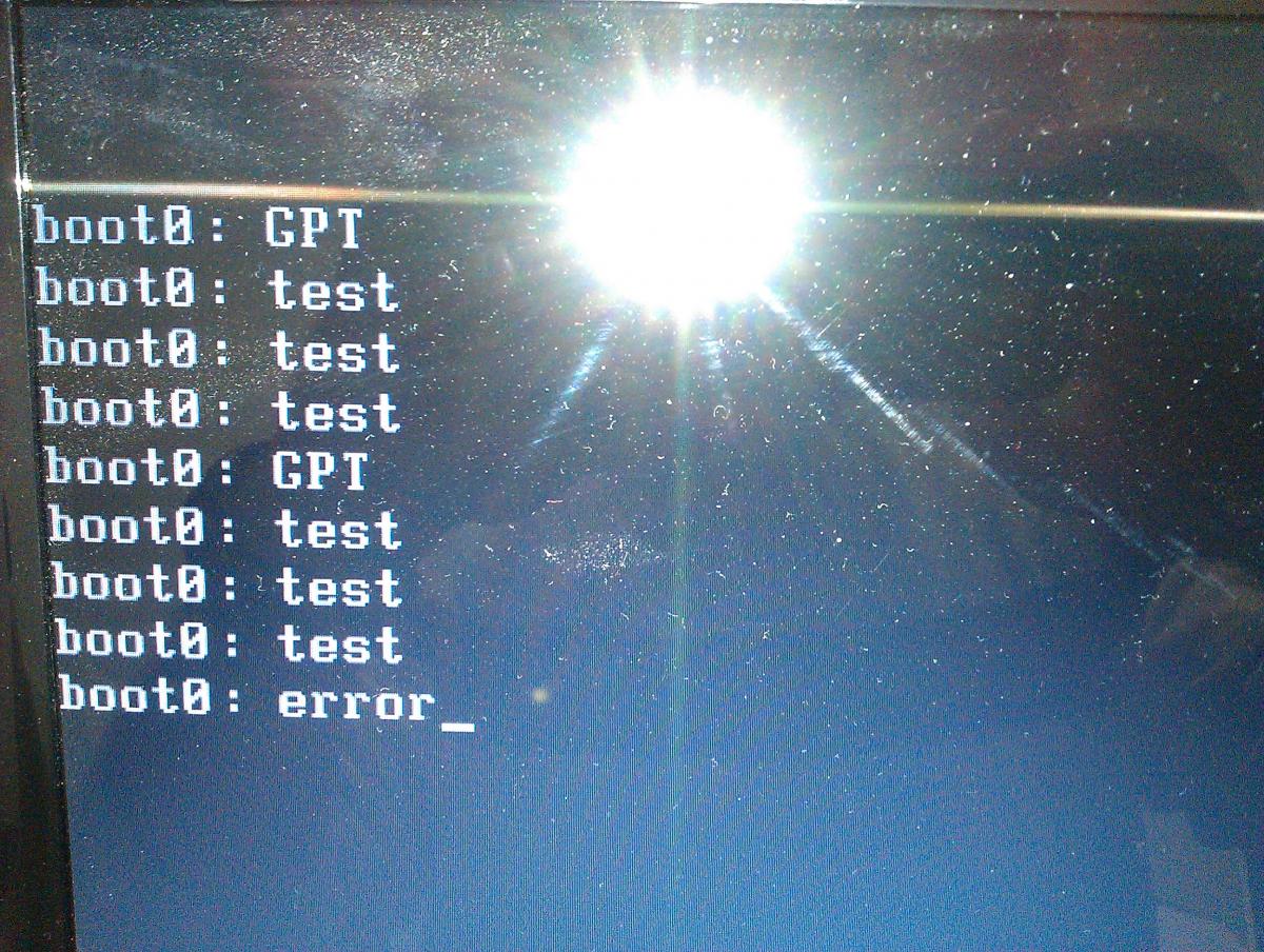

platea Posted February 8, 2013 Author Share Posted February 8, 2013 me he equivocado, instala esto, instala el pkg pkg for 0x10029552 & 0x10029553 & 0x10029480 boot file. Chameleon_2.1svn_r1820_10.8_Shrike_NB_780_pkg+boot.zip 2.21MB 181 downloads He instalado el pkg, copiado la carpeta extra, y reparado permisos. Me aparece la siguiente pantalla. SI arranco con el cd me da lo siguiente: Link to comment Share on other sites More sharing options...

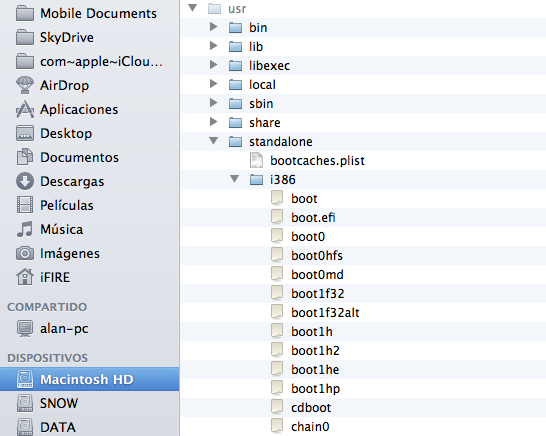

iFIRE Posted February 8, 2013 Share Posted February 8, 2013 boot 0 error: use pacifist para extraer la carpeta i386 del pkg que te he posteado, y porque te sale MacBookPro4,1 ?? si das el boot com el cd te lee el kernel 10.5.0 i no el 10.6.0 ok, this is the second option for install it, download binarios chameleon folder i386 or cp -R /usr/standalone/i386/boot1h 1. open the folder i386 and copy boot1h for your USBInstaller. 2. boot from USBinstaller and go for utilities and open app Terminal 3. type diskutil list for identified your disk and partition were you installed of system ML = "(i.e: disk0s2)" 4. type diskutil unmount disk0s2 5. type cd / 6. type dd if=boot1h of=/dev/disk0s2 bs=4096 7. reboot in steep 6 put your disk and partition "(i.e disk0s2 "), see your Link to comment Share on other sites More sharing options...
platea Posted February 8, 2013 Author Share Posted February 8, 2013 No consigo entrar de ninguna forma, -s -f ni -x ni nada Tengo montado el disco en windows, con el macdrive. Link to comment Share on other sites More sharing options...

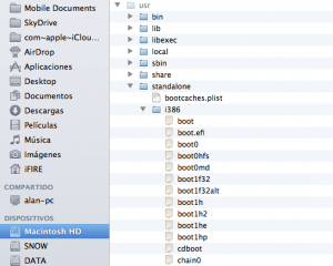

iFIRE Posted February 8, 2013 Share Posted February 8, 2013 desde window busca en la raiz del disco una carpeta llamada usr mire la foto, copia boot1h para un usbinstaller y sigues el del post arriba. Link to comment Share on other sites More sharing options...

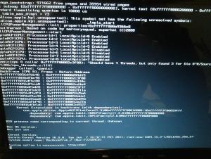

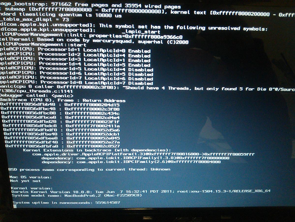

platea Posted February 11, 2013 Author Share Posted February 11, 2013 aiiiiiiii!!!! copia both1h para tu USBInstaller ML, boot tu USBML, hace de cuenta que vas instalar, quando llegues en la parte de elegir el disco vai arriba en Utilities abres la terminal y hace lo del poste de arriba. He realizado el proceso y arranca perfectamente, pero se queda parado, como se puede ver en la siguiente imagen. Link to comment Share on other sites More sharing options...
iFIRE Posted February 11, 2013 Share Posted February 11, 2013 Edit: la version esta correcta, prueba este legacy 10.6.8 Legacy Kernel 10.8 V2 Link to comment Share on other sites More sharing options...
iFIRE Posted February 11, 2013 Share Posted February 11, 2013 Que dices, hombre si ya tienes el sistema instalado desde win cambia el kernel o ponga en tusb y copias via terminal para o sistema Link to comment Share on other sites More sharing options...
