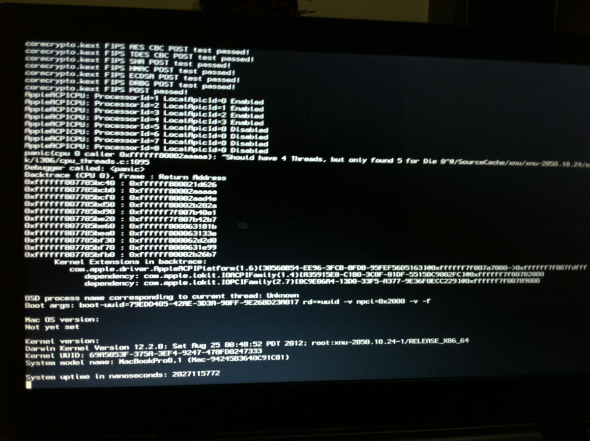

pedrokareka Posted January 21, 2013 Author Share Posted January 21, 2013 Aparentemente tudo igual.. aparece o mesmo erro... Link to comment https://www.insanelymac.com/forum/topic/284878-acer-aspire-timeline-ultra-m3/page/2/#findComment-1882430 Share on other sites More sharing options...
artur_pt Posted January 21, 2013 Share Posted January 21, 2013 olá tás a ter problemas com appleacpiplatform.kext e iopcifamilly, fizeste algum update ? se fizeste se calhar tens de usar as kext da versão anterior... http://www.insanelymac.com/forum/topic/282930-1082-final-c54/ bom hack Link to comment https://www.insanelymac.com/forum/topic/284878-acer-aspire-timeline-ultra-m3/page/2/#findComment-1882469 Share on other sites More sharing options...

pedrokareka Posted January 21, 2013 Author Share Posted January 21, 2013 Tudo igual.. fiz o rollback da appleacpiplatform.kext , ioacpifamily.kext e iopcifamily.kext do 10.8.0 e continuo na mesma... mais alguma ideia? o que pode estar a causar isto? Link to comment https://www.insanelymac.com/forum/topic/284878-acer-aspire-timeline-ultra-m3/page/2/#findComment-1882661 Share on other sites More sharing options...
artur_pt Posted January 21, 2013 Share Posted January 21, 2013 olá faz boot normal sem -x -f -v npci=0x2000 e posta nova foto bom hack Link to comment https://www.insanelymac.com/forum/topic/284878-acer-aspire-timeline-ultra-m3/page/2/#findComment-1882665 Share on other sites More sharing options...
pedrokareka Posted January 21, 2013 Author Share Posted January 21, 2013 Tudo igual =/ Link to comment https://www.insanelymac.com/forum/topic/284878-acer-aspire-timeline-ultra-m3/page/2/#findComment-1882674 Share on other sites More sharing options...

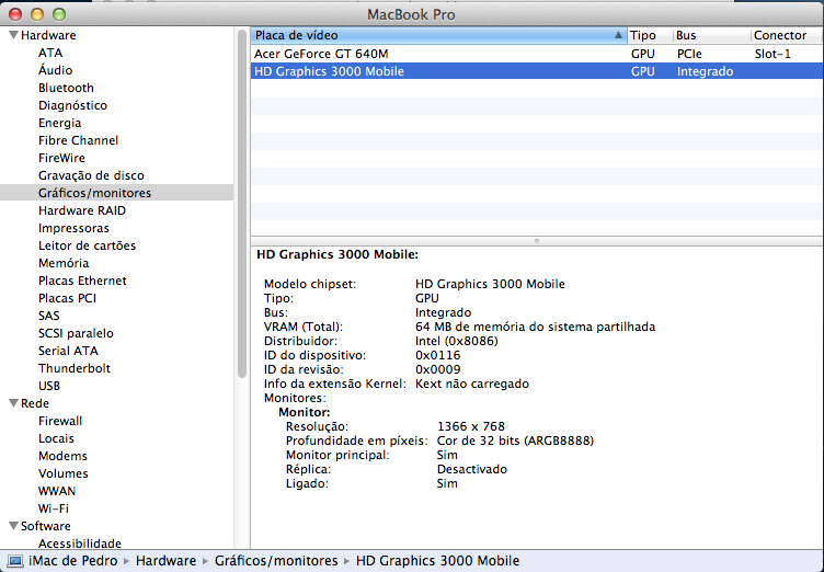

pedrokareka Posted January 27, 2013 Author Share Posted January 27, 2013 Nao consigo meter a aceleraçao a funcionar... Nao estou a perceber o porque. Ja tenho 1366x768 atraves do boot graphicsmode=1366x768x32 mas a kext nao esta a ser carregada : O que estará errado? Link to comment https://www.insanelymac.com/forum/topic/284878-acer-aspire-timeline-ultra-m3/page/2/#findComment-1884070 Share on other sites More sharing options...
artur_pt Posted January 27, 2013 Share Posted January 27, 2013 olá tenta este dsdt com dual link DSDT.aml.zip bom hack Link to comment https://www.insanelymac.com/forum/topic/284878-acer-aspire-timeline-ultra-m3/page/2/#findComment-1884074 Share on other sites More sharing options...
pedrokareka Posted January 27, 2013 Author Share Posted January 27, 2013 Pensei que so seria necessario caso tivesse resoluçao superior a 1366x768 , por isso tinha excluido logo essa hipotese.. vou ja experimentar. Link to comment https://www.insanelymac.com/forum/topic/284878-acer-aspire-timeline-ultra-m3/page/2/#findComment-1884086 Share on other sites More sharing options...
pedrokareka Posted January 27, 2013 Author Share Posted January 27, 2013 Continua igual.. =/ Link to comment https://www.insanelymac.com/forum/topic/284878-acer-aspire-timeline-ultra-m3/page/2/#findComment-1884099 Share on other sites More sharing options...
artur_pt Posted January 27, 2013 Share Posted January 27, 2013 olá tenta esta kext AppleIntelSNBGraphicsFB.kext.zip sem + grandes ideias bom hack Link to comment https://www.insanelymac.com/forum/topic/284878-acer-aspire-timeline-ultra-m3/page/2/#findComment-1884107 Share on other sites More sharing options...
pedrokareka Posted January 31, 2013 Author Share Posted January 31, 2013 Boas .. Ja tenho algo a funcionar =) 1 - Para conseguir alguma coisa inicialmente tive de remover a AppleIntelFramebufferCapri.kext . Neste ponto já conseguia ver as resoluçoes disponíveis mas nao tinha aceleraçao A grafica ja era reconhecida e a kext carregada 2 - Apos alguma pesquisa encontrei algo sobre alterar a key AppleIntelMEIDriver da AppleIntelFramebufferCapri e AppleIntelSNBfb : AIFCapri - 0x1E3A8086 passou para 0x1C3A8086 AISNBfb - 0x1C3A8086 passou para 0x1E3A8086 Reconhece a grafica e tem aceleração , embora com muito lag, computador lento, reprodução de vídeos muito lenta, launchpad crasha se todo. A grafica é reconhecida como 384Mb pelo que li so se com 8Gb ram é que passaria para 512. Apenas tenho 4. Com a dsdt com dual link ficava com o écran dividido em 4... É normal ficar lento? Alguem com esta grafica que possa testemunhar? Link to comment https://www.insanelymac.com/forum/topic/284878-acer-aspire-timeline-ultra-m3/page/2/#findComment-1884983 Share on other sites More sharing options...
