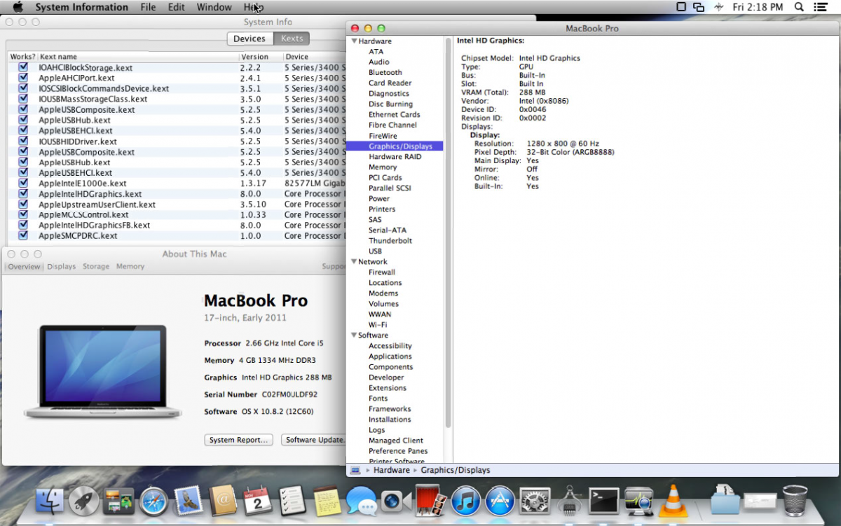

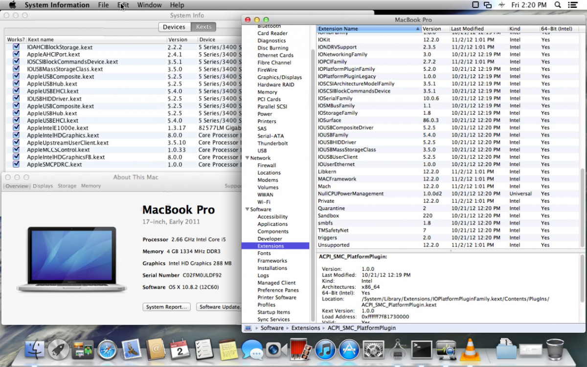

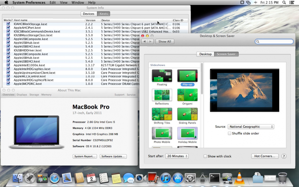

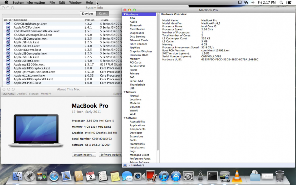

Hi, All,

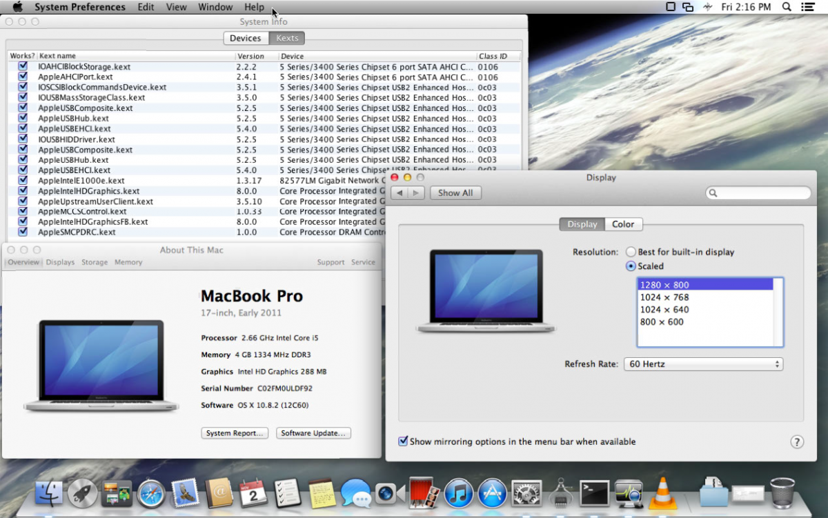

Just showing the processes on Lenovo X201 Mountain Lion screen.Still thinking how this happening and hope that there something can be shared on this.
The OS Version is Mountain Lion 10.8.2.Screen Saving and VCL can working, so the QE/CI shall be wokring already.
The issue for the moment is when loading AppleIntelHDGraphicsFB.kext,laptop internal display become black.
It can only access my system via vnc/remote desktop sharing.Thanks all for those sharing/working on osx86.

Thanks for all the help and advice. My X201 get working internal screen with QE/CI now.
It can work on Niresh12495 Mountain Lion and iATKOS Mountain Lion (10.8.2 and 10.8.3).

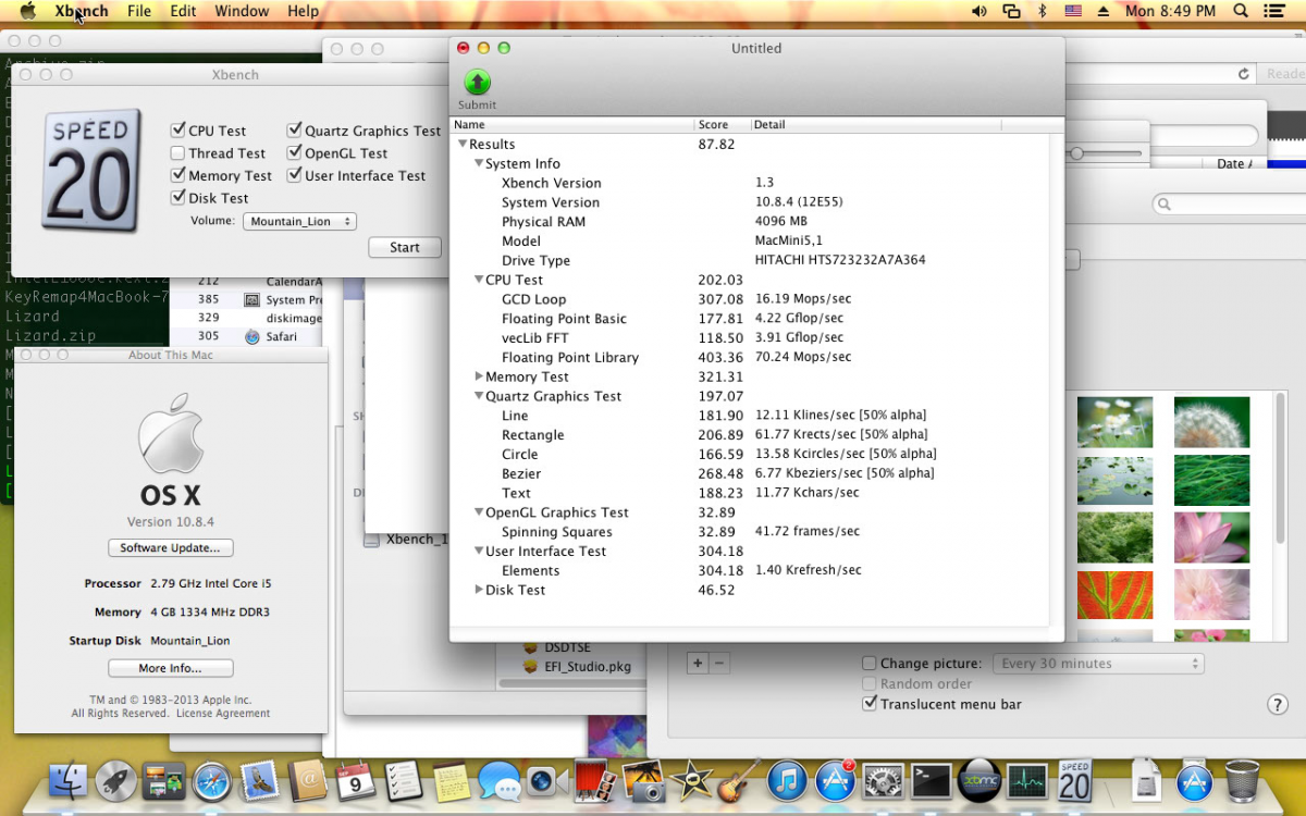

I can see that the screensavers are working. (Core Image might be working) Can you run iMovie or DVD Player without any error? If you can then Quartz Extreme is working.
You might have something here. :smoke:
We might never be able to get custom resolution, however if we can use VNC and use applications that require Quartz Extreme, then this is a excellent workaround.
Share this post
Link to post

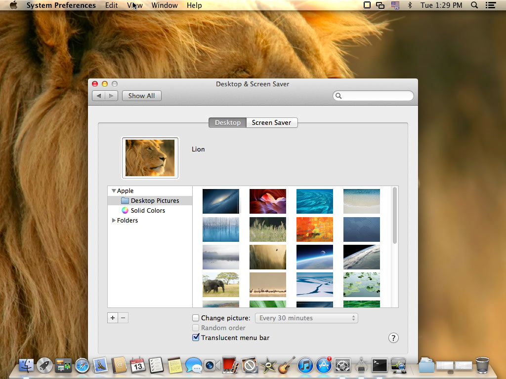

You do not have qe/ci
Your bar at the top is not translucent. It should be, if you have qe/ci, or run Chess. If it opens and is working smoothly with no artifacts, you have QE/CI.
Also, try adding the dual link aapl DSDT patch, and load AppleIntelHDGraphicsFB.kext again, see if that fixes blackscreen.
Share this post
Link to post
I have double check and found that my menu bar can be translucent. So the QE/CI shall be enabled.

Hi guys!
I installed Mountain Lion (10.8.0) again on my HP G62 after months without any OS X installed :)
I finally have the native resolution and i'm very happy about this.
So, i saw and read this topic and i tried to install alexanita's kexts.
That's the result:
Apart the "four screen in one" thing, the QE/CI is fully working! And these are the evidences:
1. In System Profiler -> Graphics it says "Intel HD Graphics" with 288MB of VRAM (the card is finally recognized)
2. A screenshot:
Small note: the "Monitor" is my dedicated card: an ATI HD 5470M (i'm sure that when we fix the Intel HD Graphics problem i can switch from one to another one with gfxCardStatus app)
I tried also to inject my EDID but when i boot Mountain Lion with the kexts i can see that under "Displays" there's wrote: "No display connected" but on the ioreg obtained in this situation i can see the EDID values (of my screen)!
So, finally QE/CI works on our laptops but we need a fix like the old X3100: link. (Maybe a DSDT Patch?!).
Meanwhile, i'm trying to solve the problem myself.

giofrida, can you give more details as to how you got that screen, or even take control of your computer?
Yes, sure.
I just patched my DSDT with his patch (os-info and DualLink) and now i'm using the original kexts. I'm controlling the screen through the "four screen in one". I think all is related to the os-info value because without it i had got the same screen, but i could see nothing! Only white stripes (full white). I also tried some other patches for the DSDT:
- AAPL,Height
- AAPL,Width
- AAPL,HasLid
- AAPL,NumDisplays
- AAPL,HasPanel
...Nothing changed
So we need to ask to an expert or to alexarila how do we obtain the os-info value!
EDIT: Sleep is working, but i cannot wake up the screen (solvable by DSDT). The brightness not (i have PNLF device in my DSDT).
C'mon guys! Let's fix this card!
