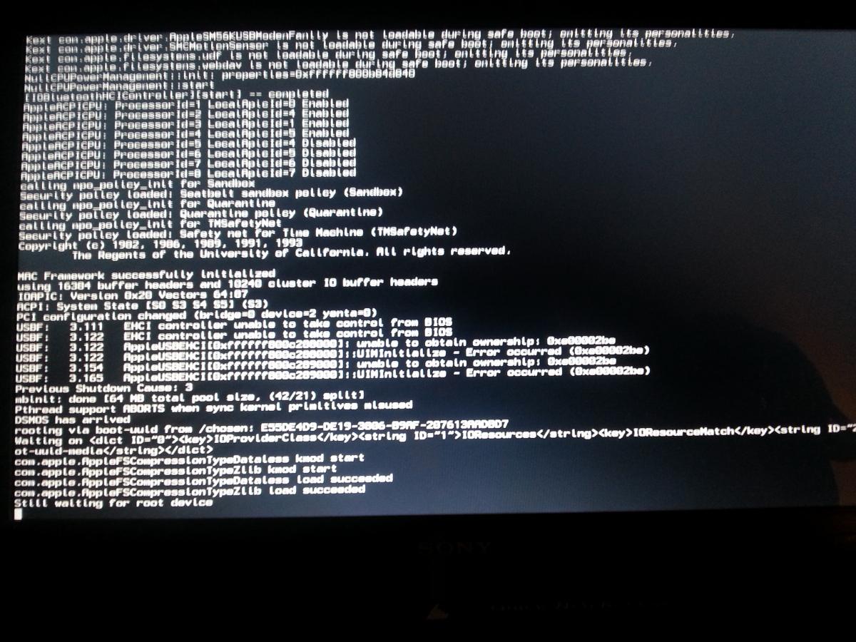

still waiting fo root device on sony vaio VPCEA16FA
7 posts in this topic
Hi all ,
i have a sony viao vpcea16fa and tried to install ML with ###### but no luck. First i had the problem of hanging on pci configuration begin . i resolved it, by changing the iopci...kext but now i have the error wiating for root device and tried many ways of flags but no possibility to take off that error icon_cry.gif.My configuration :

Instal to S/L/E
boot with -f
:D
hope it will fix all those related stuffs

try rolling back USB kext, assuming your using thumb drive. USB errors. Can make small sata partition for installer instead as possible work around too.
Share this post
Link to post
hello
try to use in chameleon
usbbusfix=yes if don't work try EHCIacquirefix=yes
u need in dsdt when u install the OS
patch EHCIownership
good hack
