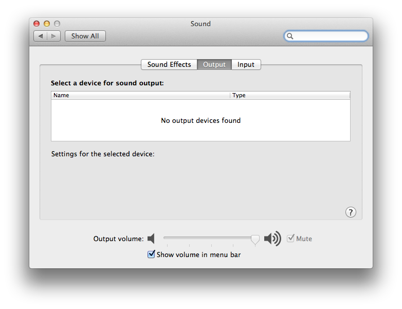

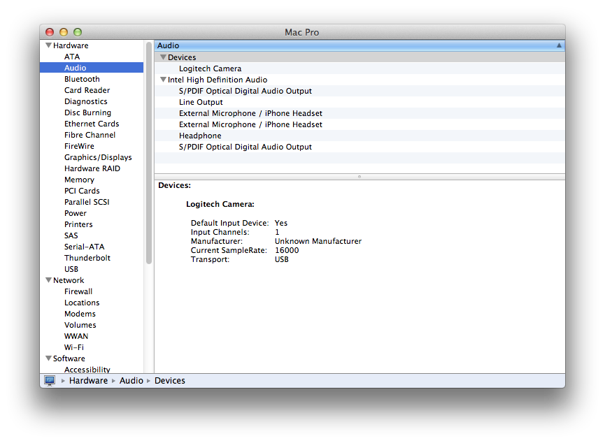

I had audio working with custom DSDT and a patched AppleHDA.kext.
Then I tested VoodooHDA 2.7.4, it worked great. But I wanted to go back to the original setup.
Now the problem is that I don't get any output. (See screens)
What can be wrong? What else did I forget?
Thanks, and hope someone can help, :)
Fixed, see last post. :)

problaby u layout id in u dsdt
in hdef section
must applehda for ML only works with layout id 1
good hack
Ok thanks, will try to generate a new DSDT.
Yes, I'm stupid..
Was using an old patch for Lion, using layout 1 fixes the problem.. thanks! :)
