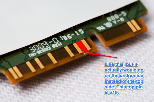

mac.hp.pc Posted October 12, 2012 Author Share Posted October 12, 2012 What about the 20 pin method? I still don't get how i could tape the wifi card. Link to comment https://www.insanelymac.com/forum/topic/283421-the-volume-control-and-wifi-card-is-not-working/#findComment-1860097 Share on other sites More sharing options...
eep357 Posted October 12, 2012 Share Posted October 12, 2012 i think you use a very tiny piece of tape to cover up the 20th pin on the card where it plugs into the mother board, so that that pin does not make a connection to the mother board socket's pin. Never done it or looked into how to do, just my assumption based on the couple references I've heard made to 20 pin method. Link to comment https://www.insanelymac.com/forum/topic/283421-the-volume-control-and-wifi-card-is-not-working/#findComment-1860106 Share on other sites More sharing options...

pokenguyen Posted October 15, 2012 Share Posted October 15, 2012 I can't get this card working. Try many kexts and nothing works. I edited Info.plist files to make Broadcom43224 kext loading instead of Broacom4311, but I don't see any wireless device. What I've done so far is adding some cosmetic fixes to DSDT to show info on System Info. Now I'm using a USB Wifi Adapter, but I still prefer internal card. I'm going to try tapping 20 pin, pray for me . It seems very simple, just take out the card, cut a small tap and use it to cover the 20th pin on card, so that it can't connect to laptop. P/S: My laptop is on signature. Link to comment https://www.insanelymac.com/forum/topic/283421-the-volume-control-and-wifi-card-is-not-working/#findComment-1860699 Share on other sites More sharing options...

pokenguyen Posted October 17, 2012 Share Posted October 17, 2012 Bad luck the audio do not work with any voodoo.kext or http://www.osx86.net...audio_kext.html after that update to 10.7.5 os x and that file cause a kernel panic. I cover the whole 20 pin of my wifi card and it did not work. 20th pin or 20pins??? You can test if your tap is good or not by booting to Windows, press the wifi button. If you cover it well, wifi won't turn off. Link to comment https://www.insanelymac.com/forum/topic/283421-the-volume-control-and-wifi-card-is-not-working/#findComment-1861074 Share on other sites More sharing options...
eep357 Posted October 17, 2012 Share Posted October 17, 2012 Like in the picture, but actually to the underneath side of the card, each side of the card are different pins and I didn't feel like looking for another picture. So here's the pin out diagram so you can see exactly what every pin # is Link to comment https://www.insanelymac.com/forum/topic/283421-the-volume-control-and-wifi-card-is-not-working/#findComment-1861145 Share on other sites More sharing options...
mac.hp.pc Posted October 18, 2012 Author Share Posted October 18, 2012 I have tape the 20th pin and it is still not working.I tried the airport but it can not detect the wifi card. I found the kext that cause the kernel panic for the audio file. It is OSvKernDSPLib.kext Link to comment https://www.insanelymac.com/forum/topic/283421-the-volume-control-and-wifi-card-is-not-working/#findComment-1861403 Share on other sites More sharing options...
