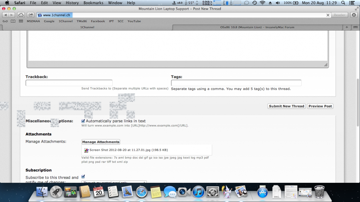

X-TRiAL Posted August 21, 2012 Share Posted August 21, 2012 i have native QE/CI with the same HD3000 (0x0126) on ML, what the difference btw your kexts and the vanilla one ? I would like to know this too, however sometimes I get a graphics glitch (see picture) Link to comment https://www.insanelymac.com/forum/topic/282045-hd3000-full-acceleration-for-108/#findComment-1845973 Share on other sites More sharing options...

marsuss Posted August 27, 2012 Author Share Posted August 27, 2012 however sometimes I get a graphics glitch (see picture) Install latest chameleon 2050 Link to comment https://www.insanelymac.com/forum/topic/282045-hd3000-full-acceleration-for-108/#findComment-1848278 Share on other sites More sharing options...

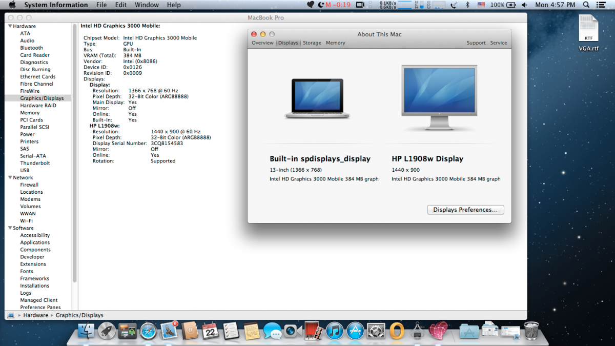

Biso007 Posted September 28, 2012 Share Posted September 28, 2012 Hi, does it support dual monitors ? I have native resolution but it doesn't recognize the external monitor. Edit: Yes it does Link to comment https://www.insanelymac.com/forum/topic/282045-hd3000-full-acceleration-for-108/#findComment-1856509 Share on other sites More sharing options...

Biso007 Posted October 18, 2012 Share Posted October 18, 2012 I finally restored the QE/CI on my laptop ... I patched the stock 10.8.2 AppleIntelSNBGraphicsFB kext to enable the VGA output on port 602 (credit to bcc9). Now I have both displays working with QE/CI. I attached the patched kext in case you give it a try. AppleIntelSNBGraphicsFB.kext.zip 2 Link to comment https://www.insanelymac.com/forum/topic/282045-hd3000-full-acceleration-for-108/#findComment-1861364 Share on other sites More sharing options...
