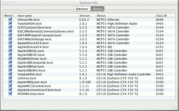

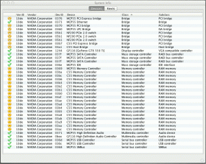

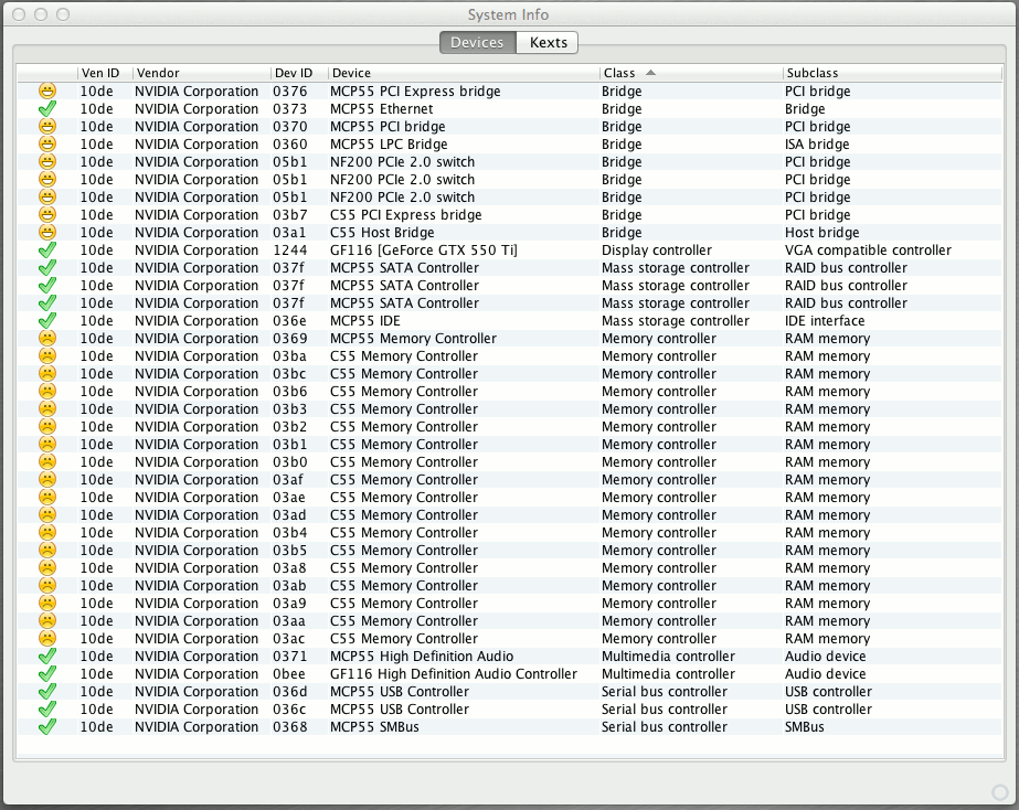

Check here for solving VoodooHDA related kernel panics as a starting point........however, Safari and/or Flash (if installed) may be the problem, so try another browser.........or Spotlight Indexing, so disable it to see.......or a memory issue, so see if using maxmem=3456 as a boot flag increases your MOBO stability........see the discussion between myself and Nick Savage starting here......
post-1160550-0-75551200-1370482354_thumb.gifpost-1160550-0-15555900-1370482356_thumb.gif
Seems to be happening more and more often now. Haven't had time to troubleshoot yet but I posted a couple screenshots of SystemInfo if that's of any use. Seems to happen most often during file operations. Especially doing 'Get Info'. Will try suggestions later when I get time. Oh and I don't use Safari at all, only Firefox.

It is most likely a memory / CPU interaction issue since as you say "Seems to happen most often during file operations."...... so try maxmem=3456 as a boot flag first.......
